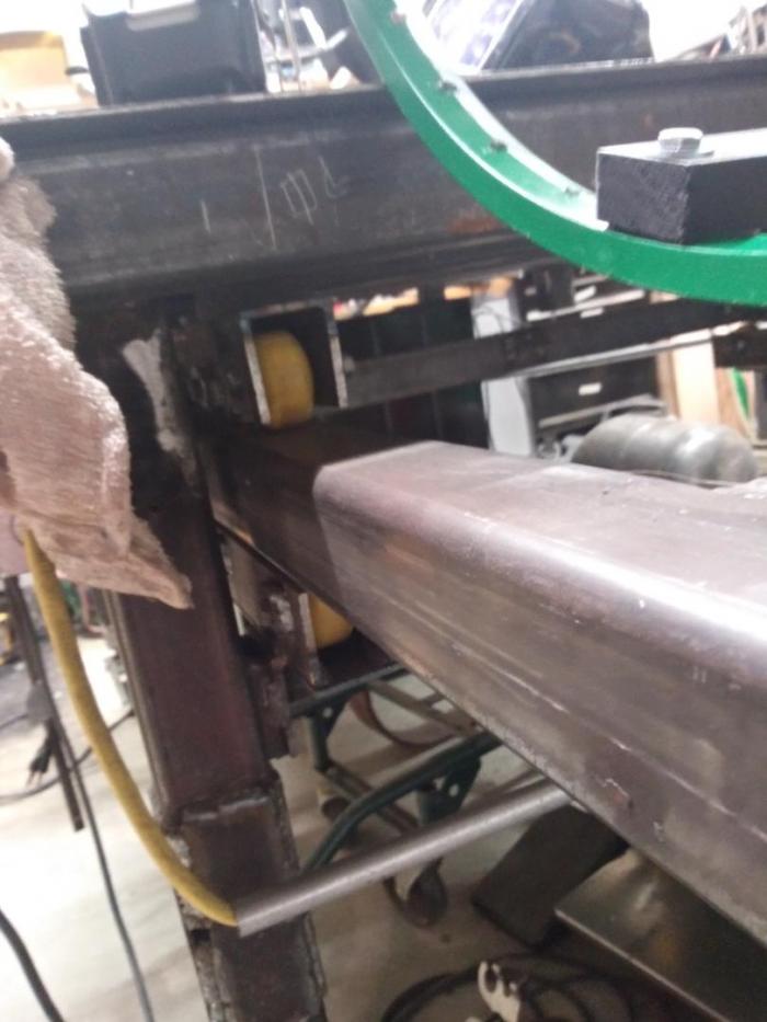

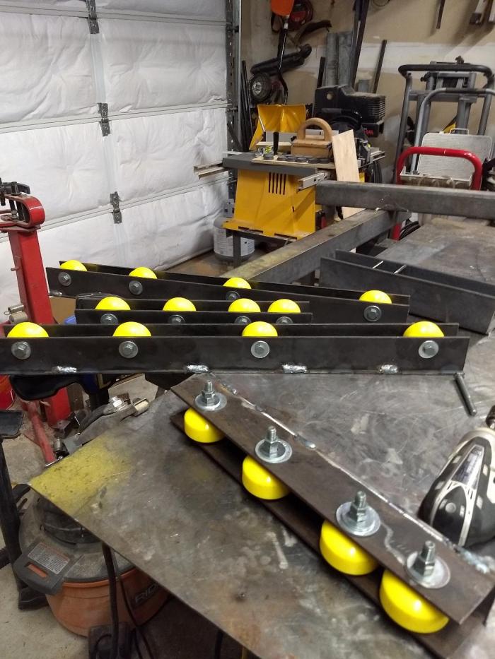

In addition to that I have an extension on the table that may be of interest to some. You can move it in and out with a finger and it stays fairly level. I built trucks out of skateboard wheels and flat bar. 3 sets of trucks are needed for each side: top, bottom, and side. In the pictures you will only see the top and bottom ones. The legs on the table look mangled because I decided to add casters to my table and that required cutting the legs off one at a time and then shortening them to account for the 5" caster height. The table would have been too high had I not shortened the legs. I opted to use flat bar splice plates rather than groove weld the legs back together.
