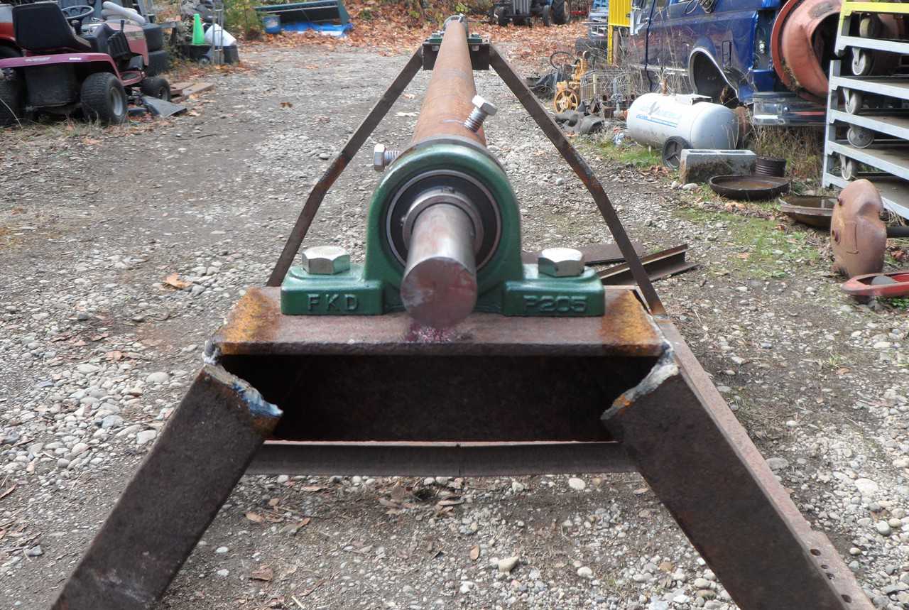

Then for the trommel end supports I welded on some channel made of 3 X 1.5" from the trailer tongue and put a couple of pieces of angle on that to mount the pillow blocks the shaft will turn on.
end supports
end supports

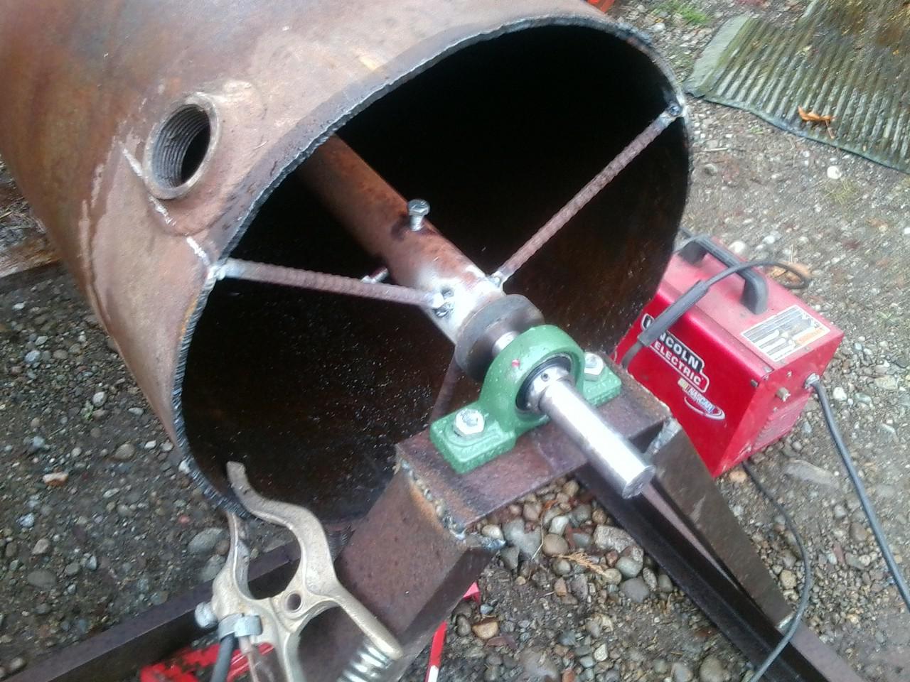

Unfortunately, I forgot to take pictures of the shaft construction it is made from a length of schedule 40 1-1/2" pipe with some collar pieces welded in the ends to accept some 1" drill rod that will go into the pillow block bearings I also drilled and tapped for adjustment bolts at the inside end of the drill rod so I can true up the shaft ends axially to prevent bearing binding.
RonSII
    Mon Sep 17, 2012 5:53 pm
shaft alignment
shaft alignment
Once I had everything lined up and fitted I was ready to weld the drum to the shaft.... but as luck would have it the rain started and there were some very dark clouds heading this way, so not liking to get soaked holding onto the welder I decided to call it a day.
drum ready to weld to shaft
But my luck changed about an hour later and the sun came out briefly just enough to lure me out to tack the drum on to the shaft.
drum temp welded to shaft
So the next step will be to weld permanent supports between the shaft and drum then cut openings in the drum for the screen to cover after that I will have to come up with a drive mechanism to turn the drum.

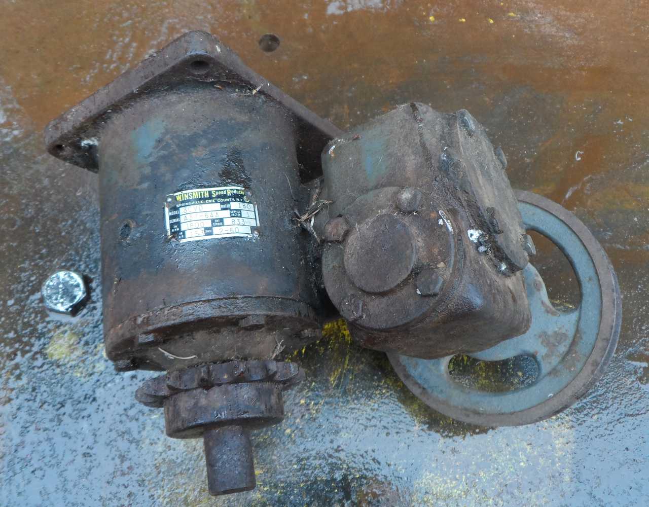

Well with all the rain and wind lately I haven't had much time to get anything done for a drive mechanism but I did find a gearbox laying around that might work, it isn't exactly what I was looking for but I had it onhand so for now looks like this will be the one. It is a 180:1 ratio rated for 1800 rpm input. I was looking for a gearbox I could direct drive to the drum shaft but to get the speed I need on the drum I will have to put a bigger sprocket on the gearbox and then about a 1:2 or 3 up ratio to the drum shaft I think I will still direct drive the motor to the input of the gearbox though.

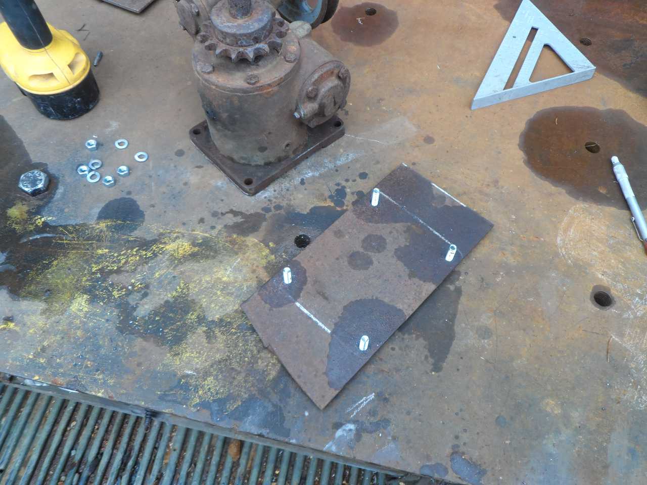

Well it's been a while since I updated this project, so yesterday I managed to get a little work done on it :)
I had a scrap of 1/8th inch flat bar laying around so last week I drilled some holes in it and made a gearbox mount.
gearbox mounting plate
After that I found some 1-1/4 tubing and welded that to the back of the mounting plate to provide for an adjustable slide, the 1-1/4 fits inside the 1-1/2 tubing that will be welded to the frame of the trommel.

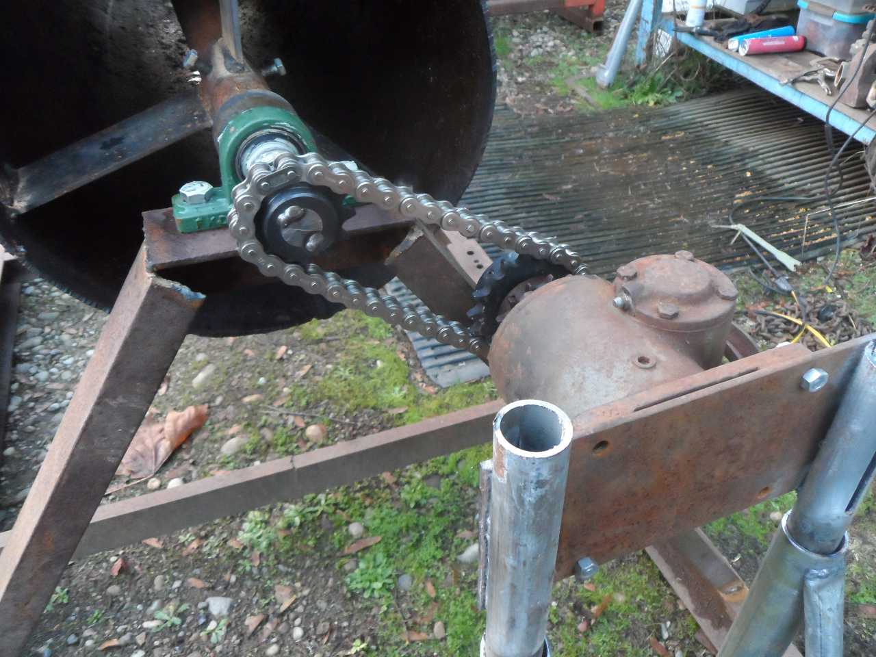

Finally managed to round up some sprockets and chain for coupling the drive box to the drum shaft. The chain is #50 roller chain and the sprocket for the drum shaft will be a 13 tooth with a one inch ID that will just be welded to the shaft, the sprocket I'll be putting on the gearbox is an eighteen tooth this will give a little speed increase from the gearbox... not sure if it will be enough so I guess time will tell.... I have a 25 tooth if it's not fast enough but the 25 tooth has a one inch ID and the gearbox has a 7/8th shaft so will have to make a sleeve or something to use it.
And here it is all assembled, still need to add some transversal supports to the slide mount and drill for pins to prevent the gearbox from lifting under load but making some progress anyway.
Next will have to decide on the motor and how it will be mounted... would like to make it direct drive :? but then I'd have to come up with a coupler and all that.... we'll see I guess.
