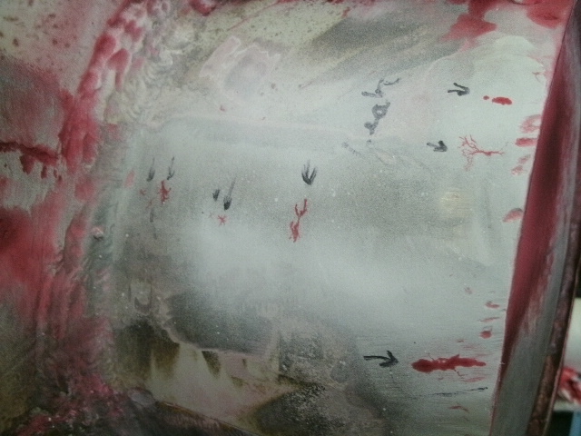

Today I cut out the rest of the "spokes", and cleaned the 2" of the cracked pipe closest to the head. I wanted to shoot them with dye-penetrant, to see how close to the head the cracks were.
That's close.
This will be a 5G-R, with emphasis on the "R", but at least the head is the only obstruction. I'll put up another pic after I cut out the defective section.

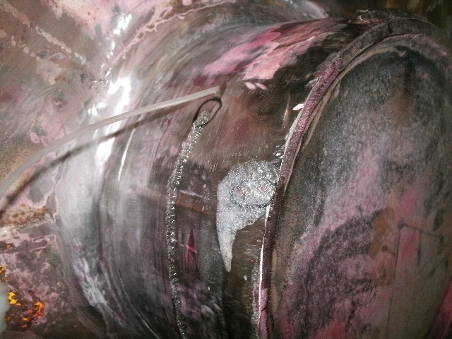

Before I cut the crappy section out, I pressured the annulus (the space between inner and outer vessels) to look for the unexpected. I snooped (soap tested) all exposed metal on the rear head, and found nothing, as I expected. I also snooped the piece of crap metal I'm replacing, and found three leaks. Two appear in this picture.

Sort of... That's paint stained by the red dye penetrant I use.
Any place I didn't take the paint to bare metal, but did scuff it, the penetrant soaks in, so the developer turns it red.

So, I wonder why this one leaks?

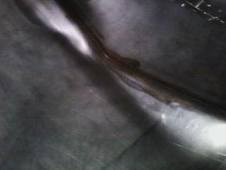

Sorry for the crappy pic. I forgot my camera, took this with my phone. I'll get a better shot Monday or Tuesday.
This is the inner tank of a liquid argon trailer. That crumple zone follows a weld across the entire bottom half. I guess you could say that weld failed it's "bend test".
