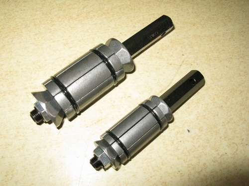

Old exhaust pipe gets tempered and will often crack along side your repair weld.
It's best to salvage good exhaust pipe from a scrap yard, then make the repair with a better quality pipe.
I use a SawZall to cut it, and I weld it with oxy-acetylene. (Automotive exhausts can get expensive.)
I don't even look at the make and model anymore, just measure the diameter of the pipe and go hunting.
You will also need to purchase some tail pipe expanders, so that one pipe fits over the other.
- Tail-Pipe-Expander.jpg (83.62 KiB) Viewed 6749 times
I just finished replacing a muffler on a friends old '87 Cutlass. I used .120. You could use .060, but it's really thin. I mig'd it on about B or C setting with a feed of about 1.5 to 2. You have to work fast 'cause you'll blow a hole thru the pipe. I used a sleeve instead of an expander. Either way is fine, I guess. With a sleeve, you can grind off the pipe side without destroying the muffler. I made my own hangers. Since I have my own bender, I was able to make the parts myself. I didn't have to pay or run back and forth to the muffler shop.
