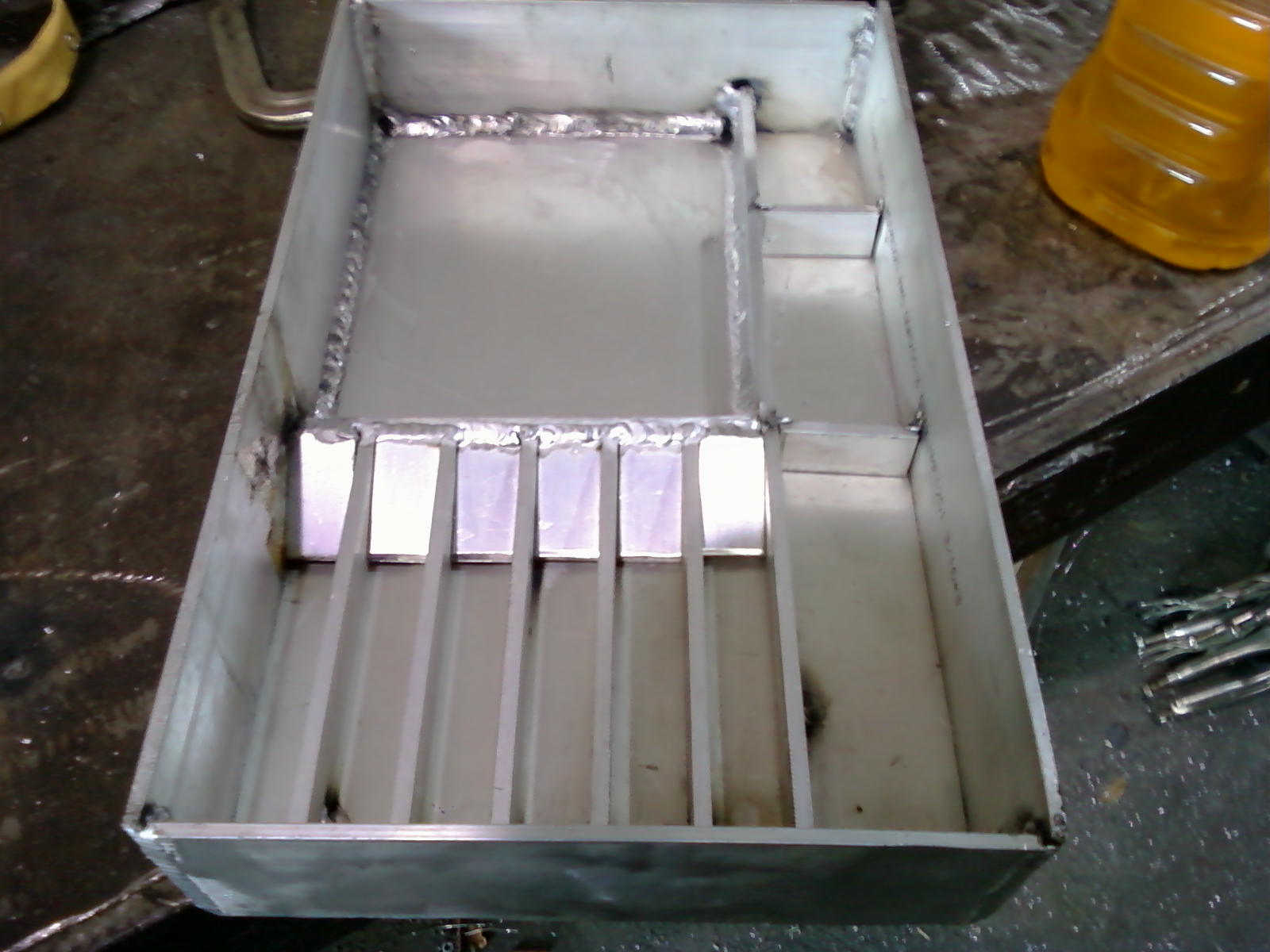

This aluminium tote tray was inspired by the Jody Collier video
I have never like the open box desighn, as it seems to attract junk. So I designed this more compartmentalized version of a tote tray. The large box in the middle is foor a tig torch, the smaller 3 are for gas cups, collets, washers, and other parts. The 6 long trays on the side are for pure and 2% thoriated, 1/8, 3/32, and 1/16 pre-prepared tungsten for your bad-ass quick welding needs. The angled flatbar at the end of each long tray is there to raise up the tungsten so you dont have to do the digging thing. I have made a lid, but havent bought the hinges to attach it yet.
