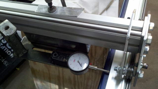

So I made a little holder to hold a magnetic indicator to check the runout of the track. I got .003" in almost 8 feet and that is not even fully bolted down. See pic.
    Fri Apr 01, 2011 10:59 pm
    Australia; Victoria
Is that good or bad? (sorry)
Tjschur
    Wed Oct 23, 2013 8:14 am
    Fairfield, CT.
weldin mike 27 wrote:Is that good or bad? (sorry)
LOL. Well considering some particular human hairs are about the same I would say that is great for a striaght cut.

Give Mick a break... It's metric in his world...
.003 in 8' for a home-shop project is impressive, and then some!

Oh yes this is an impressive build, and .003 over 8' is amazing. our manual mills at our shop are damn near perfect if they are .003 over 1'. This is also a project I'd care to not attempt, as only one of the factors I have never received any material over 4' that didn't have a warp in it in some direction. that and the effort to build one with time and materials, actually using the software, cause you get what you pay for in that respect, in my scenario I'd be better off spending 12k for a used 5x10 and maybe updating the control if the machine is too old and picking a plasma cutter of our choice.
