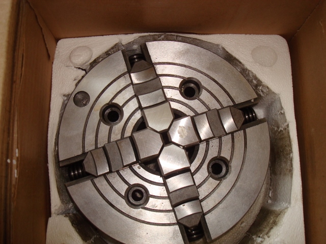

Need some advice and this is the general outline of my project. I’m building a welding turntable that will be 12”x12”x12” using a 1 1/2 shaft. The lathe chuck is 7 ¾ and the motor is a 30 RPM gear drive with a 30 tooth 5 inch chain sprocket already installed. I have a Dart Speed control that can vary the Primary Motor speed from 1-30 RPM. See the pictures to get a general ideal of what I’m working with. I’m trying to figure out the gearing ratio I should use. Maybe 5 RPM
Thanks for any ideals.

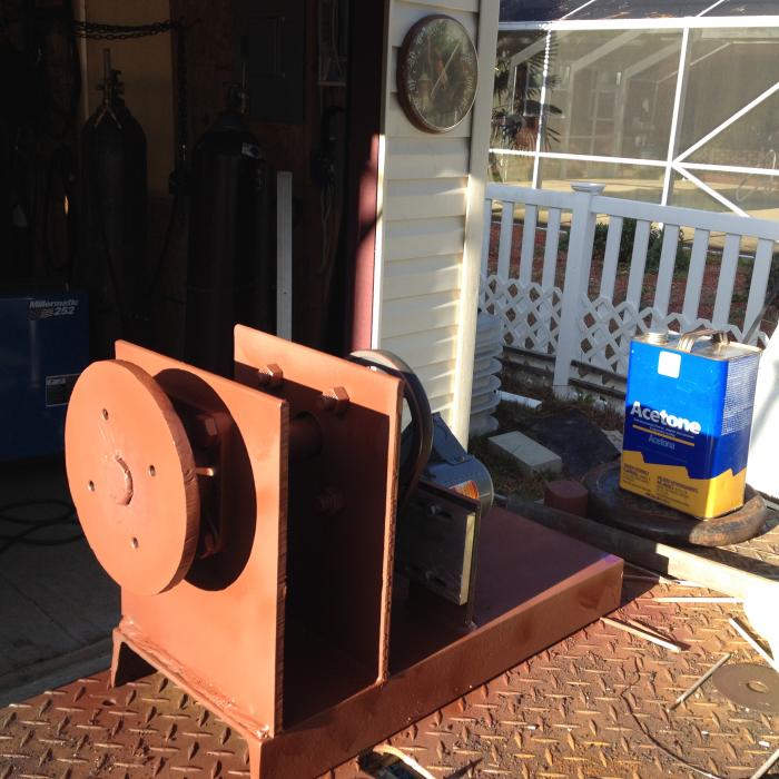

This is a quick update on my progress on the Turn table. I want to bring up the point this project is being done on the cheep
I had a friend turn down a hot rolled 11/2 inch round stock to go though the bearing blocks. It wasn't running very true but by tack welding the plate on to the shaft it run out was reasonable. Total cost so far is $125.00 for two pulleys and a pair of bearing blocks and a lathe chuck. The paint job is primer to keep it from rusting as this is all recycled plate. The speed is around 6 RPM before speed control. I have to build covers and work on the speed control placement and maybe a foot control plug setup and a stand to rotate on.
- front view.jpg (73.04 KiB) Viewed 4193 times
- rear view.jpg (97.58 KiB) Viewed 4193 times
I just ordered an AC 250V 15A On Off Control Foot Pedal Switch TFS-302 on E-Bay. Somewhat cheep coming slow boat from china.
I Plan on mounting it on a HF engine stand that I'm going to modify. I'll post new picture just as soon as I get the mounts all welded up and the table mounted. Gene

That chuck actually adds a lot of $$$$ to the build...you could have made a "cat's paw" with 3 or 4 bolts and a disc attached at the end of the pipe.
Arizona SA200
- Arizona SA200
Location:Arizona
They can be had dirt cheap if you find a rookie machinist learning to part off pieces. Small cracks or a little wobble wont matter for this use.ScubaSteve wrote:That chuck actually adds a lot of $$$$ to the build...you could have made a "cat's paw" with 3 or 4 bolts and a disc attached at the end of the pipe.
