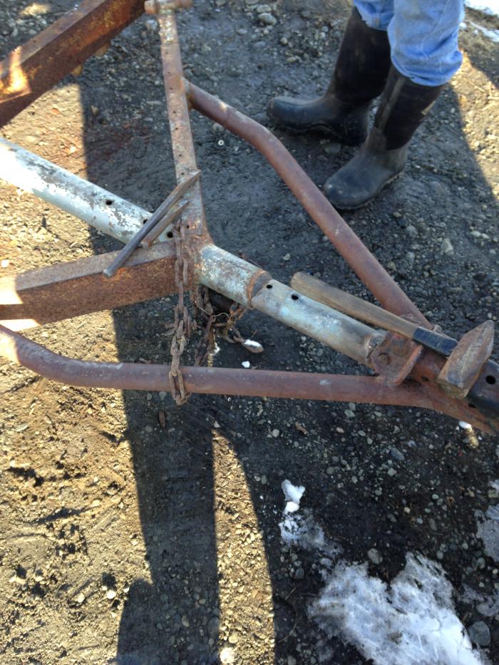

Building a trailer to haul my sled.
more pics to come, hang with me.
~John

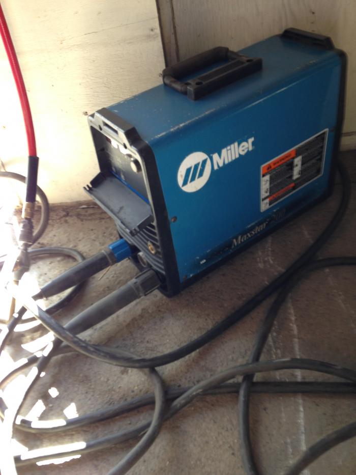

3/32 no-name 7018, cold and damp....
Miller Maxstar 200sd. 77amps, dig 77....
OK....
OK....

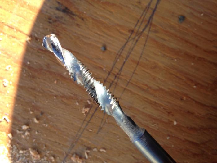

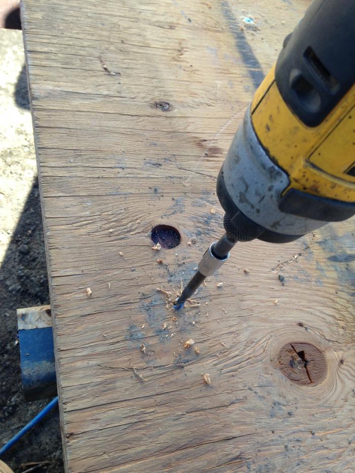

I got one of those drill bits that turn into a tap, 1/4 20tpi.
25, 1/4 by 2in #3 phillips head bolts(countersunk).
Drilling into tyhe square tubing.
Epic!!!
~John
Epic!!!

Off topic a little but where do you get your drill/tap bit? I have seen them but never had the opportunity to use one.
I found it at a garage sale.
I only have that one.
They are AWESOME!!!!
They drill fast, easy, and straight.
I need to buy a set.
~John
~John
Superiorwelding wrote:John,
http://www.ebay.com/itm/Combination-dri ... 20e1f49f7c
Jonathan,
Here's a eBay link.
These bits(good ones) are fairly expensive.
2cents,
~John
I'm looking for a set , little up to 1/2in, fine and course thread.
I've been searching eBay for months but no luck...
Anybody else have the drill tap bits??
Where did you buy them??

Using a truck front end like that is a great idea John,...I like how is allows the trailer deck to be closer to the ground.
Chuck
Chuck
