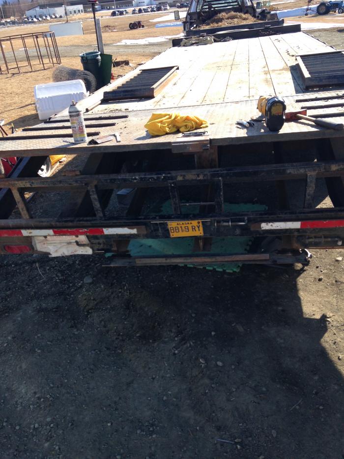

I'd like to ring the neck of the weldor for Circle D!!
Some flux core monkey with his lincoln duffle back must of welded this trailers dove tail!!!
I'll try and sort this out for you guys, shoulda got better pics, but oh well.
This is the back of the trailer.
The back "stand" has hinges and folds under to allow the back to drop.
The hinges were now welded on good at the top, they had 3 small tacks, so I was hired to fix it.
It was all tweeked out of shape, lots of realining and everything to make sure it would function good with out binding up...
The pieces of pipe on the ends of the "stand" wire shot, so I cut them off and flipped them around.
These have a pin that locks into them when the dovetail is up. simple abuse.

Here's the underside.
Thats where the welds are supposed to be, but when this machine came out of the factory, these welds were garbage.
It was also off center, and shoddy work.
Took me quite a bit of work to get everything lined up and square.
Square, aligned, even, and level, and tack!!

I should have some more pics somewhere, but you get the picture.
It was a tough job, took me about 2 days.
It was one abused trailer.
