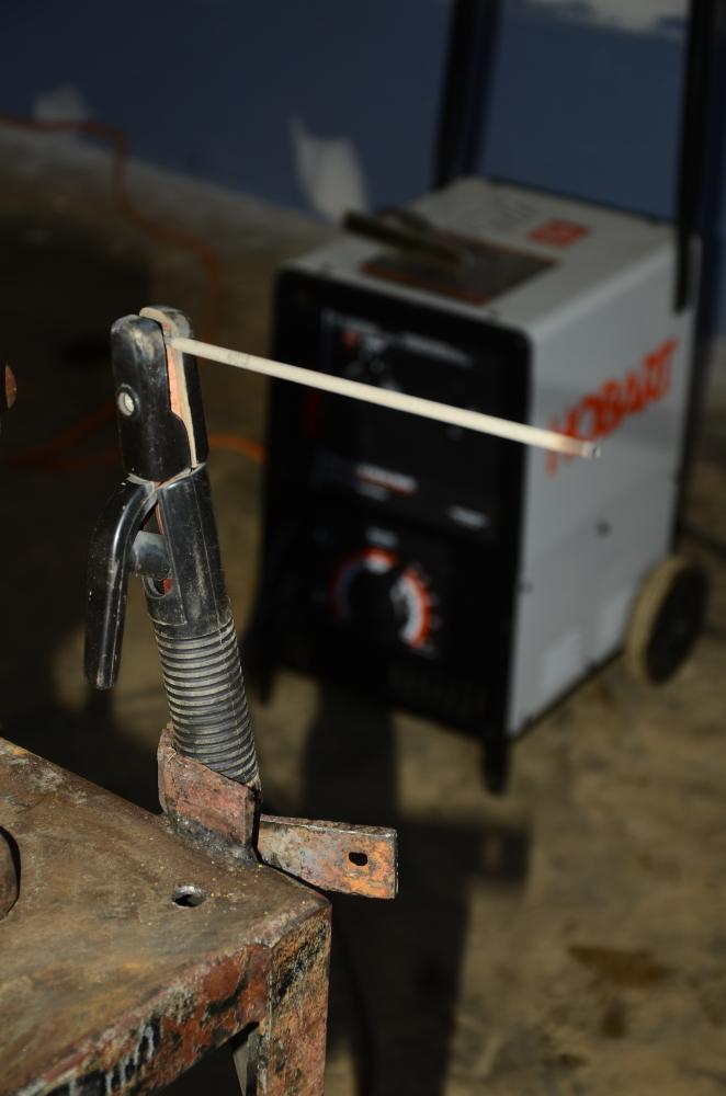

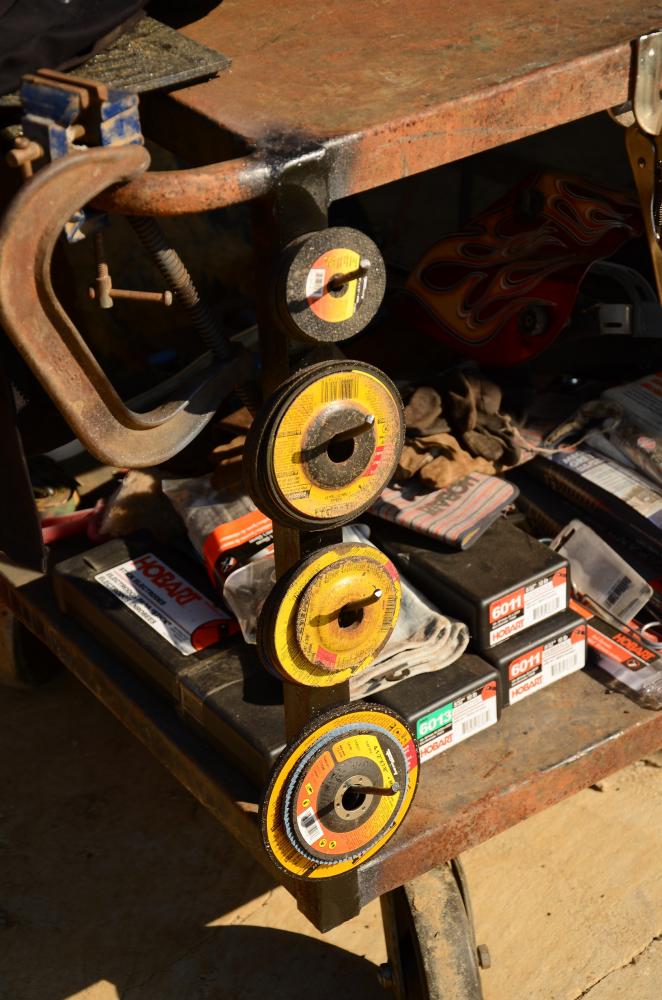

I'm a newbie at welding period. I went last week and purchased my first ever stick (Hobart 235 AC/DC LX) and I am having a blast. Got to thinking I NEED a table, something solid. So off to the local scrap yard and low and behold they had just the right thing, it had been there for some time the guy said and at .30 a pound I took it. Had to find some casters and then I started putting my own touches on it.
So, I have added an electrode holder, a power strip and today I added a rack for my cutting wheels.. I will build a box holder under/between the handle next week. I have some thin sheet metal that I will cut and weld up. Wish me luck.. having a blast learning. Here are some pics...

- cutting wheel holders
- DSC_2341^.jpg (98.82 KiB) Viewed 2625 times
- Electrode holder
- DSC_2188.JPG (51.15 KiB) Viewed 2625 times

I suggest getting a big slug of steel, like a semi-truck brake drum, for when you really need to pound the sh!t out of something. The brake drum is solid, and has multiple curves and edges, to serve as a redneck "anvil". Just a suggestion, since the table isn't built for an eight-pound hammer...
