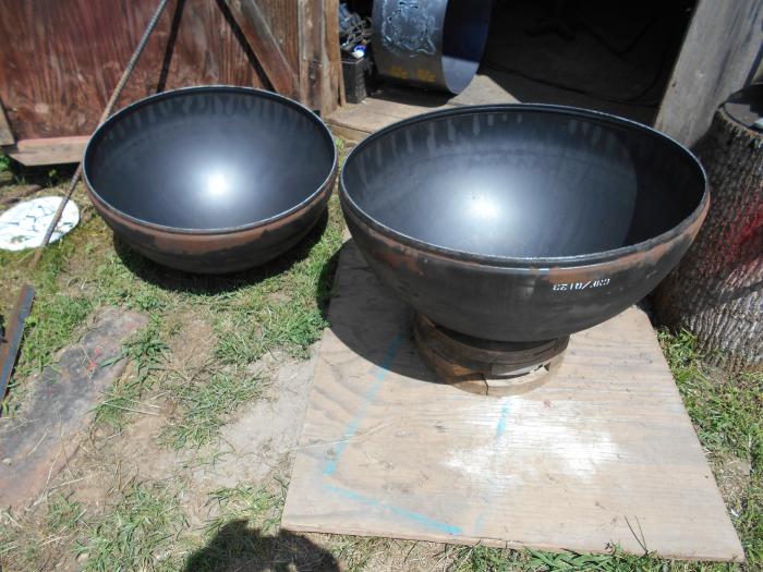

Well folks the time has come at last for me to build a sphere fire pit. I will start with two 30" hemispheres and go from there. I am in the process of building it right now and am taking plenty of pictures. I will be keeping you all posted frequently.

Progress so far!

- Fit up
- DSCN0846.JPG (83.5 KiB) Viewed 3653 times
- The two hemis un-boxed
- DSCN0845.JPG (67.01 KiB) Viewed 3653 times

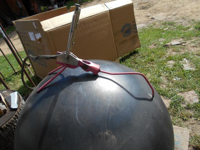

First problem! After doing some grinding and finessing to get the two halves to fit up just right. I took the good ole 3M rust and paint removing wheel to prep the joint. THAT IS WHERE I RAN INTO A PROBLEM! Where do I hook the ground clamp? I don't have a magnetic ground, I cannot weld a lug onto it either, the customer is a cheapo who wouldn't pay extra for me to get one (just kidding) so what do I do? BREAK OUT THE PINK FLAMINGO!!!

I thought this was going to be a description of shaping plate into a dome, and then I saw the photo labeled "spheres unboxed". Where did you source the hemispheres from?

It was a metal forming company. I honestly cannot remember off the top of my head because I contacted so many people trying to find them. I will find out and let you know.

They were purchased from Commercial Metal Forming out of Youngstown, Ohio. If you order any please note that there are many sizes and to get a complete "ball" one needs to order two hemispheres.

Can you spec out the wall thickness of the spheres and the mating surfaces there?
Is one a female and the other male? Do you have to grind one mating surface off and tack 'em up to keep them, square, as it were, you get where I'm going.

Wall thickness is 3/16". They were both male ends if you want to say it that way. I had to take the plasma and cut one of the bands off. They both had bands where they could sit inside a pipe flush so I had to cut one off so the other band would sit inside of the other hemi. It took one whole grinding wheel just to clean it up and dress up the joint. I will post pics soon. Going to start cutting today SO EXCITED!!!
