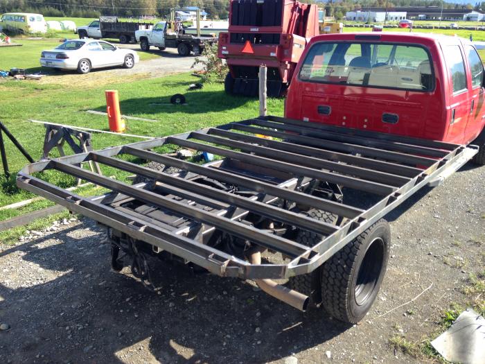

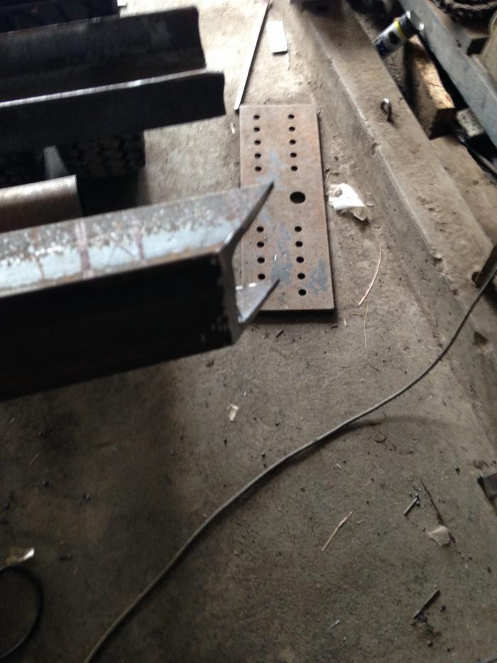

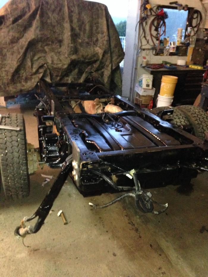

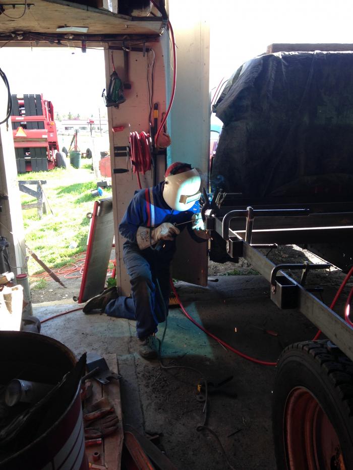

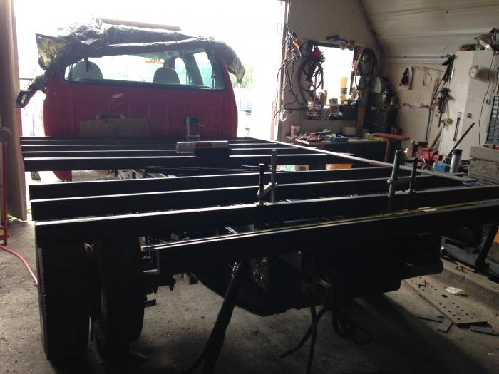

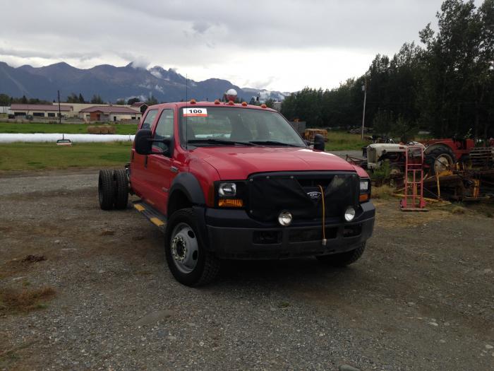

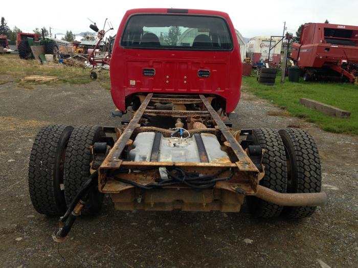

The truck came to me as a cab and chassis.
The customer is buying ALL supplies....

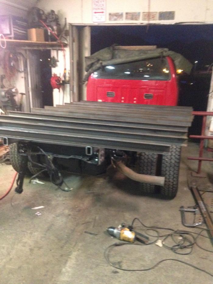

Time to order metal....
And its here, time to start cutting it up.

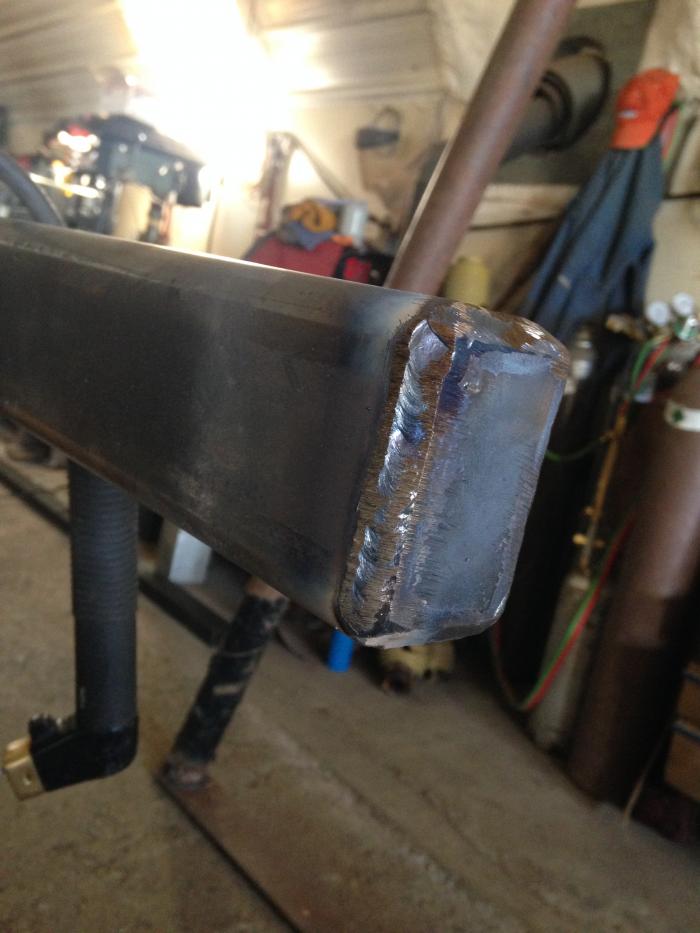

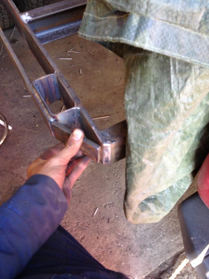

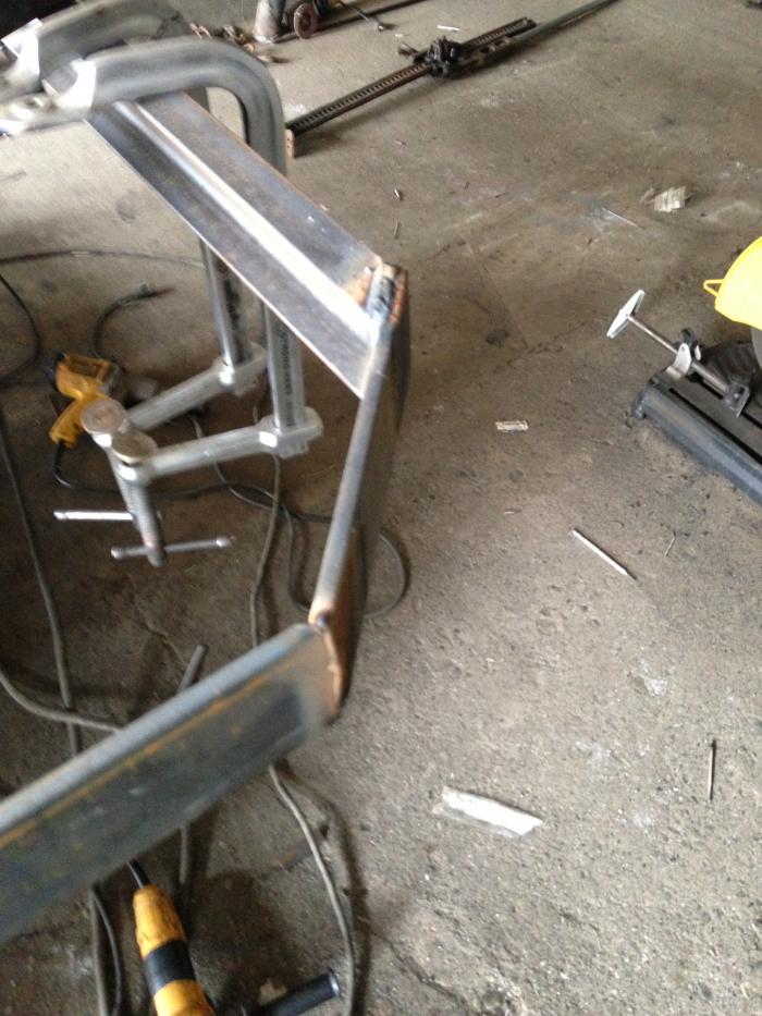

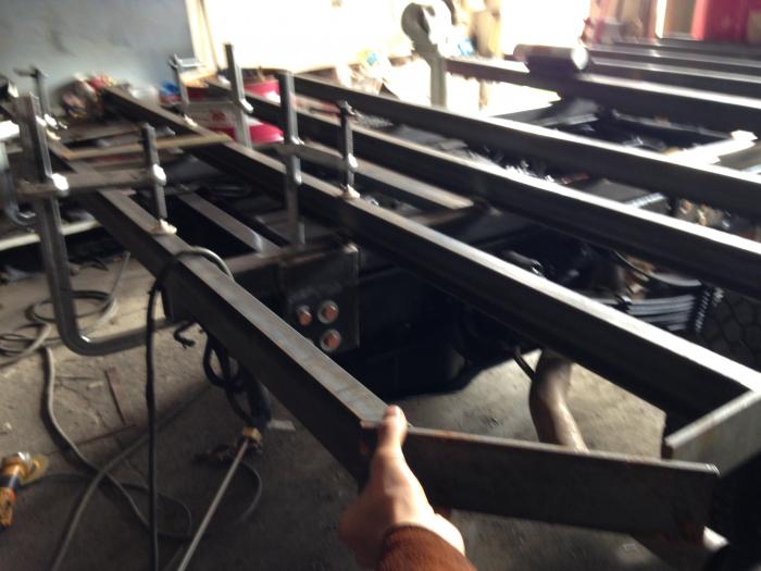

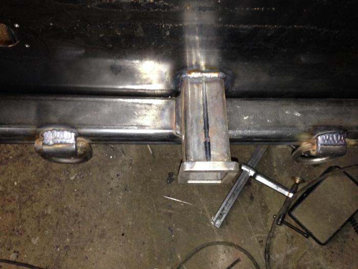

3 side plates on each side, 1/2"x 6" flat bar...
- IMG_7539.JPG (48.56 KiB) Viewed 9986 times
- IMG_7541.JPG (110.78 KiB) Viewed 9986 times
- IMG_7552.JPG (79.99 KiB) Viewed 9986 times

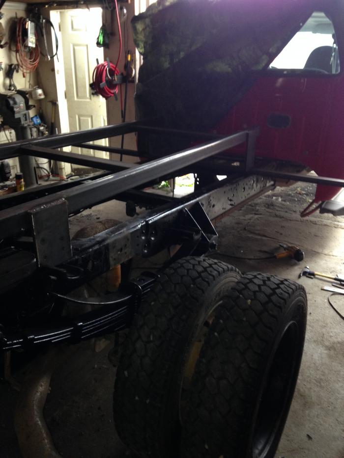

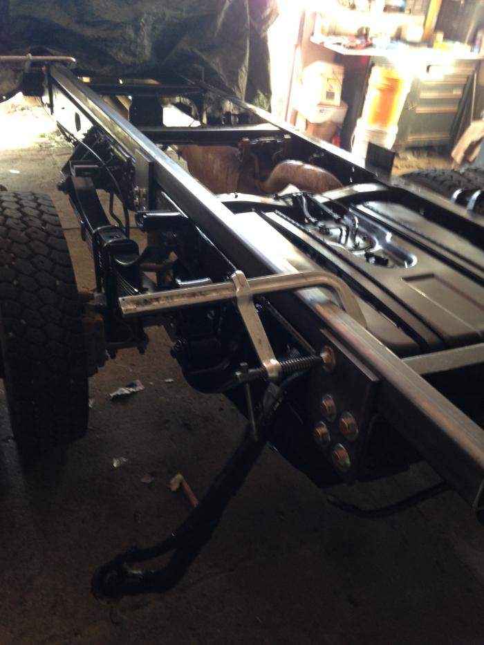

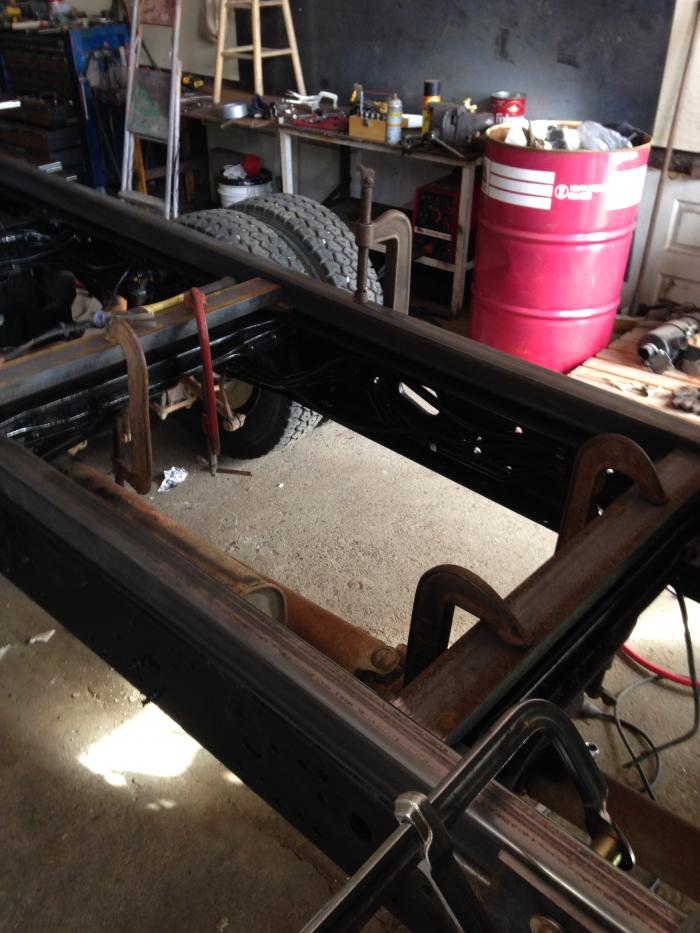

I didn't drill any holes in the frame, I used all existing holes.

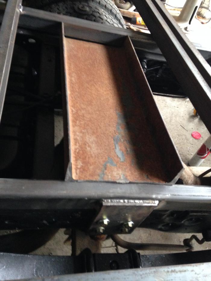

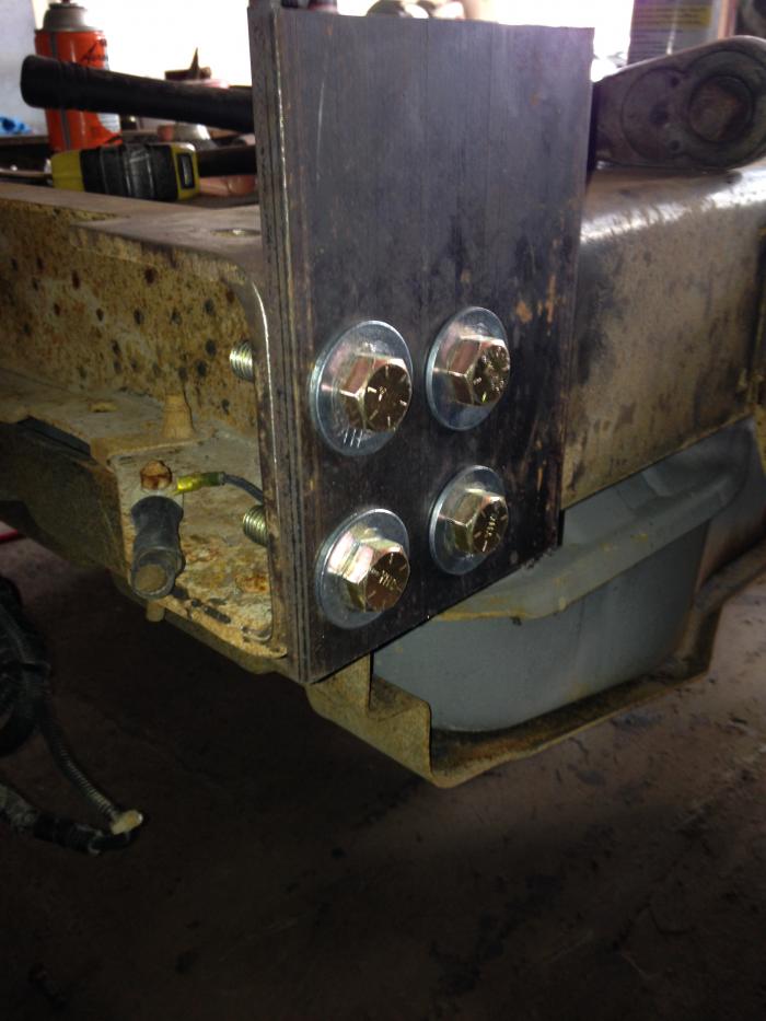

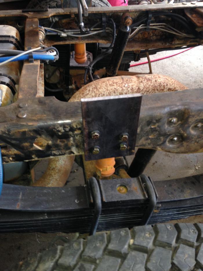

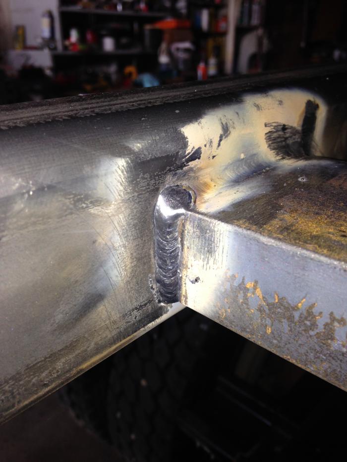

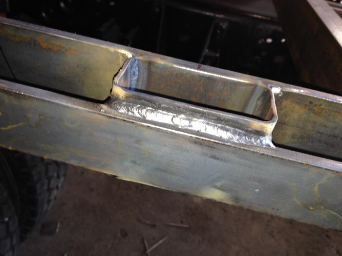

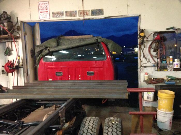

Wes917 wrote:Looks good so far, only thing I don't like is the bolts through the frame. Are those going to stay. If so they should be a little longer. Or maybe it's the pictures?
They are just started in the nuts.
Just fitting them for now.
They do have 1/2" to 3/4" past a full nut.
Grade 8

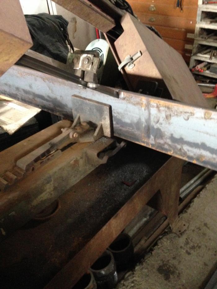

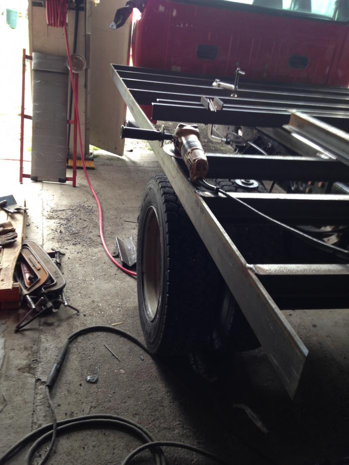

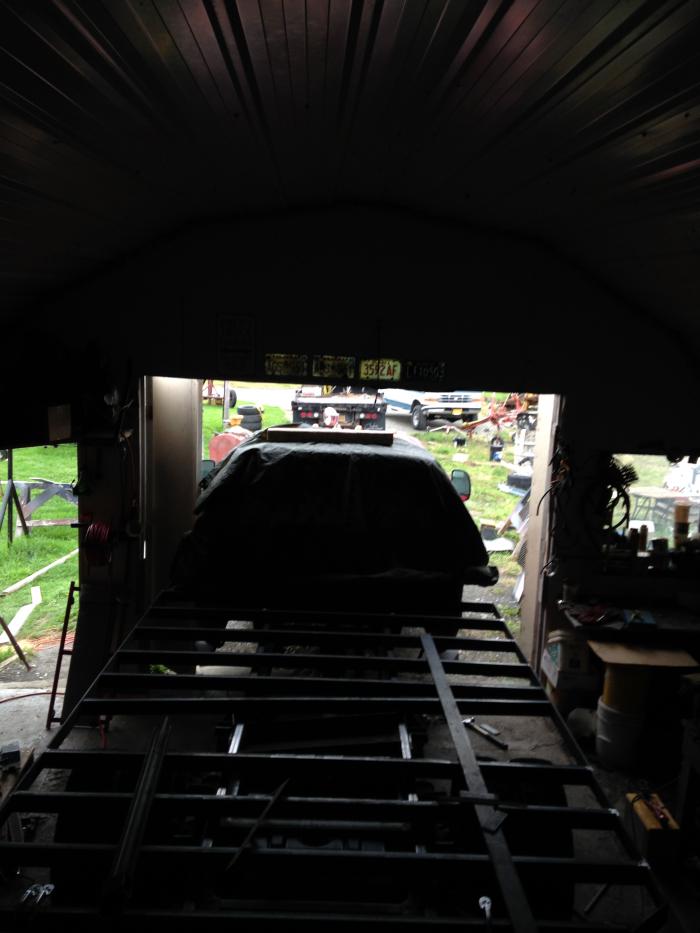

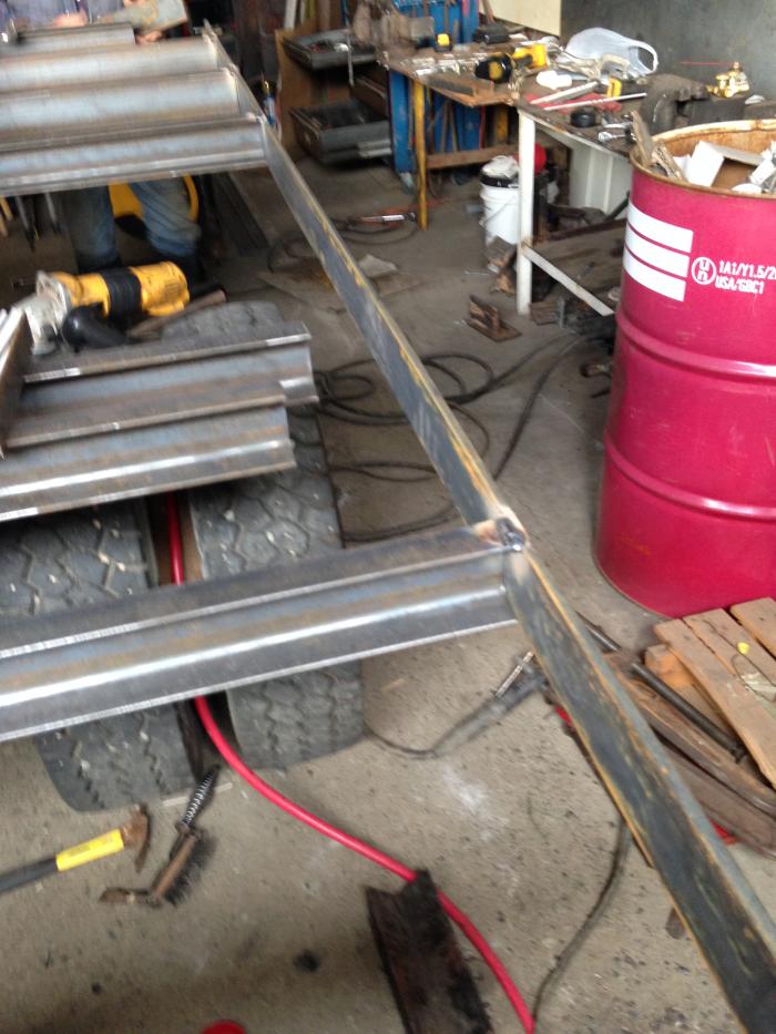

I got the 3" channel cut into 95" pieces...
