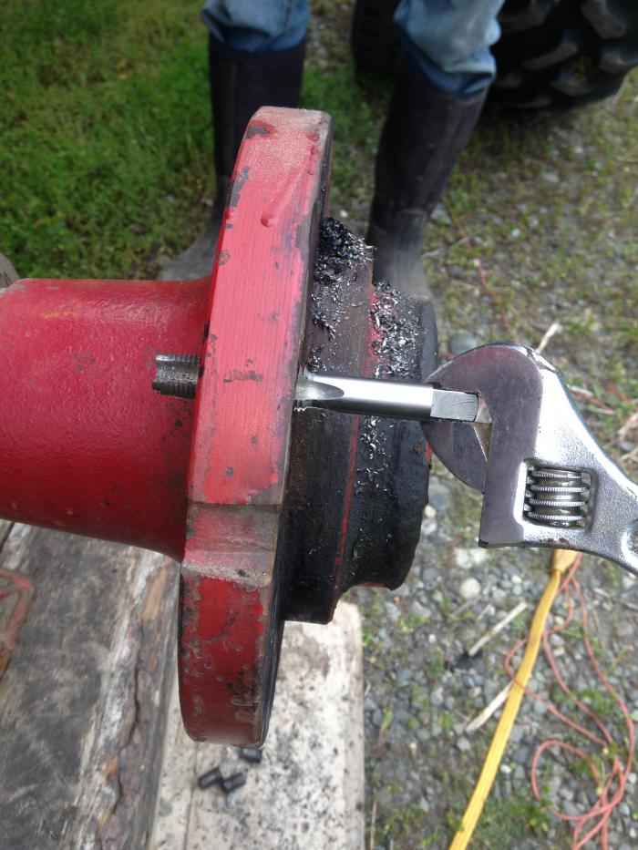

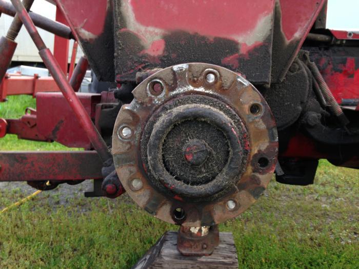

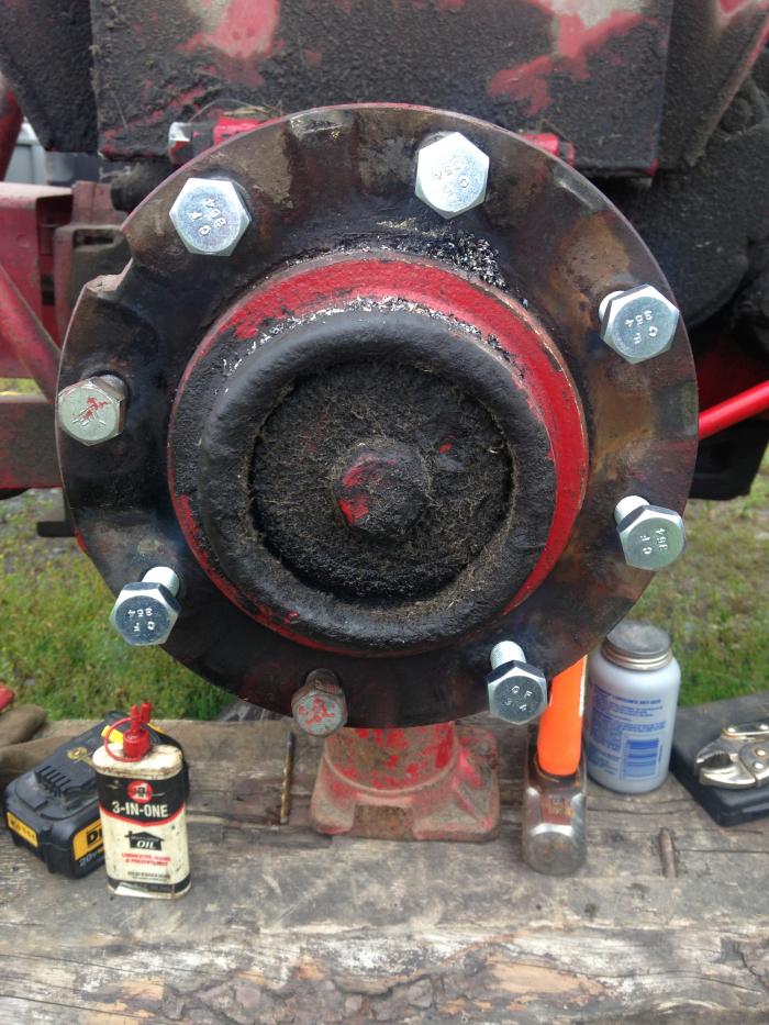

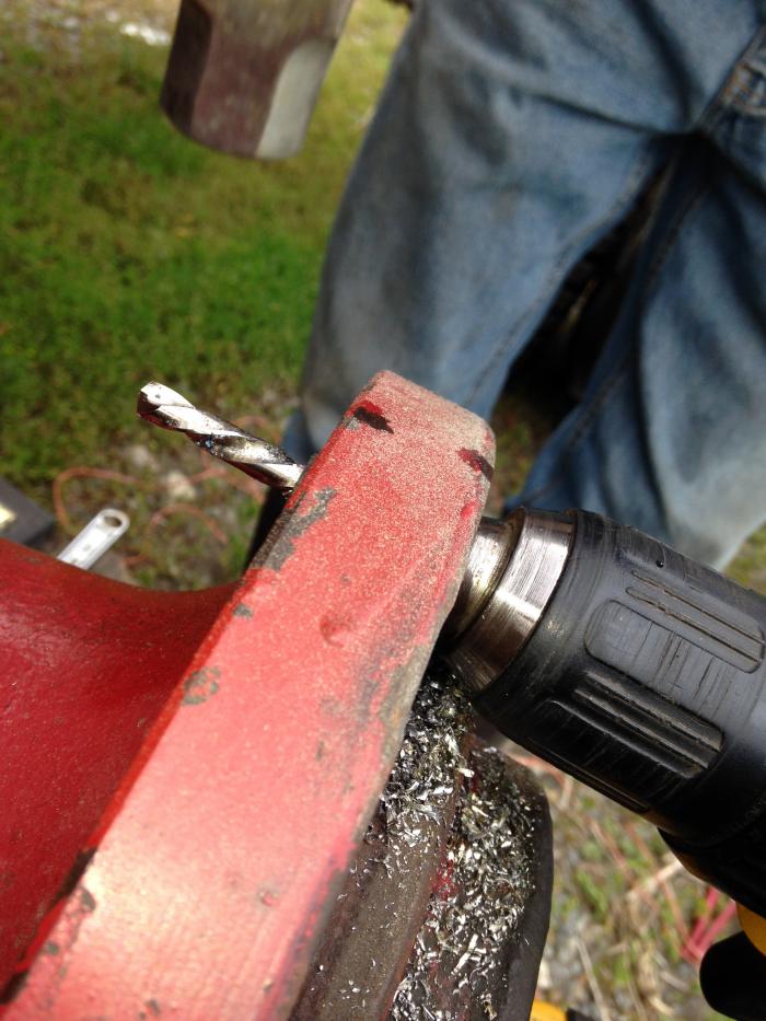

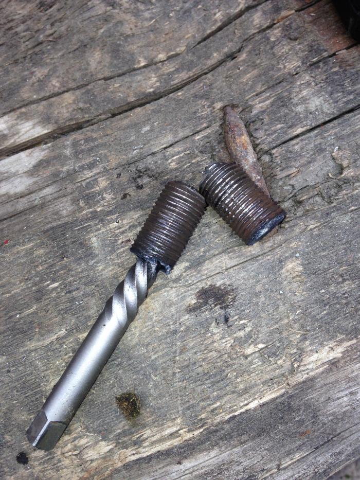

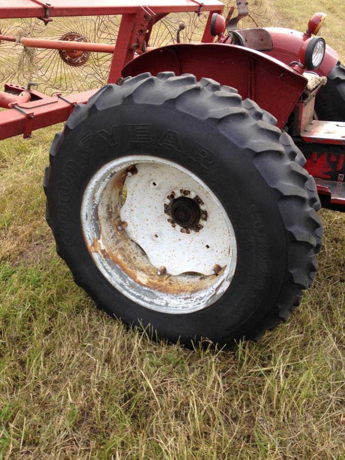

These are a 9/16" bolt....Rear tractor tire...
They worked loose and snapped off....Which makes everything less impressive
Extractors rarely work on rusted and seized parts....

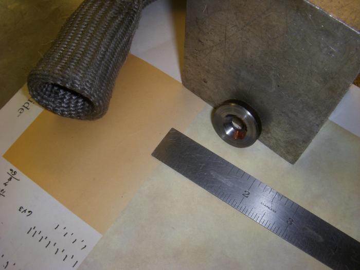

IF you have acesses to a lathe, cut a thick washer with a tapered hole no bigger than the tap drill size of bolt, when flush break/ grind, big for heat sink/protect surface and threaded portion. heat and birthday candle wax.

Rick, could you explain that with a bit more detail? I couldn't understand...rick9345 wrote:IF you have acesses to a lathe, cut a thick washer with a tapered hole no bigger than the tap drill size of bolt, when flush break/ grind, big for heat sink/protect surface and threaded portion. heat and birthday candle wax.
- DSCN0578.JPG (34.79 KiB) Viewed 2455 times
- DSCN0575.JPG (48.95 KiB) Viewed 2455 times
- DSCN0573.JPG (52.96 KiB) Viewed 2455 times
- DSCN0571.JPG (61.07 KiB) Viewed 2455 times
1" bar stock1
Drill 5/16(8.5)
Counter sink 45*
Cut off
