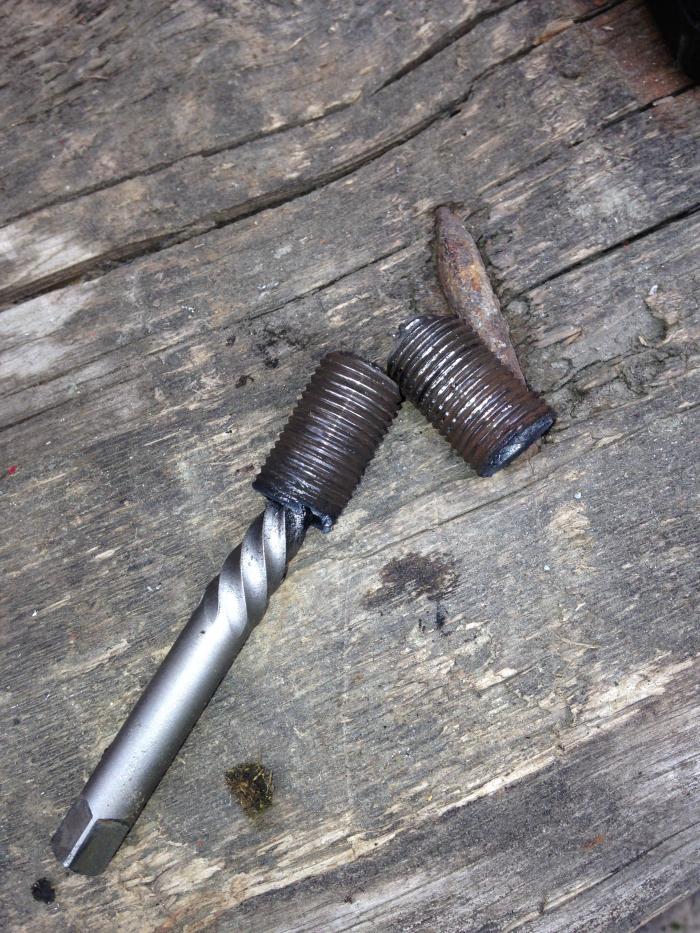

by AKweldshop
Re: Removing Broken Skid Plate Bolt
Posted: Mon Oct 27, 2014 12:04 am
by AKweldshop
These are a 9/16" bolt....Rear tractor tire...
They worked loose and snapped off....Which makes everything less impressive :D
Extractors rarely work on rusted and seized parts....
Posted: Mon Oct 27, 2014 12:14 am
by 79jasper
Yeah, I've never had any luck with "easy outs."
More like break off and piss you offs. Lol
Idea behind left hand drill bits is it may catch and turn out.
If it's not a blind hole, a normal drill could spin it on through also. (Long as no shank or shoulder is left)
I've heard good things about Kroil made by kano labs. Thrust works well also. And last but not least, pb blaster hasn't failed me often.
For me, it's usually exhaust bolts that I break.
