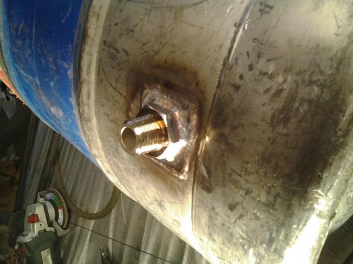

The secret of stainless...get in and get out and you will get color. Overheat it and it turns gray. I weld fittings into beer kegs for a bunch of homebrewers who got my number and I have found that stainless welds up great with little heat but if you linger, it will rainbow without a big cup and even with a big cup. I think for sculpture purposes, go with the least amount of amps possible. I weld mostly 304 and I get some color if I get hung up sometimes.
Here is a patch and a fitting on a keg and welding a fitting with a thick shoulder generates some heat into the base metal and I got some color even though I was movin on out.

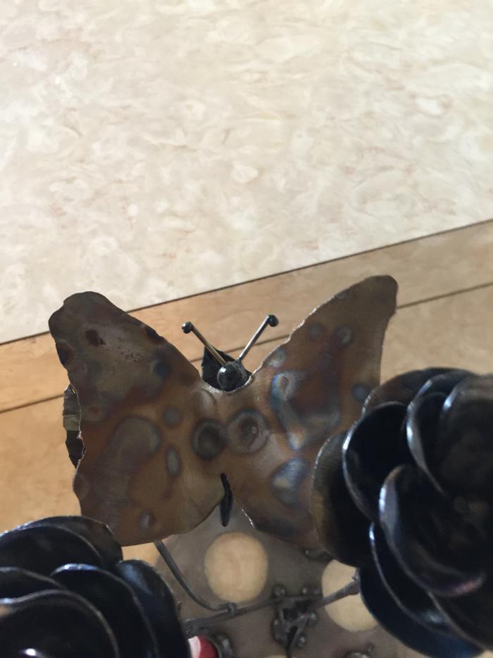

I am trying to deliberately get different colors over fairly large (Compared to bead width) areas. My sculptural welds are usually quite small and I'm happy with them. I have been running my tig over certain areas quite rapidly with no filler purely to color it. I think I just need to experiment and practice to get the hues I'm after. Pretty sure careful heat control is the key to what I'm trying t do.
I'd hoped for more amber and/or orange. I'm sure I let it overheat.

Try a small cup. Im sure you already know that the color is oxidation from contact with air. Try a smaller cup and lower amps to introduce more heat and see what happens. That butterfly candle holder is bad@#s!
Thanks. I hope the girl I made it for likes it.
