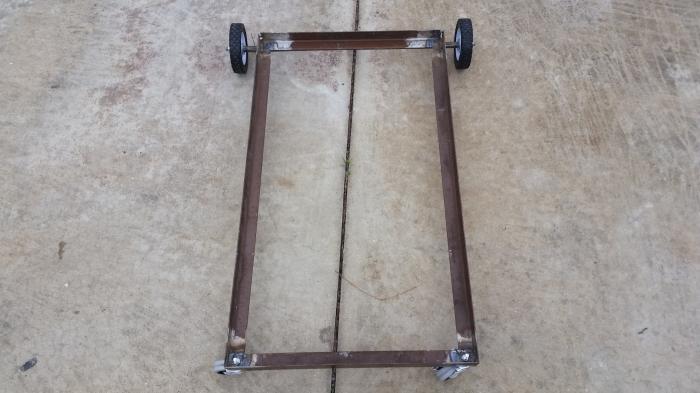

This is what I have for a base but without thinking twice I made it 22 inches wide and forgot my machine was only 17, any ideas how to make it work? Thinking of spacing a 1 inch piece of flat bar across and then putting a piece of angle iorn behind it but not sure how it will work.

Hate to say it, but I'd be cutting and welding it back to 17 inch width.
Inconvenient right now, sure, but not as inconvenient as living with a cart that would always be 5 inches too wide.

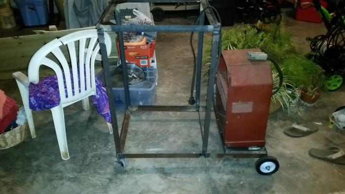

I decided to leave it at 22 and I know it's not the greatest thing ever but for my first cart and at home project I like it

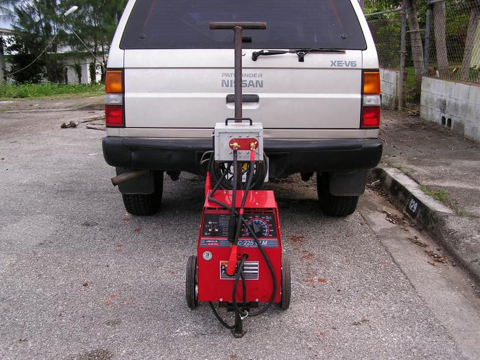

We all start somewhere. Having been welding on and off over the last decade as a trade, not as a profession; the carts and tables I made in the past that were replaced mainly due to expanding my equipment, I can look back at the first ones comparing the welds and how they were fabricated to gauge how far I have progressed.tschmitt wrote:I decided to leave it at 22 and I know it's not the greatest thing ever but for my first cart and at home project I like it

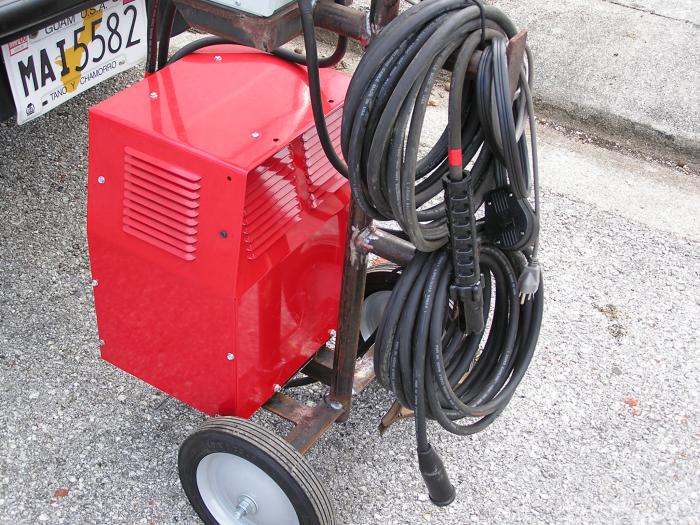

I built this about 10 years ago. It's a little smaller but weighs just as much.
- P1010032.JPG (95.98 KiB) Viewed 3651 times
- P1010029.JPG (82.96 KiB) Viewed 3651 times
- P1010030.JPG (84.89 KiB) Viewed 3651 times

Ifit,
Is that the export version of the old Lincoln tombstone? I've never seen one in that case before and it's not on the US Lincoln website.
Larry
Larry

Thanks. It was a clean design. A lot more modern looking than the traditional tombstone.ifit wrote:I think it is. I don't have it anymore, sold it & got a Miller AC/DC welder.
