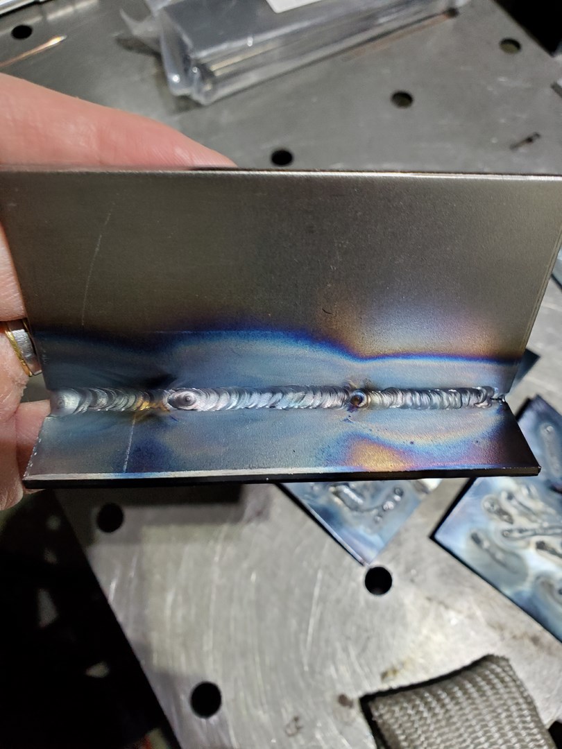

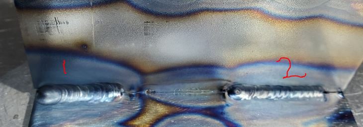

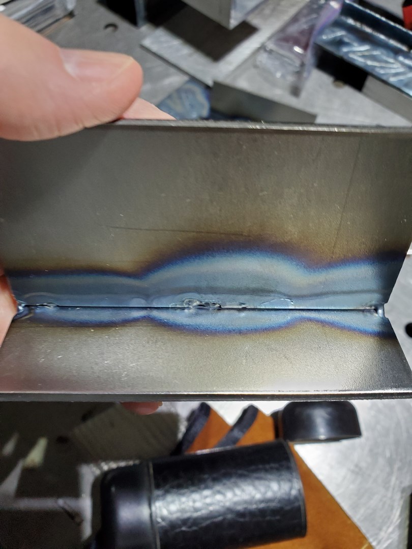

Hey Everyone,
I haven't made enough time to really show much improvement. Still get in a little torch time, although there was quite a lag.
I've attached a couple of pics of a inside corner joint I attempted yesterday. 1/8" mild steel plate. 145 A at full pedal for the middle bead. Still not enough penetration.
Any suggestions?
Thanks,
Jeff

cj737
    Thu Sep 29, 2016 8:59 am
Your arc length is too long. That is evidenced by the heat affected zone up the plate. Too long of an arc causes a lot of problems, not the least of which is poor penetration.
Goal is to have the tungsten “almost” touching the puddle to keep the arc under a focused control.
Also, drop your heat to 125-130. That’s ample to weld 1/8” with 3/32” filler. You can go full pedal and stuff filler in to control the puddle that way instead of fussing with the pedal trying to keep from blowing through the material.
Jeff2016
    Thu Mar 10, 2016 4:09 pm
Hi CJ,
Thanks.
The arc length is the most challenging part of the process. The thought in my head as I'm running the bead is that I'm almost too close in terms of arc length. That being said, I get the fact that the heat affected zone is telling the story.
I'll keep working at it.
Thanks for the advice.
Jeff

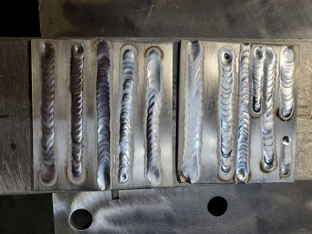

Hi Everyone,
First aluminum attempts.
I know that several of the beads were too hot. Still working on dialing things in.
Jeff
20221211_124640 1920 x 1080 res.jpg (305.12 KiB) Viewed 498969 times

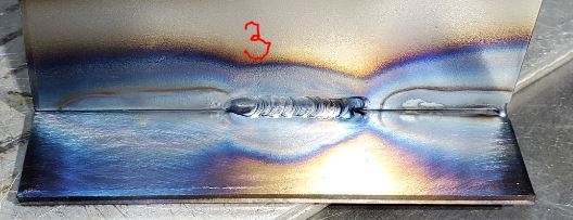

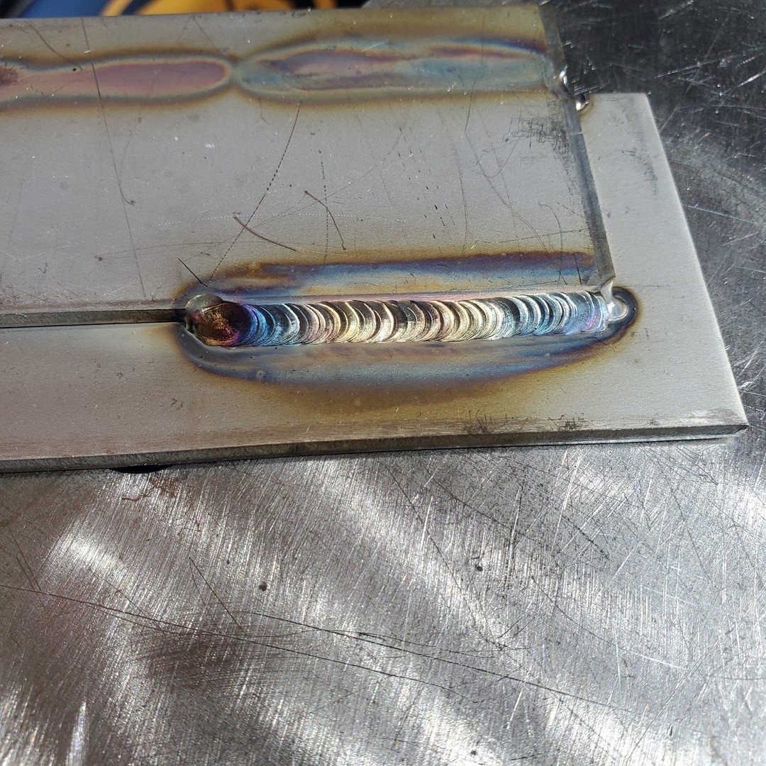

I understand everything that is being said. I'm just to the point though that I'm starting to doubt that I am even capable of becoming proficient at this. I am focusing on the arc length and keeping it short... if it is too long now then I might as well stop wasting everyone's time.
I'm including a couple of pictures from this morning. These are also 1/8" mild steel with the machine set to 130A at full pedal. One shows two beads on a corner joint on one side of the vertical and the other picture shows the opposite side with one additional bead. I keep fighting to keep the heat affected zone small and yet see fusing between the vertical coupon and the base on the opposite side. I should be seeing a joining of the two pieces of metal on the backside shouldn't I? It seems like the harder I try to get the penetration and fusing on the back side the larger the heat affected zone is.
I'm determined to be successful at this. There are times, though, that make me wonder if my older eyes are just not going to see as well as they really need to see to get even closer to the puddle.
Thanks for your input.
Jeff

cj737
When you weld a T joint like that, it’s not uncommon to not see filler/weld pushing through to the backside. For that reason, most T joints get welded on both sides, front and back. This also insures a much stronger weld.
If you want to single pass it, then you can “cheat” by creating a small gap intentionally (say 1/32”) and then continue how you are welding. If you don’t see weld then, there are other issues effecting your results. For instance, traveling too fast prevents the weld from fully driving into the backside. Too much filler causing the puddle to cool.
T joints are tricky because you need to focus the arc right at the root of the joint. If you move too quickly, you’ll get a void below the weld. To understand whether this is happening, cut some of the coupons in the middle of the weld run. Polish and etch it. See if there is a lack of fusion at the joint. If so, this is contributing to the lack of full penetration.
When I have mentored new welders, I always try to have them “keyhole, then dip”. Get your puddle, cause the parent metal to actually melt away ever so slightly causing a small “keyhole” at the leading edge of the puddle, then dip your filler to cure it. Let the added filler fuse in, then advance, pause for a keyhole, dip, pause, advance, keyhole….
130 amps should be enough heat provided the filler is not being over-added and your arc is accurately pointed at the joint (45* to the base) and your travel speed is not too fast.
The HAZ is not something to worry about. Heat saturates metal. You can quench your coupons in a bucket of water to help calm that down too.
Hope this helps?

Jeff2016
Hi CJ,
Thanks,
Your input does help. Thank you.
cj737 wrote: ↑Mon Jan 30, 2023 1:02 am When you weld a T joint like that, it’s not uncommon to not see filler/weld pushing through to the backside. For that reason, most T joints get welded on both sides, front and back. This also insures a much stronger weld.
Hope this helps?
I like your advice about cutting some coupons and etching them. I've thought about doing that in the past. That will be good motivation. It's also about the only way I'll know for sure how close I'm getting.
As I get a little more comfortable with the basics I'll try you keyhole advice. Just knowing that I don't necessarily need to see fusion at the base of the vertical on the backside is a little comforting. Knowing that the HAZ isn't as critical as I thought is a good thing, too. I have really been hung up on getting a good puddle and not overheating the base metal.
Right now I have to fight at staying a little relaxed while still trying to maintain arc distance, torch angle between the two coupons, torch angle slightly back from the puddle, speed of the torch and feeding the filler. I know it takes time. I don't know if it's a good thing that I need to put welding to the side when I'm in the middle of a big work project, or if I'm backsliding.
I appreciate all your advice.
Jeff

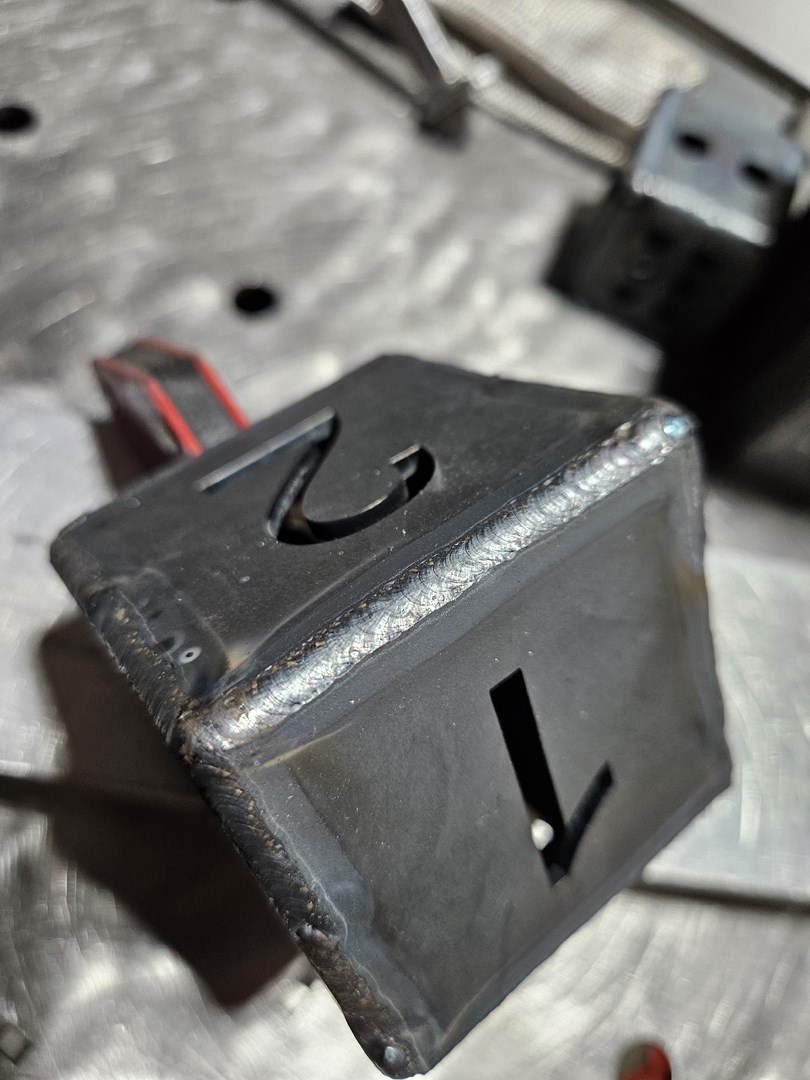

Hi Everyone,
I have been working on outside corner welds on mild steel cubes. The metal is 11 gauge.
I'm using 3/32" filler.
I'm being careful, trying to keep the HAZ from getting too hot.
The problem I'm having is when I add the filler it sticks slightly until the puddle catches up to it. I'm afraid if I try to get closer to the puddle that I will end up putting the filler into the tungsten.
I could try using 1/16" filler, but, I don't want to compromise the cooling affect of the bigger filler.
Am I looking at this wrong?
Jeff
cj737
Sticky filler is too cold parent metal (usually). For 11 ga corners, I like #5, 12-15cfh, and I run it on 130 amps with a pedal to ease off.
Outside corners really depend heavily on direction. Are you up, down, flat, horiz? If you’re comfy, I like downhill so gravity drags the puddle into the heat so I can run hotter. Uphill, I am dragging the puddle and using less heat which makes feeding rod a bit trickier.
Don’t know if that helps any?

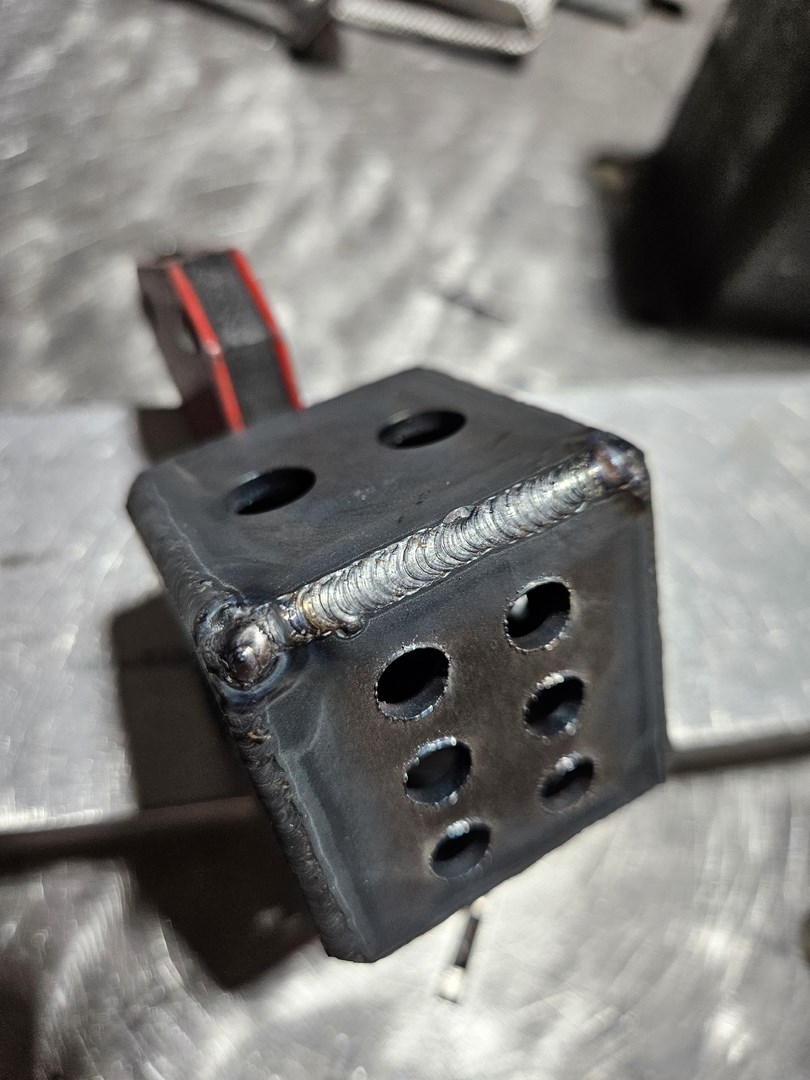

Jeff2016
Hi Guys,
Here are a couple of examples of the corners.
@CJ - I tried the #5 cup and didn't have success right away. Maybe it will take a little more time using that setup.
I hope to get more weld time today.
Thanks for all your help.
Jeff
20240208_065604 1920 x 1080 res.jpg (144.54 KiB) Viewed 492175 times
20240208_065431 1920 x 1080 res.jpg (142.82 KiB) Viewed 492175 times
cj737
Not much wrong with those results

cj737
I would encourage you to do a more comprehensive job cleaning those parts front, back and edges before TIG welding them. You’d be surprised at how much better your arc and puddle behave with clean metal.
And for kicks, next time, weld each face with different types of filler wire. 70s2 on one face, 70s6 on another, 309 and 312 on others. Experimenting on the same material with differing fillers will teach you a great deal because you’ll have direct comparisons face-to-face.
You could really go nuts and pad one face with SilBr wire too for the experience. 😎
Jeff2016
Hi CJ,
You are right... the outside faces of the cube metal weren't in such great shape. I wasn't planning on welding any of the outside faces on these, so I didn't clean them to get down to bare metal. The edges were bright bare metal, and I acetone-wiped them, too.
Most of the mild steel welding I have done has been with 70S6. Early on I used the 70S2. I've also used a couple different grades of stainless. I feel almost guilty using it on mild steel... I feel like I am cheating. Lol It's appearance is a lot more to my liking.
I've used SilBr on a couple of different occassions. I worked with some a few weeks ago and felt like I might mess up the mindset I had for the mild steel filler. I'll give it a try soon, though. (When you say padding, are you talking about applying it to the entire face (as opposed to a few beads)?
Thanks again.
Jeff
