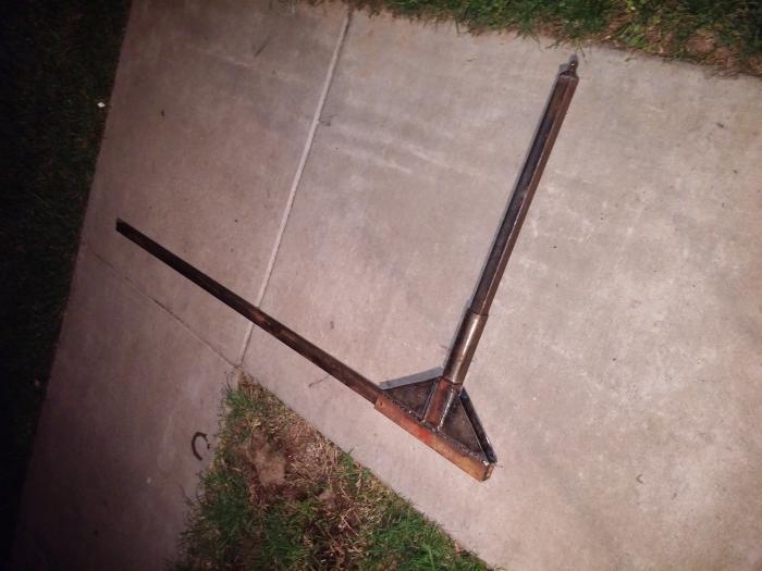

Brother in law needed help getting his crankshaft bolt off his car, he broke an impact and 2 breaker bars on it. So I made him a bulletproof breaker bar/cheater. Worked great broke the bolt with a small push.

Neat trick on the breaker bar.
Protip: if you don't have time or inclination to fab this, use a 1/2" breaker bar, a pipe for leverage against the ground, and after determining which way it needs to spin, set it in place and crank the car.
Engines make GREAT breaker bars.
Show,
That is a breaker bar and a half!! Just be careful not to snap the bolts off with that much leverage! Looks great though.
I did that accidentally on an 80's ford inline 6 - worked great - then I put the bolt back where it belonged...GeekWithWelder wrote:Neat trick on the breaker bar.
Good thing it removed the bolt instead of tightening and breaking it.
They were going to try that, however in one of their attempts with the impact wrench they were using it cause the upper cam pully to jump some teeth on the very worn out belt they were trying to fix. I advised them against cranking the engine so they didnt bend any valves.

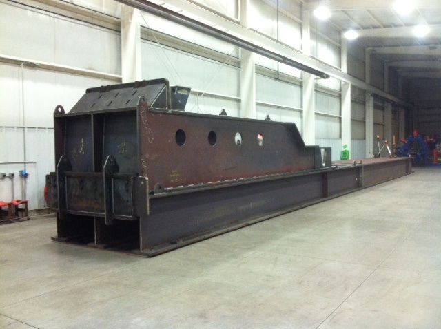

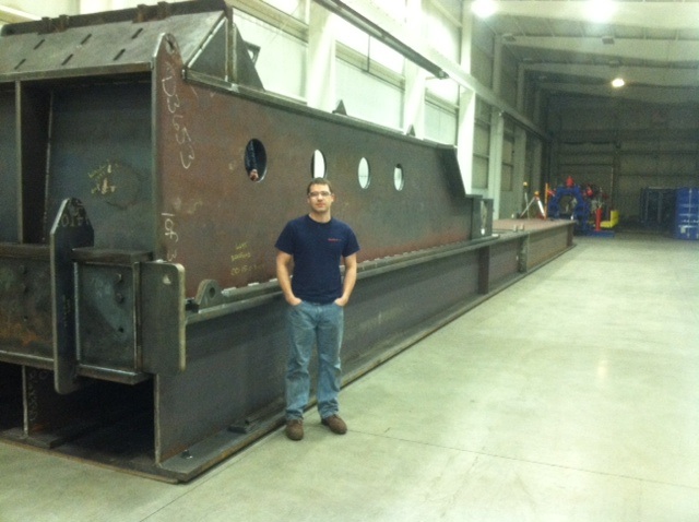

It has been a while again since I have posted here. We have been working on this testing frame for the past few months to test the capacities of the machine I posted pics of on pages 7 and 8 of this thread. Basically the Pipe Inserter will sit on top of this frame structure and push 30" seamless pipe against 4 hydraulic cylinders to measure the force it can produce. We claim to be able to hit 1.2 million pounds of thrust in both the push and pull of the Pipe Inserter. This will verify our claim as well as having a independent testing company fly in for the test.
The I beams are W36x330 and all plate material is A500. It has actually been a fun project but we are all ready to see the test. Now we have to disassemble the Inserter and reassemble it on the frame. It will be a couple months before the actual test and I will try to get pics up of the whole thing assembled.

That's a fantastic looking doohickie.. To the point, I hope you have cleaned your shop, or that is a special part of it, because I never saw any shop that clean, not even new ones.
For the uninitiated, that spec, "W36x330", means that friggin' beam is 36" tall, and weighs 330 pounds for each foot of length.
Serious meat.
(And the "W" means the thickness of the flanges tapers from the web to the edge, with the top surface square to the web.)
Serious meat.
