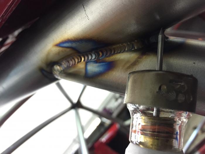

Welded some more on roll cage. Lots of people wanting work done. Thanks John.

Looking good!

Thank you!
How do you like those glasses?
Hollywood1
    Mon Feb 23, 2015 9:05 am
    Washington
good for tight areas
Is the sensitivity and shade adjustable?
Hollywood1
    Washington
yes

Hollywood1 wrote:Welded some more on roll cage. Lots of people wanting work done. Thanks John.
Are those the Miller or Sevore glasses? Probably one and the same thing :lol:
Yep... Miller bought the marketing rights to the Servore goggles about a year ago.

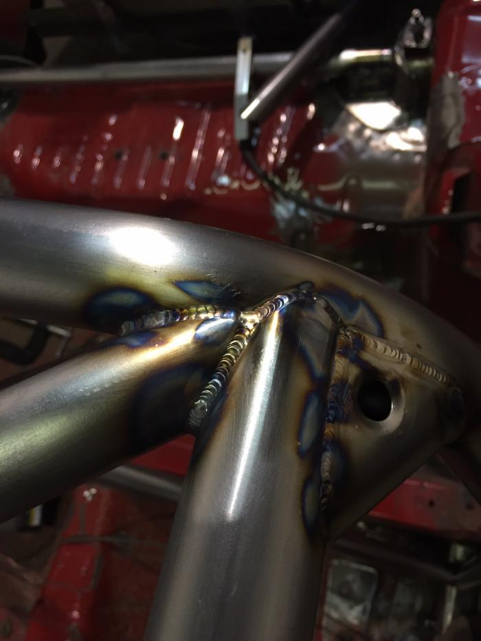

My latest roll cage. So much time goes into fitting each and every piece. I will say, proper fitment ensures the best weld (still working on that part haha). I apologize for the sideways pictures. I guess they are like that if I take a picture with my phone tilted... Even though they are the right way on my phone

Looks good. Is this Mustang going to be a drift car? I've never seen curved top bars like that before.

Yes this car will be a drift car. I build most of my drift cages like FIA cages though. I don't think FD cages are sturdy enough.

AFR_Autoworks wrote:Yes this car will be a drift car. I build most of my drift cages like FIA cages though. I don't think FD cages are sturdy enough.
If it passes FIA it should pass anything ;)
I would assume you have a radius bender as well as a traditional bender?

looks good!

Yes I have a tubing roller along with a normal tubing bender. This is my first cage using the roller this much. It certainly adds allot to the style of the cage and is really nice for roof bars in cages. It was not cheap but certainly a worth while investment.
Hollywood1 wrote:looks good!
Thanks!
