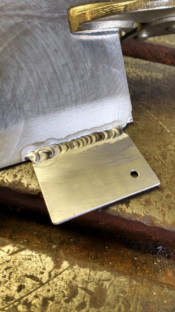

To me it's cool when you have the ability to make the thing you need instead of buying it.nelson wrote: I'll try to get something cool someday.
I welded some tabs on a piece of sheet metal to make a shroud for a window mount a/c unit. How's that for boring?

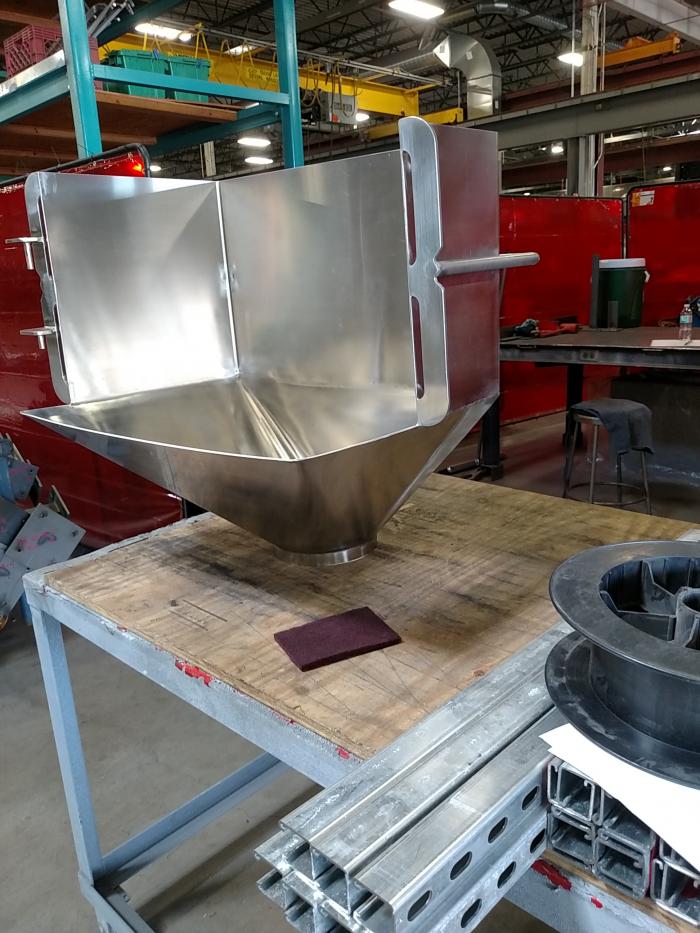

Working on a conveyor the last several days. I'm still an apprentice, but I guess I'm moving up? Three months ago I was working on the laser, fetching material and putting shop stickers on parts.

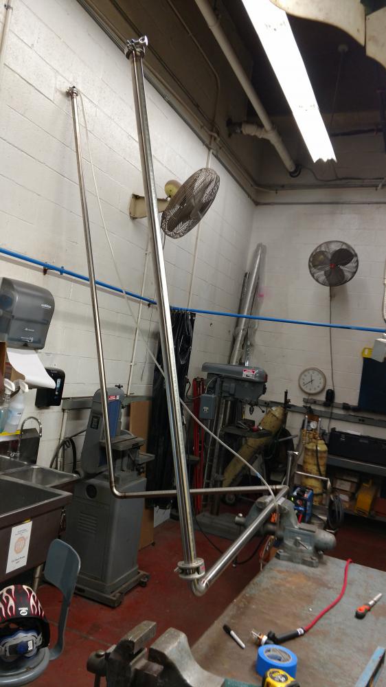

It was getting late and I didn't want to fill out all the paperwork to weld in an explosion proof environment not counting dragging all my safety gear. So I measured it all up and fabbed it all up in my small office/satellite shop in the a/c (damn it's been hot).
Fun times as you can see..lol

You need a longer and higher shop
Nice work as always.
Did you get it out after you built it?

Yeah it made it out..lol Ceiling in that room is 18', and it has a/c....lol Main shop was hot as hell..heheex framie wrote:You need a longer and higher shop![]()

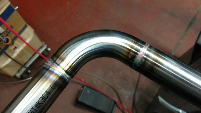

Hey Rick, question...I know you don't use filler when you do sanitary welds but I notice that from not using filler, the weld is a bit sunken in. Do you grind and polish that out? I remember a post you made awhile back about a belt sanding attachment for a grinder that helps you polish your welds.Whats the actual procedure? Also, did you ever get any of that flux cored SS rod that Coldman showed us?Rick_H wrote:Yeah it made it out..lol Ceiling in that room is 18', and it has a/c....lol Main shop was hot as hell..heheex framie wrote:You need a longer and higher shop![]()

The welds are basically flat, I use a belt attachment on my Metabo burnishing machine with a scotch brute belt....polishes out nice and pursue.exnailpounder wrote:Hey Rick, question...I know you don't use filler when you do sanitary welds but I notice that from not using filler, the weld is a bit sunken in. Do you grind and polish that out? I remember a post you made awhile back about a belt sanding attachment for a grinder that helps you polish your welds.Whats the actual procedure? Also, did you ever get any of that flux cored SS rod that Coldman showed us?Rick_H wrote:Yeah it made it out..lol Ceiling in that room is 18', and it has a/c....lol Main shop was hot as hell..heheex framie wrote:You need a longer and higher shop![]()

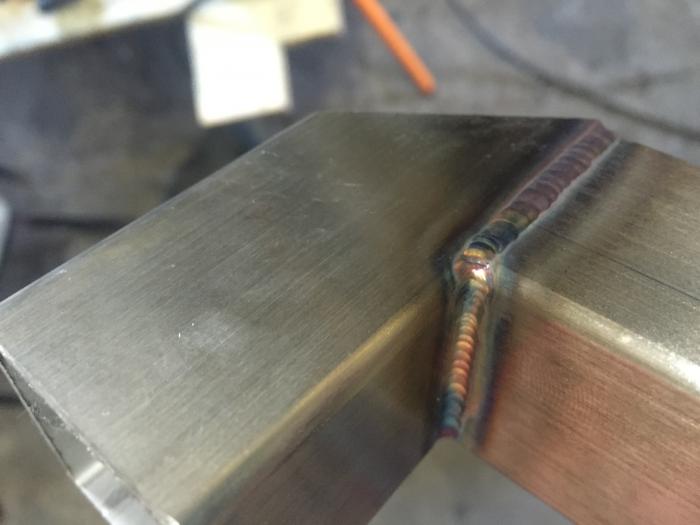

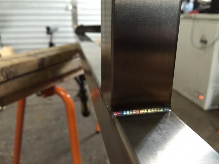

Hey Rick,
While we are on the topic, how many amps are you running on the pipe, and what is your gas flow on the purge?
Do you use a foot pedal or just a switch?
I started using a foot pedal, and was getting used to it, but had a frame job recently and didn't want to drag the pedal around so went back to torch switch. Seemed to weld better with the switch so thinking I ditch it for SS jobs....I'll throw up some pictures while I'm at it.

Nice stuff! In those pics I'm running 60amps, 2.5pps, 50% on, 50% background (my Master 150sth doesnt allow me to change), back purge on first joints 15cfh, then I'm down to 5cfh by last joint, 25cfh with CK jumbo gas saver, 1/16" tung. When I don't pulse I run 45-50amps. I run a wireless foot pedal and most times I throw it into 2T so it just acts a on and off with a downslope to prevent craters...or I just slowly taper off.nortical wrote:Hey Rick,
Your frame looks good, with round corner tubing I typically put the heat slightly towards the round corner and dab across to grab the other edge, my .100" shown above I ran 85amps, 3/32" tung #8 Superior cup.

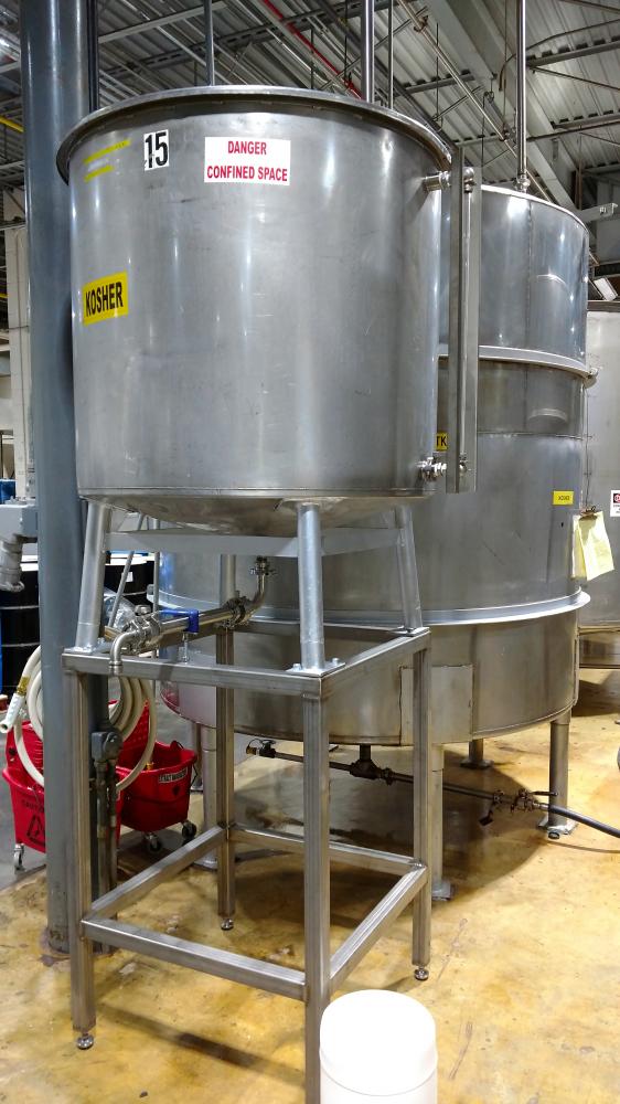

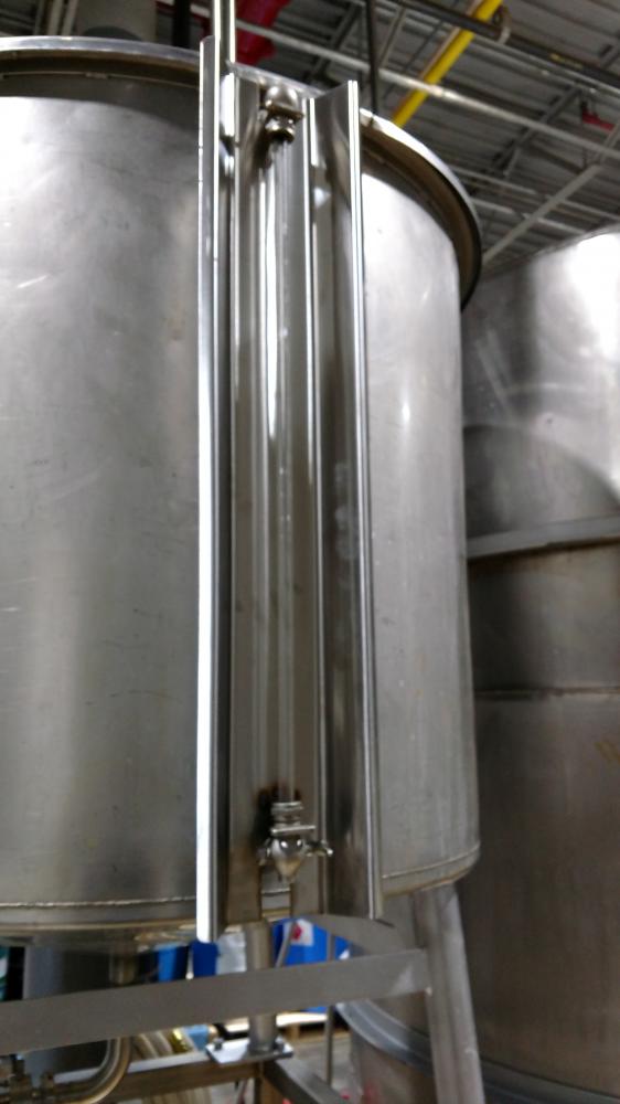

New process piping ran from the tank to the existing manifold, sight glass guard fabbed...all ready.

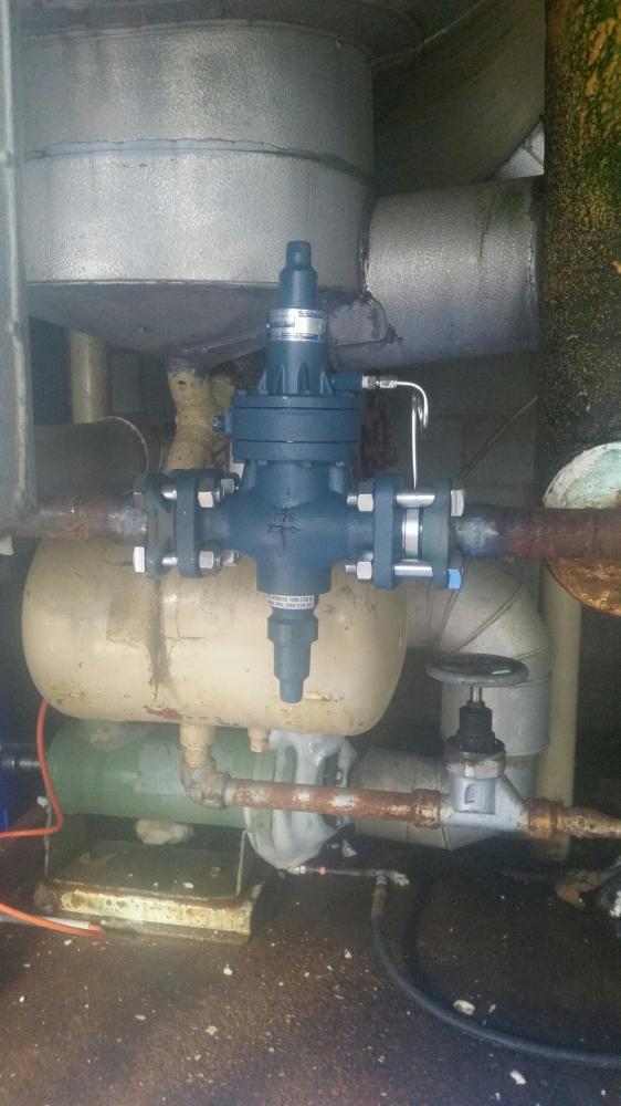

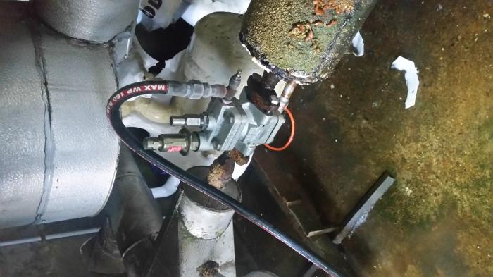

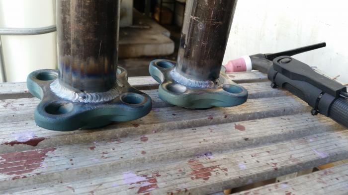

Had to chop out this inappropriate and under sized (1") ammonia pump bypass regulator and weld in a proper 1-1/2" regulator. Advised of sizing in advance so I welded some stubs onto flanges to save shutdown time.
When I got to the job I found the 1-1/2" pipe was actually an 1-1/2" x 1-1/4" reducer on both sides that were originally stick welded which meant I had to cut the reducers back to fully remove the stick welds. The reducers were now on the slope which meant alignment clamping became exciting. The left hand weld was frustrated by the proximity of vessels and pipes which tested my skills. Half way through the root I lost gas and crapped the weld. Took my helmet off to find an electrician spectator standing on my hose. After a brief discussion with the bolt neck concerning his family heritage he moved on. Ground out the joint and started again. Right hand joint was uneventful. Yay.

Every weld associated with this accumulator looked like crap. Done by a butcher. Couldn't take the risk of welding on inclusions and porosity. The welding position was hard enough without welding over someone else's crap. Just look at what he did: 1-1'4" pipe, welded on an 1-1/2" reducer, then another reducer to take it down to 1" and then put the wrong valve in. That bloke was a slice short of a sandwich.
Seen some crazy stuff like that before. Random stuff thrown togeather to try to make something work. When in reality it never worked right and now you get to do it over. Set aside all the saftey issues of working with pumped liquid ammonia.
Looks good! I was showing my son how to tig and he moved in to look and stood on the hose. Felt pretty foolish toasting a tungsten with him looking while I'm bragging about how good I am
