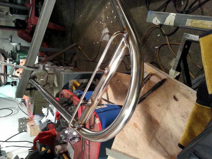

Before final fit up and I thought I was finished LOL
This is a project that I spent all last winter and spring on. If I only had the boat in the back yard. This was my first go at 316 stainless. That stuff is alive when you heat it up. I'm just a backyard hack and every louse thing I touch is a learning experience. I think I got it and the next project will go easier.

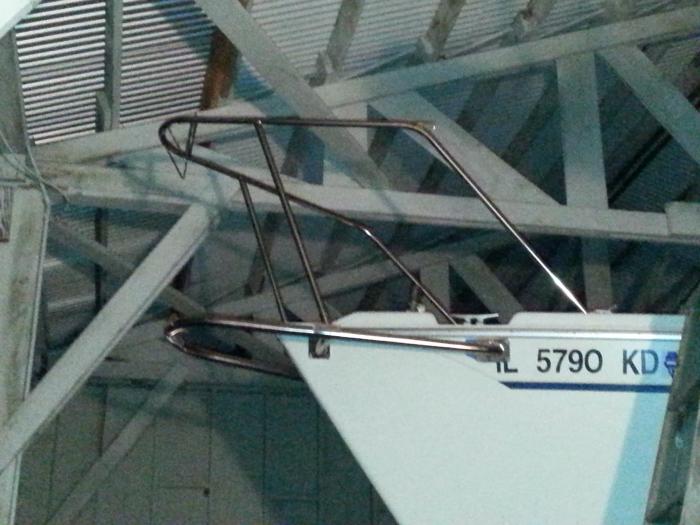

Bow Pulpit
Bow Pulpit
Before I killed it
Before I killed it

Gotta say that looks pretty sweet to me Dave - well done!

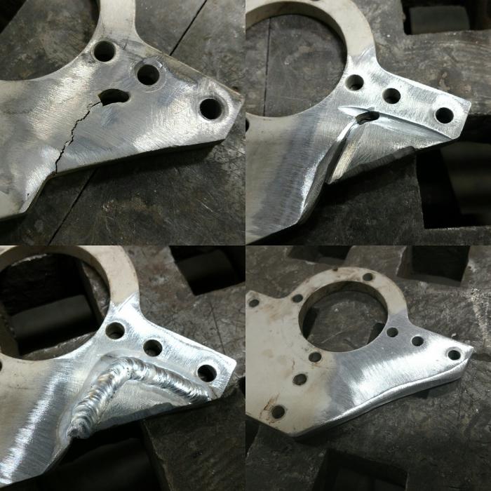

Little alum machine part repair...
It was nice to weld something other then stainless...lol even if it was some dirty, coated aluminum.

Nice job Rick.
How thick, and how many amps? Looks fairly meaty.

rick
did you have to do any welding on the back side?

It's 5/16" plate, I grooved out both sides...once I welded the front I grooved down until I hit my weld, then welded the other side up...she's solid now.
Not sure on amps, I had machine set to 250 and was using the pedal, when it puddled I dabbled 3/32" filler

rick
figured as much but had to ask,,,,,
i know you are a master at repairs
and was curious if you had a trick
or reason for maybe only welding
one side...

Your too kind far from a master but I can get stuff done.
Probably could have gotten away with just once side, but figured what the hell..lol The part never had a gusset and we use to snap the 3/4" wide legs off about every 3 months. I welded the original gusset about 4 years ago, and we haven't broken an arm since. They mangled the one that was on there so I finally repaired this spare to replace the assembly, hope it lasts another 4 years.

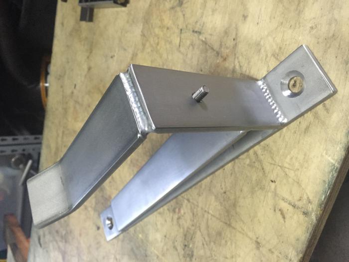

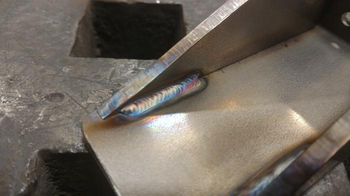

Couple of brackets for some fence infills gate and auto sliding gate I'm doing at the moment. All stainless steel!
On the phone at the moment so just rotate your head for the last one!

Surprise stainless...lol

Beautiful work as usual.

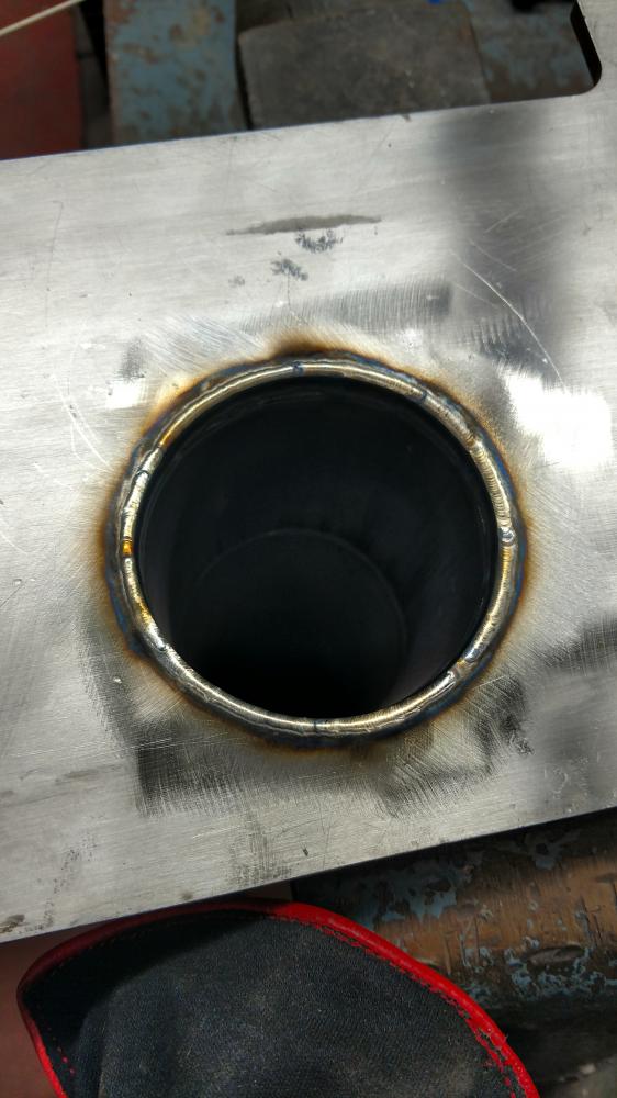

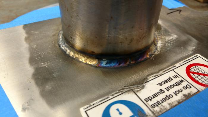

Here's some 303 (un weldable stainless, used 309l wire)

Pretty welds there Rick. Looks like it behaved itself for you too. Never welded 303...any different from 304 or 316? Why the hell does your plant have that laying around anyway? Do you guys machine parts there?
Rick_H wrote: Here's some 303 (un weldable stainless, used 309l wire)

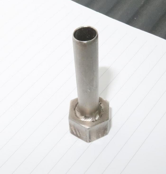

Rick, could have fooled me, looks like 304, I typically use 312 filler for 303. Below is an experiment I did some years back, the tube is 304 and the hex is 303, don't remember the filler but you can see the exaggerated undercut on the 303, it's as if the filler is trying to get away from the 303.

Yes we do machine parts here as well, put we had one of our MRO suppliers that brought in 303 instead of 304 by mistake, so we have a few pieces of it in flat bar left around.
Rich-This actually behaved much better then it has in the past. It is not as bright as the 304 we typically stock, I've had it wear it barely welds at all...pisses you off a good bit. I was always told 309L with 303 to another metal...yeah that is pretty bad for sure, it does look like it doesn't want to mesh.

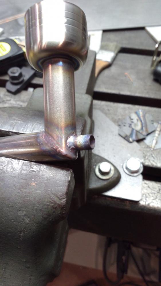

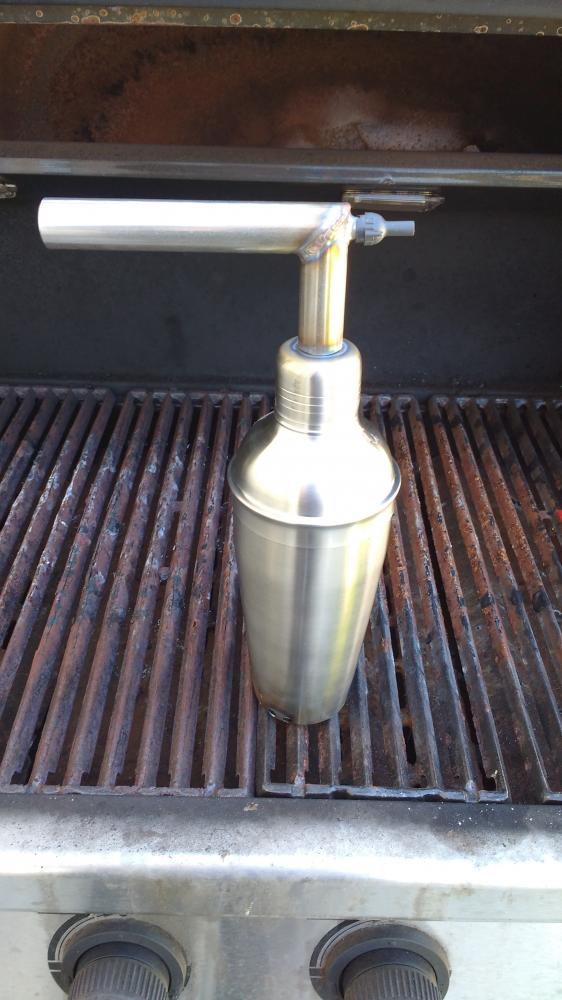

Made a little cold smoke generator from the idea on home brew forum http://www.homebrewtalk.com/showthread.php?t=320916

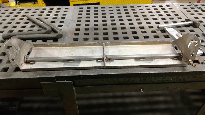

Just a repair on a shelf they toss some bags and small drums of ingredients on before mixing/blending. The shelves only have one small piece of flat bar underneath and they keep flexing and breaking. So I decided to add some 1" x 1" square tube across the shelf to add some rigidity to it....works perfect. Also allowed me to straighten the shelves out.
