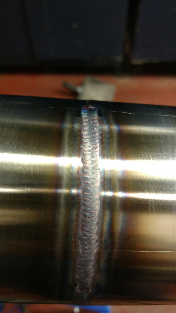

Little cup walking 316L stainless sanitary
Here's a link to the video on my IG account
https://www.instagram.com/p/BKzRxOhDVX2/
Rick_H wrote:Little cup walking 316L stainless sanitary
Nice weld, interesting in that I haven't seen someone walking the cup towards themselves like that, also your angle looked steep, not being critical and it obviously works for you! Is that butted with one pass?

Are you picking on me :mrgreen: I have found if I don't stay steep angle on the polished sanitary tube it slips a lot easier on me and I feel it gives me a better more consistent penetration. I cut the video down, the first part where I start at 6 oclock and work my way up, then while walking the cup I reposition my body to the other side of the pipe (which you see in video). If I'm doing something with a gap I have more stick out and a lot more angle, also gives me room to get filler in. I use to just do straight pulls ad while it polished out fine I felt like I was putting too much heat into the stainless so I figured I could drop back the amps a little and walk the cup...always trying something a little different, no pulse either. The 1.50" .065" wall stuff I can pulse do a straight pull and weld with my foot if I needed to and know that it is good. The 4" pipe steps up to .083" wall which has given me problems with penetration at the speed I like to weld, I cant crank the heat up anymore or Ill have other issues. I hate cutting joints out and ruining fittings.
Yes that is butted, backpurged full pen, 1 pass.
Rick_H wrote: Are you picking on me :mrgreen: I have found if I don't stay steep angle on the polished sanitary tube it slips a lot easier on me and I feel it gives me a better more consistent penetration. I hate cutting joints out and ruining fittings.
That makes sense, I'm all for whatever works and I know that the surface finish on the sanitary tubing is very smooth compared to pipe.
Thanks for the video, as someone who doesn't do that kind of work very often I like to see others technique

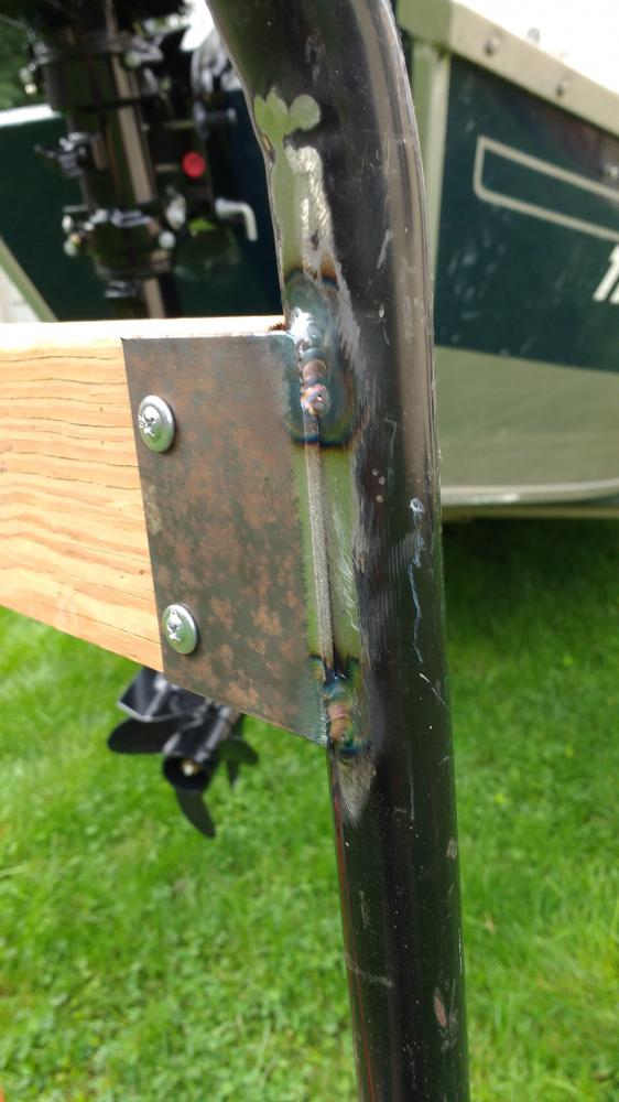

Some fishing projects. Some tabs onto an old hand truck to make an outboard cart.
Also modified a Dierks center mount anchor davit into a side mount. Required cutting down nearly 20 year old alum casting and welding it to angle iron.

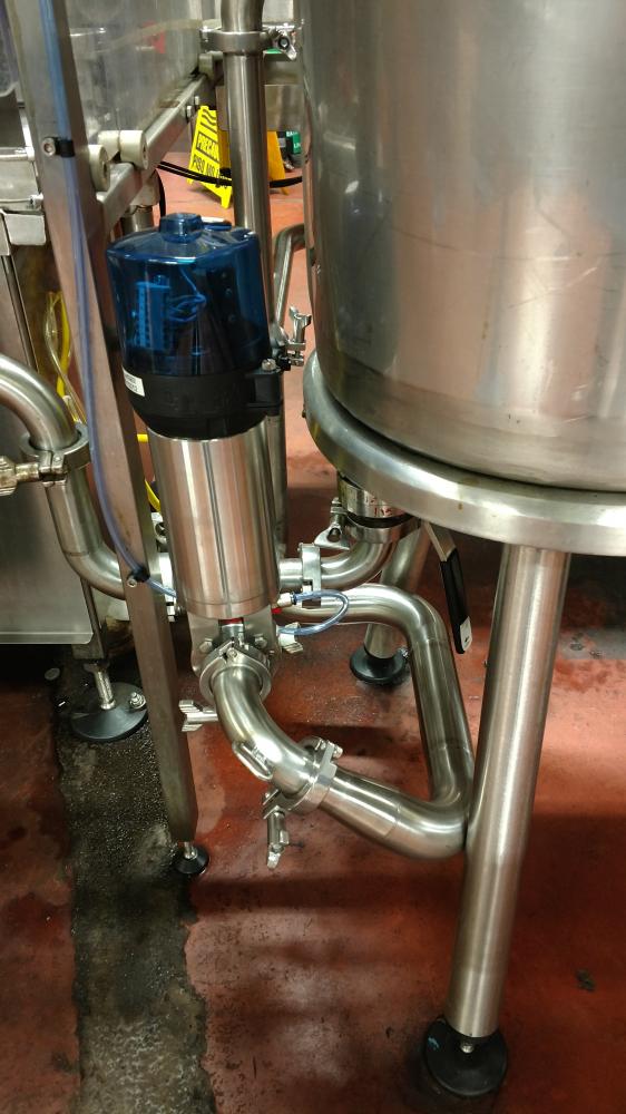

Adding some spinners to our two main production bioreactors.

Thanks Rick. Here they are all mounted up to the spray arms. I need to pick up one of those nice big 12+ cups one day.
What settings do you use for .083 wall tubing? I'm still pretty new (< 1 year) and most of our tubing is under 2". The couple large diameter pieces I've done I've welded them on the inside as well but would like to one pass this 6" solid waste line I have on my table.

ScottFc3s wrote: What settings do you use for .083 wall tubing? I'm still pretty new (< 1 year) and most of our tubing is under 2". The couple large diameter pieces I've done I've welded them on the inside as well but would like to one pass this 6" solid waste line I have on my table.
The big cups do help with gas coverage, I use the CK gasaver on my sanitary stuff, 316L, full pen, backpurge, 1/16" tung (if I pulse 2.5pps, 50% peak/50%background 55amps), not pulsing straight pulls 45amps.
The .083" can be tricky to get all the way through, I am still perfecting my settings but right now the stuff I weld in that wall is 4" diameter, I do same full pen, backpurge, 1/16" tung 45-50amps walking the cup, I get through on straight pulls at 50amps as well but have to really watch my speed, I like to move a little fast. I'm getting ready to start setting up some in a few mins, and have to do a qualifying piece Ill post stuff later ;)

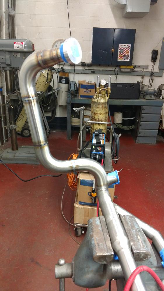

.065" wall, 1.50" repair from yesterday...sometimes you just have to make stuff fit existing frame work and piping.
ScottFc3s
    Thu Jul 09, 2015 8:31 pm
Nice piping Rick, modifying existing is always a gamble. Sometimes it works out nice, sometimes you gotta scoot some equipment and sometimes it just ends up a maze. :lol:
