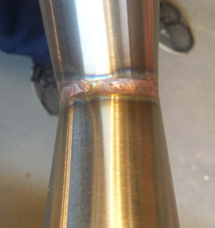

i probably just used our own homemade filler at work... we just take a sheet of SS and feed it through the shear in automatic mode, trying to move it only a 1/16th of an inch at a time, to make filler rods. I probably used something smaller than I could even handle to try that fillet on the 26gauge... I can never feed the small filler quick enough, I definitely don't have the skills. Whatever I used, it would just blow through... i'd have it for about a half inch and then daylight...LtBadd wrote:What dia filler did you try? That thin material can be done with .030" but you have to be tight and quickraticus wrote:
and if only I could get the camera to focus on this corner weld of very thin 26gauge SS... managed some fusion fillets too but filler fillets just wasn't happenin'

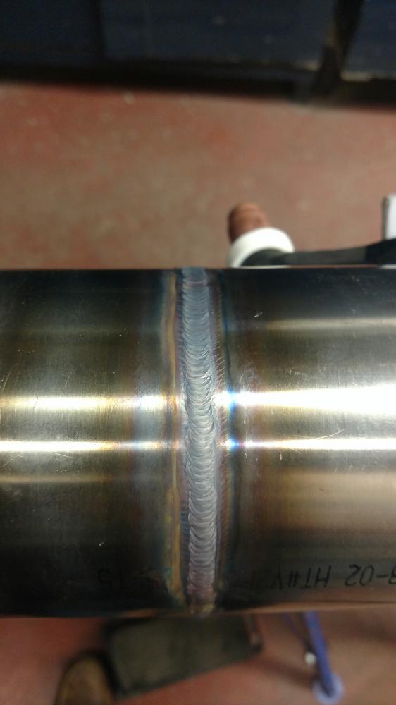

4" 316L sanitary

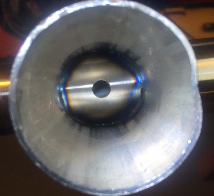

Finally got set up to do back purging. The results amazed me. Even though it looks like I need more flow on the purging the sugaring disappeared. The joint welded easer, flowed better and much cooler. I have a hard time getting any color but grey on my stainless welds so the color on this weld is great for me. I think since it flowed better I used less amperage but, using the peddle I can't really tell.
1 7/8 stainless tube with .045 wall
# 6 gas lens
.040 2% lanthanated
2 sfh torch
5cfh back purge
60 amp max with peddle
# 6 gas lens
.040 2% lanthanated
2 sfh torch
5cfh back purge

That's good color! If you have pulse try it, it really makes a difference but takes a little getting used to. The faster you pulse the easier it is to get used to...at least thats been my experience. If you want to try something weird...try welding at 10 pps and see if you like it
