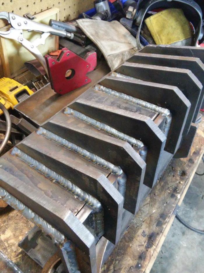

some things i made for my shop and some stuff i have made for some customers the past 2 weeks.

You do beautiful work

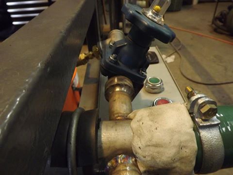

I haven't posted a weld in a while, and this topic is getting buried, so here goes.
It's a socket weld (rare for me these days) done in the position you see it with all the crap in the way. 309 rod, as it's 3/4" stainless pipe to a mild steel valve.

Nice socket weld! You used the gap-o-let right? That weldment doesn't look like it needs any mistakes. I wish I could do your job :cry: I had to weld a goddamned sink in a bar today...I hated it :evil: :lol:

Gap-o-let? I just cut the threads off the pipe section you see (Originally a threaded nipple. I was expecting Rego valves, with FNPT both ends). I then loosely fit these ITT valves (this has a mate exactly opposite) for the standard 1/16" minimum pull-back for a socket weld, used my electrician's level to set the valves at 30*, and a quick tack on top. Squared them up with my TLAR (That Looks About Right), and welded them out.
If it looks straight and level then nobody is going to check and see if it actually is.
