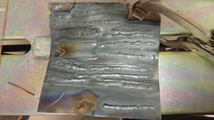

So lessons learned today: (75 and 80 Amp max aluminum with feathering and no feathering of the pedal with every weld having some degree of max press)
-Turn off that fan you have by the door to cool your work area down in AZ before you begin TIGin!
-I can't say for anything on my welds today because of this but the two beads I ran after I can't say weren't much better. I think today was a stale mate in the learning curve but it has to happen!
-Changing drastic sizes in metal thickness can hinder your learning process, or perhaps speed it up. TBD!
-A pretty clean piece of sheet metal is not a clean piece of metal. You must get ALL mill scale off or steel looks even worse.
-Running without gas seems to give you laser beam precision on DC and instant burn through on 16g metal not to mention instant rust. (2 attempts till I realized it) No gas on AC gives you radiation burns for aluminum (previous days).
-Heat absorption seems higher with steel (obviously) but the beads don't seem to care as much and the puddle seems more controllable than AC/aluminum. The puddle still seems to grow exceptionally if you travel more than a few inches as with aluminum unless you figure out how to drop the heat as you continue. I still gotta figure that one out.... The problem is the heat absorption with steel seems so much that if you're traveling more than a few inches, you better have some very insulated gloves and even that can be worse than probably thin gloves due to heat retention. I saw all sorts of smoke rising off my gloves and there's a bit of burn to show for it.
Questions:
-Truly random but does the rotation of Earth and the hemispheres have anything to do with the twist you put when you grind your tungsten? Obviously flushing a toilet affects water drastically so could this be a relative factor for the twist of the tungsten when grinding? Hopefully a fair question....
-Is feathering the pedal not so important with steel? The only guess is maybe it helps with heat but I'm not enjoying steel as much as I enjoyed aluminum with TIG. I didn't mind steel at all beyond just figuring things out with stick n steel but I'm feeling steel n TIG is my weakest point thus far compared against aluminum and TIG and steel with stick.
The thicker steel with TIG at least laid out pretty nice and way better that I've ever done with stick but that 16g sheet just didn't work out so well. Blowing fan was there too so maybe a moot point but ehhhhhhhh.
-Is the excess heat on the 16g steel sheet indicative of me needing to add more Amps and faster travel speed? The blue halos I think are telling me I should but I don't know....?
Jody's TIG finger has been very helpful albeit I've used it about 1/3 of all my welds. It did fail me when I had to run it against the edge of my piece since the piece was not smooth so the grains of the fibers caught and stuck me. I'll have to work around that one...
-Undercut seems most apparent with the heavy Amp/heat welds. Add warpage to it, and I think I'm undeniable pushin too much for this 16g steel right?

So for pix... This is my very first weld table I built with scrap and stickin. It stands about 2 inches high :) These were my very first joins I made with my Lincoln and I'm pretty sure 6013 rod. Arguably the the penetration looks more controlled with stick than TIG.
What you can see here though is everything between the soap stone lines is TIG runs. Definitely nowhere near as decent as my thick steel practice. Can't really pick out a really decent bead either. I'm willing to at least bet that if I tried to join metal it would happen since I have but the quality of the join would likely fail any inspection.
So yep, there ya have it, day 4 in the n00b TIG day.
BTW It's worth saying this table was reasonably flat before I TIG'd it.... Mucho warpage! But nothing a skilled hammer can't fix ;)

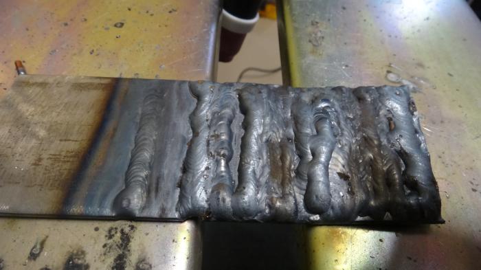

I'm not really seeing any progress.
Stop going at this like an ADD monkey on crack.
Sit down with a large plate of 1/8" about 8" square or up to 12" square.
Fill the entire thing with beads where the next bead half overlaps the previous and develop your muscle memory and consistency.
When done you should have a nearly flat surface with all the beads the same height and very little valleys in between.
This is called padding beads.
Dunk in water every couple beads.
Use at least 125 amps - only feather the pedal right at the end of a bead and "button off."

Mr. Dave! You're on point about the ADD Monkey on Crack. It's a slightly natural issue/tenacity. I'm also very verbose at 80-120WPM without caffeine. A drop of that stuff is balls to the walls for me so I truly apologize for jumpin across the forum the other day trying to be "Mr. Helpful".
The crack monkey showed in my welds too but really that was attempt #3 at steel. I've kept my focus on aluminum since that's all I really care about. It was horrible and it was my first time at such a light gauge in comparison with TIG. I agree with you though it was a step back if anything. I had a lot of sticking issues with my torch, glove, etc. and honestly all the dumb things including the operator were going wrong. The fan had nothing to do with it either.

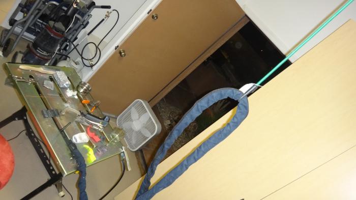

So to seek repentance from the Mongers, I post this! I'm going to try to keep this thread as a track record of a 100% first time n00b TIG'er and also help me look back later on to see where I've gone which hopefully helps someone else in the future too.
Here is day #3 of steel after most practice focused on Aluminum. I chose 1/8 steel with 120 Amps DC and a 22 Ohm foot pedal. 15 CFH for Argon at about .5 to .75 pre-flow and about 8 seconds post flow. I'm on 2T with no slope, and I've got a fairly blunt, but sharp tungsten grind I keep fairly consistent and will re-grind if I dipped or if it looks abnormal.
The pix are attached and between the first two photos (since attaching posts them in reverse history order) I took this video to give an idea as to how the TIG Monster Claws are working out for me and also to show what I'm doing as is which includes travel speed.

2nd view of bunjee cord to cable to reduce weight of torch
Installed the hook in the roof and now that #18 water cooled torch has almost no weight!

:lol: ADD monkey on crack...now that was funny :lol: Looking better towards the last pic but your beads look greyed out and burned. Too little amps is worse than too many as you heat up the base metal waiting for a puddle to form. I'll try to post a pic later today but you should have nice, shiny silver beads and even some color to them but you don't because you are cooking your metal. One suggestion; when you follow the rule of 1 amp per thousandth, add about 10 more amps so you have a little extra power. 120 amps is borderline for 1/8" steel but having those extra amps will let you floor the pedal and get a puddle started immediately. Try not to weld with the pedal all the way to the floor which 120 amps is likely gonna make you do. It speeds up pedal control...at least it did for me.
You stated that you just want to really weld aluminum. Do yourself a favor and stay with steel for awhile and learn pedal control because you are gonna need it when you move over to aluminum. I have a buddy that is a boilermaker and welds every day but not aluminum. He came over one day and asked to try aluminum on my machine. He was like a new born baby. All of his experience didn't help him that day but after an hour or 2 he was doing fine. Point is, get the basics down and your transition to a metal with different properties and characteristics won't be such a challenge.
Come on man....you're wrecking our winning streak here...With all the good welders offering advice around here, we usually have noobs making good welds in a couple of days. All it takes is proper technique and practice. Keep the pics coming.

Ha, no worries. I won't feel bad if I'm not the fastest especially when I've been trying different things like focusing on alumimum or learning pulsing the pedal on steel is a waste of time. I gave up the pulse this time and will keep that for AC stuff.
The first three did come out kinda shiny though right? Now I've been dipping this plate in water ever 2-3 beads. It didn't look bad to me until I dunked it then it looked like crap and kinda looked worse every dunk. Would that be the cause of the continuous grey/burnt color?
Attached is another pic that was more midway through my runs. Also I disabled the camera flash on the other pics to give a more natural color, not the over exposed white you usually get with a flash kinda like with this pic.
Should I be able to stack the shit outta some beads on a single plate and have them all look shiny? How do you do that without the water, just wait like 5 minutes till the plate reads around 100 degrees on a thermometer then run a new one?
When posting a pic for learning, should I keep the flash on and run just a few beads, or should I do whatever suggestion comes up about stacking since the water and lack of flash "enhances" the cooked appearance?
Is it the extra Amps, say like 160, that will be my ticket to these coupons and becoming a scholar?
P.S. Only frustrated with myself, and even though I didn't want to move to steel yet as you all suggested, I'm trusting you all and doing it anyways :)

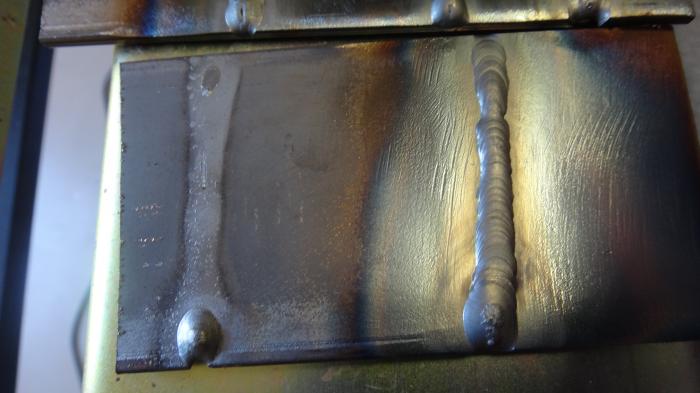

Thanks Dave! That makes me feel a little better. Still very frustrated though :D I know with each time I hit the pieces using the wire wheel brush it looks pretty nice and shiny but without it no matter what I do the beads are always dull. If I clean up one, the 2nd pass will leave the first pass a dull grey again.
I've watched Jody's steel drill video several times in the last 24 hours and I see he's got beautiful shiny beads but even the first bead after his 2nd pass at (time queue 4:40 of video https://www.youtube.com/watch?v=uzIF0H02fBw) is all shiny pretty. I can see what looks like graining but I thought it was video quality but now I'm thinking this is post clean up too with some wire tool or am I just that bad?
So my sanity question is "even with a single bead without dunkin the piece should I see shiny immediately when I'm liftin the hood, the part isn't glowing red, and before I ever attempt any type of clean up?"
As for these two pix, this is examples doing no more than 2 beads very separated with about 60 seconds cooling time between each bead and zero dunking for all pieces. I labeled them 140 and 160 for the Amps I used. You can tell I start out with almost full pedal and transition to full pedal on most of them. I'm also only running right vs. my other pix where I was running both ways. I've got the most practice running the torch in my right hand (I'm a lefty) hence why I did this for these pix.
I can go faster than the 140 but 160 was max speed if not too much. Still, no shiny unless I wire brush it...

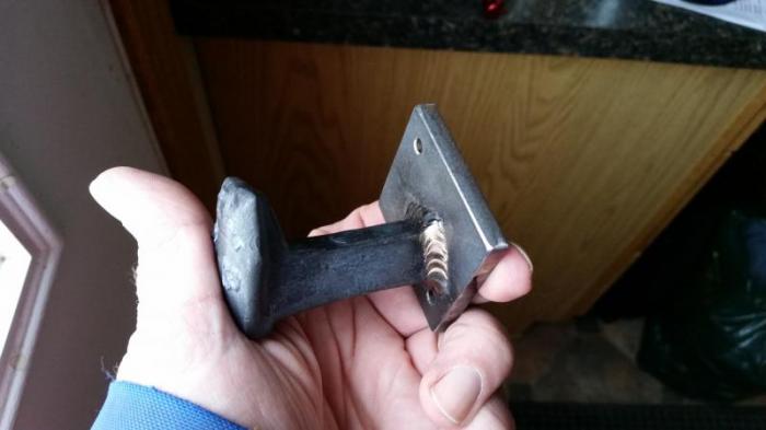

This was the best pic I could get with my crappy phone. The flash washes out the shine except if you look at the piece of tube I put a short filet on. You can also see a little color in there too. The stringer I ran was shiny but the pic flash washes it out.

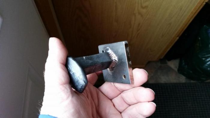

My parameters were. 2" x11ga. DOM tube welded to 3/16" plate. 190 amps, 3/32" 2% lanthanated tungsten. Gas lens, #8 cup, 15 cfh gas flow, and Er70S2 filler rod. I was on the pedal so I don't know how many amps I really used but you can see that it is possible to get shiny silver welds with the right settings. You can make a nice shiny weld and then make another bead next to it and it will get dull on you so don't be bummed out. For some reason, filets are usually always shiny with some color and I think that is because you have 2 pieces of metal absorbing and disappating heat instead of 1. Not enough amps is bad because you are soaking your base metal and the heat can't get away fast enough and you cook it. Stainless is 10 times worse so be aware of that. Aluminum disappates heat so fast that you need more amps to get it to puddle (or pre-heat it) so that is why pedal control and travel speed is so important. When you're welding on aluminum and you get to the end of the piece, you have to back off the pedal because the heat has nowhere to go and if you keep laying the amps to it, it will fall out.
You should be working on your dip-move cadence instead of making shiny beads. There are many steps to tigging and you are worrying about too much too soon. And stop switching hands. You need to get your brain wired to tig weld with your strong hand and THEN you switch hands. Just do small steps and then start putting those steps together and soon you will be running!

Ok...heres what I have been trying to show you...and it's a pretty one too :D You can see shine and even color and I did not clean any of my welds. This pic was taken as soon as I could get my hood off and turn the camera on.
Your question: I would go around 140 and pedal it. Over .125 thickness, the rule is more of a guideline. You will get the feel for it. Then you have to factor in if you are welding 2 different thickness' of metal. This pic is 11ga. to 3/16" plate so I was at about 150 amps but I can't see my readout when I'm welding so I just kinda watch the puddle and it tells me when I need to back down or goose it.
The point I am trying to drive in your head is watch your puddle and control your pedal and it will all come together. Heck, I know a guy that hardly ever adjust his amps...he just throws the piece on the table and feels his way through it.
