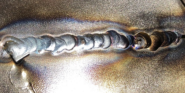

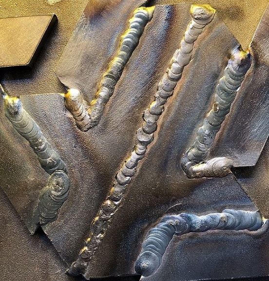

You might get some thinner ally to practice on. 1/4" will require all the amps your Dynasty can throw at it, and unless you're using a water cooled torch, your #17 will get very hot, very quickly. (I know you have the Coolmate, just warning you).Erik Mannie wrote: I have still never lit up on aluminum even though I have a Miller 210DX and a lot of clean 6061 1/4" thick, 1 1/2" wide bar ready to go. Your post motivated me to buy 2 pounds of 1/16" 4043 filler for my aluminum practice material.
1/8" material with 3/32" filler is probably the sweet spot for practice. I'd also practice just running some stringer beads on ally, and get comfortable with how the material soaks up the heat, before you dive into welding corners and other fitments. And a #8 cup is a very good, all-around cup size until you get into small, jammed up spots.
Your practice images above show improvement, but they all show too cold a weld and too much filler. Increasing the amps will help flatten out the profile, and reducing the amount of filler will help too. With steel, you can weld much thicker material more easily than ally. So grab some 3/32" filler, some 1/4"-3/8" steel, and weld until your hair grows back. You can quench periodically to help prevent your practice piece from getting nuclear hot too.

Thanks for all the great info. The only problem I had today was when I stopped getting any Argon at one point (after welding very happily for a few hours) even though the Argon tank was about 2/3 full (1400 psi).
I fixed it by (1) putting in a new gas collet body, collet and #8 nozzle, (2) freshly sharpened electrode, (3) new gas hose and a completely new Argon tank (2000 psi), (4) tightening everything from the Argon tank to the tip of the electrode, and (5) increasing the gas flow from 15 cfh to 25 cfh. I don't know what the problem was. We'll see how that old gas hose and Argon tank do when I put them back into service.
I didn't have an extra (long) back cap, but I ordered one for next time I am substituting in new parts. I definitely appreciate the shielding gas flow now! I was worried that something was wrong with my power supply. If I had to send it in for service, that would be a financial challenge for us.
I will upload a picture of today's welds, both before and after grinding with a wire wheel. I tried to use more heat and less 1/16" ER70S-2.

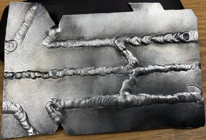

I am a complete novice myself, but today I got my 17 year old son on my TIG setup. This is a picture of his very first time welding. In the photo, he just turned off the Dynasty 210DX and the electrode is still glowing. He thought that welding was very fun (of course). He spent four hours under the hood. I spent the whole time bringing him clean 3/16" steel. He did autogenous welds for two hours and then two hours with 1/16" and 3/32" ER70S-2. I also uploaded a picture of his beginner's luck first bead with filler. During those four hours, he dipped the tungsten about a dozen times. When he was done, he went on his laptop and watched at least one of Jody's TIG videos.

I envy your fortune with your son. You may go broke buying Argon & paying the electrc bill, but it will be worth it.
Look at it this way, you'll probably make faster progress with you cutting and tossing him the parts to weld up.
That will give you more time to read machining and welding books too.

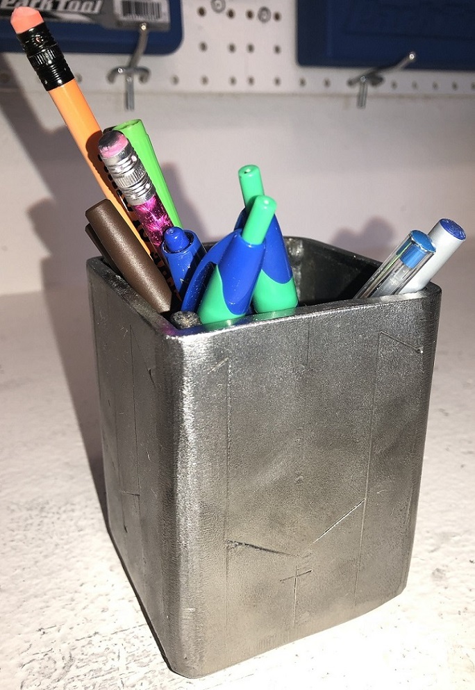

Here is the first thing we made. It is a pencil holder.

The pencil holder looks like it was made by a child. I didn't have a good plan.
