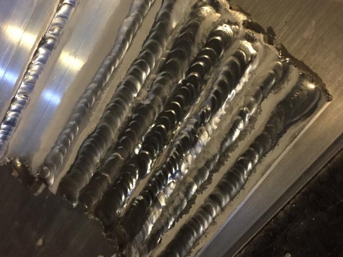

And a few minutes before the argon ran out... Or pretty much as it was running out...
Some dividends... Not getting cocky... Just happy to see something somewhat recognizable...
- IMG_E2908[1].JPG (34.45 KiB) Viewed 3281 times
- IMG_2909[1].JPG (52.99 KiB) Viewed 3281 times
There you go- lots of progress there.
As you move the torch, watch the oxide layer just get blown away and reveal the base aluminum. You should begin to see that, and then the surface wets, and you're off.
The same will be true as you introduce filler. Get a puddle, add filler, advance. Add filler, advance.
With filler, you have lot's more time to control your travel speed. The filler cools the puddle promptly.
Look at the end of each of your beads above. That "fisheye" or "crater" at the end- that is where you did not taper off the amps nearly enough. It's exaggerated now with no filler, but as you approach the end, really TAPER the heat, perhaps even circle as you do. That will help eliminate the crater.
The crater is a stress point that will crack later. Learn this habit now to avoid solving the problem later when it matters

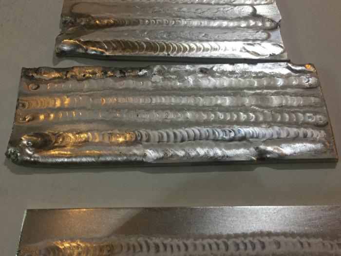

Practicing pulsing the pedal and adding filler. 1/8 aluminum - #6 stubby - 3/32 electrode - 1/16 filler - 140 amps.
They seem a little cold - but it's the first time I was able to do it without blowing away the metal on any of the parts.
I doubt I got much above mid-pedal for very long - but would pulse higher and then advance and feed rod when it got hotter... Still a vast improvement from a few days ago... Not very consistent - but I'll take it.

It looks to me that your arc length is too long. That can cause two issues: an excessive frost line outside the weld area, and cold welds. Some of the bead looks really good.
Overall you look just like a guy who's only been TIG welding for a few hours and is making progress everyday! A few more days, and it will all magically start coming together.

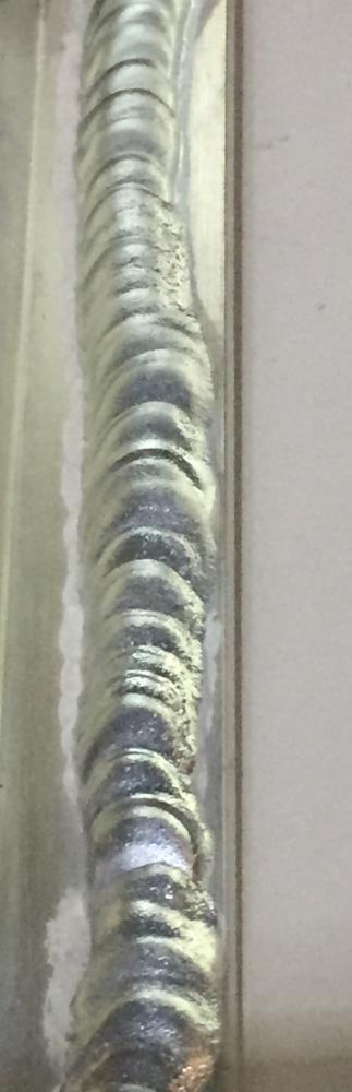

Finally about as dialed in as I can be on this 1/8 stock... Time to pad beads... One right after the other on top of a 1/4" chill plate. No blown out metal... Just learning to lay them down and control the pedal. I really appreciate you guys here... Couldn't have figured it out with out you.
Thanks!
Thanks!
- IMG_2920[1].JPG (53.79 KiB) Viewed 2957 times
The consistency of those last beads looks really good.
The frost line looks really wide on your beads. What Hz are you running? That is probably the biggest contributor to their width (etching). The lower the Hz, the wider the cleaning action, the deeper the penetration usually.
The machine is locked at 60Hz and only has "clearance effect" as a setting to balance cleaning vs penetration.
I have yet to really grow to understand it - but the negative side is supposed to be "more penetration - less cleaning" and the opposite when switched into the positive.
That is correct. I used to have one. At -5, that provides the most penetration/least cleaning, which in terms of Electrode Polarity, it is equivalent to 80% EN. At 0, it's 50% EN/50% EP, and at +5 it's 80% EP. So generally speaking, using the numbers from the knob, you want to be between -3 and -5. The more clockwise (numerically higher knob number) the more cleaning and heat into the tungsten and wider etching band. -5 is ideal if your metal is clean enough, so long as you don't see "black pepper" floating in the puddle.studioq wrote:The machine is locked at 60Hz and only has "clearance effect" as a setting to balance cleaning vs penetration.
