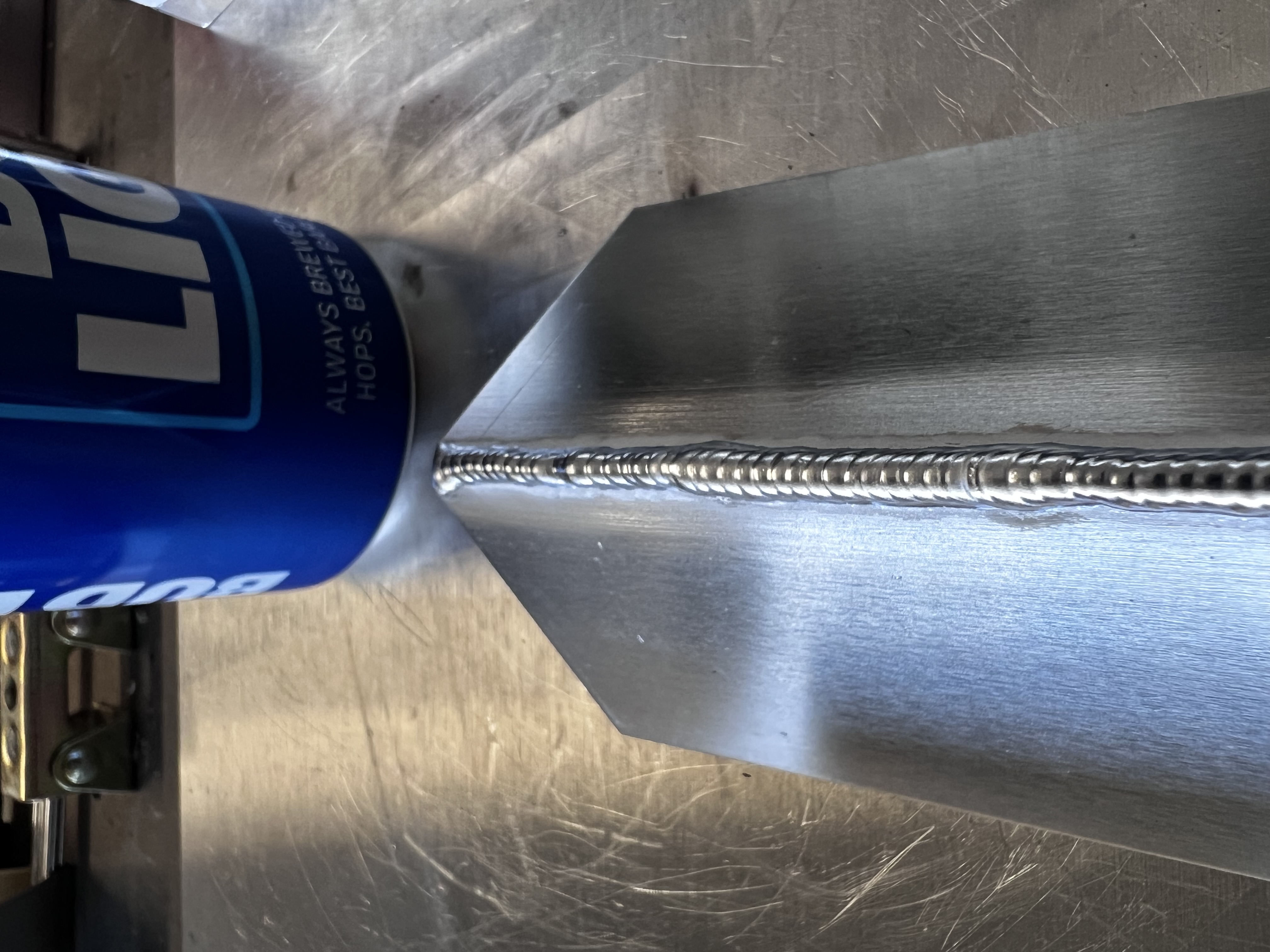

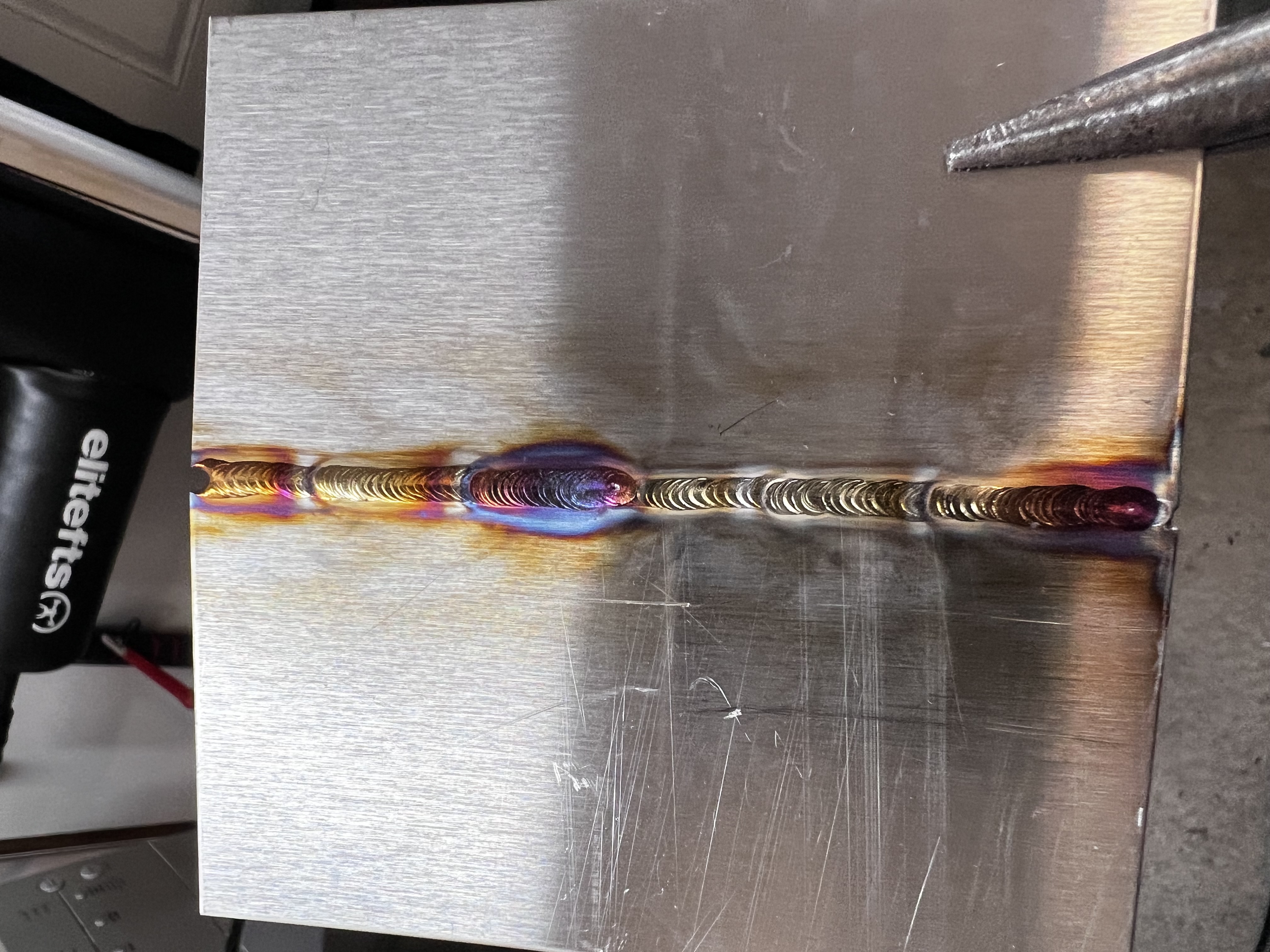

Forced myself to feed filler since the knuckles are getting a bit toasty with the aluminum. This is probably the longest bead I’ve ran thus far while continuously feeding filler material. Not the greatest looking, but I’m pretty happy because I can roll with it without getting distracted. Almost like learning how to drive a manual again.
I know it’s ugly as sin but I’ll keep practicing.
- 1/16” aluminum coupons, 1/16” lanthanated tungsten, 1/16” 4043 filler. 80 amps on the pedal, 120 hz, ~35% balance.

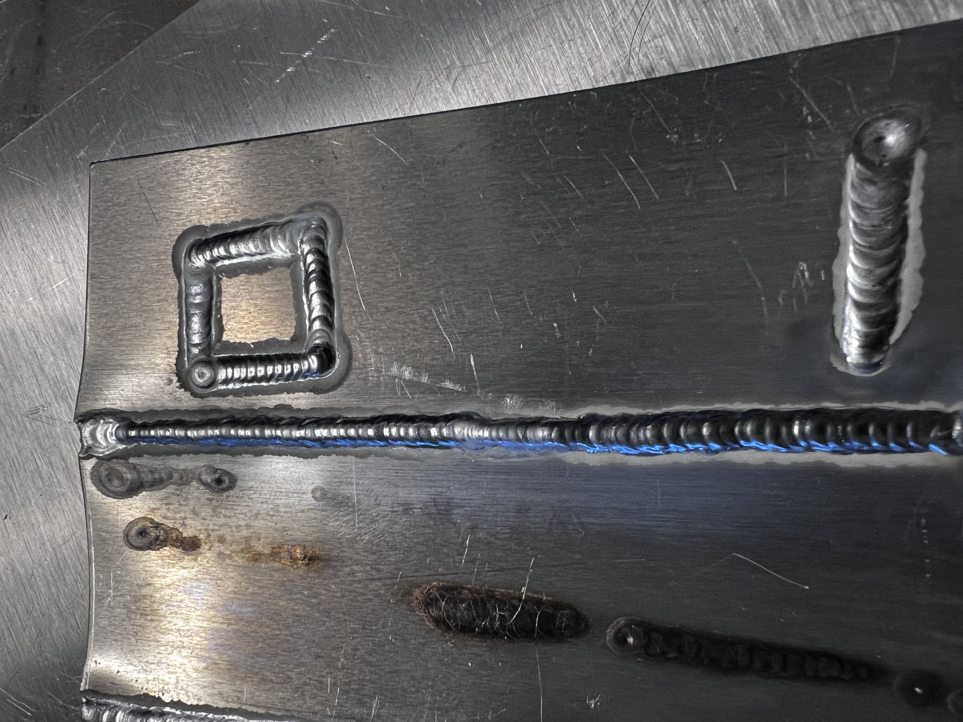

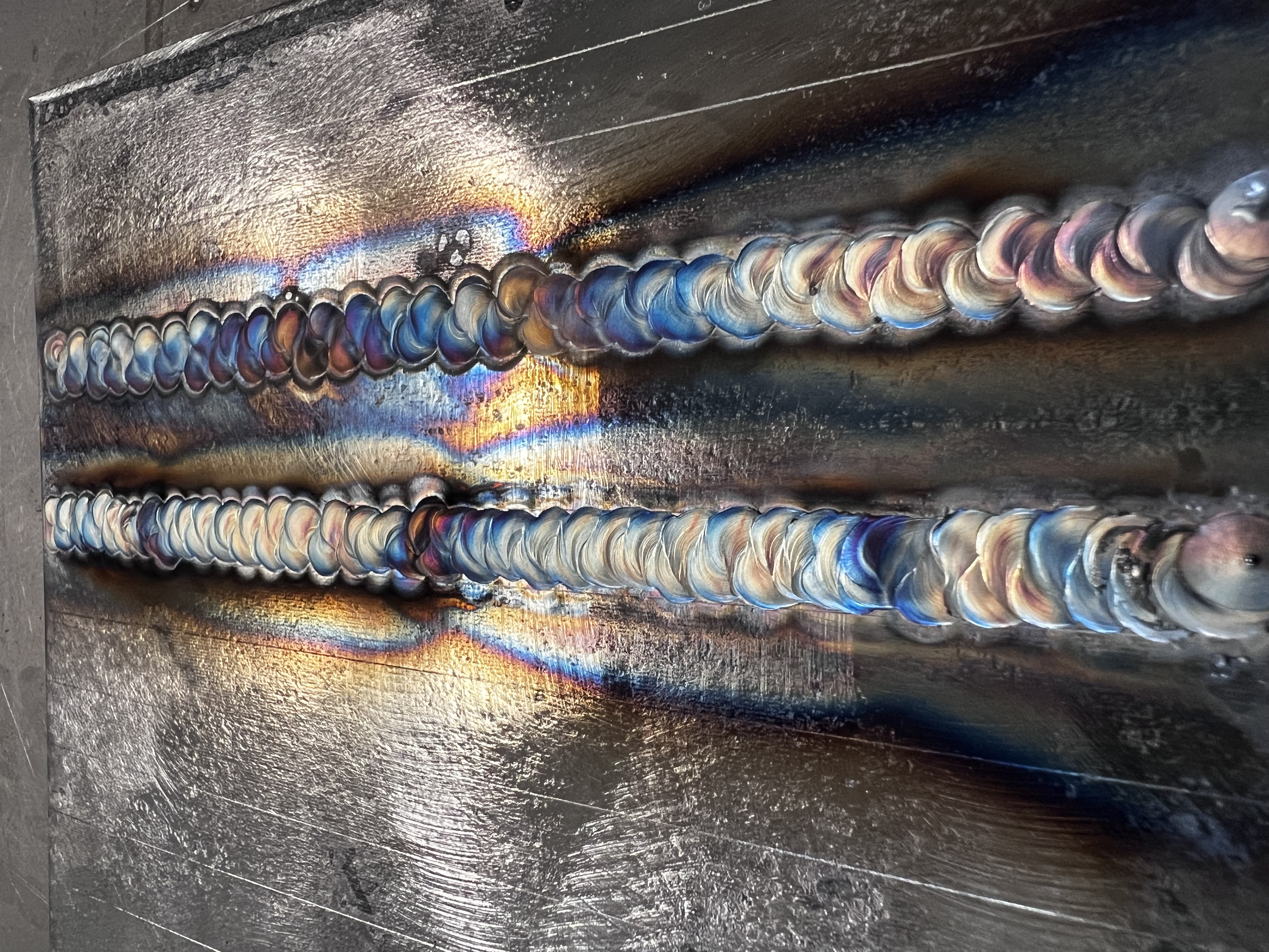

- 1/8 steel at 110 amps, 308L 1/16 rod, #10 cup
- IMG_9805.jpeg (3.43 MiB) Viewed 72664 times
- IMG_9806.jpeg (2.9 MiB) Viewed 72664 times
With 1/16 filler on 1/8 material, I’d be closer to 95 amps to avoid the base material absorbing so much heat. That’s why your beads are turning blue/purple after a bit. Also, with only a #10 cup, make sure you’re using about 20cfh or gas.

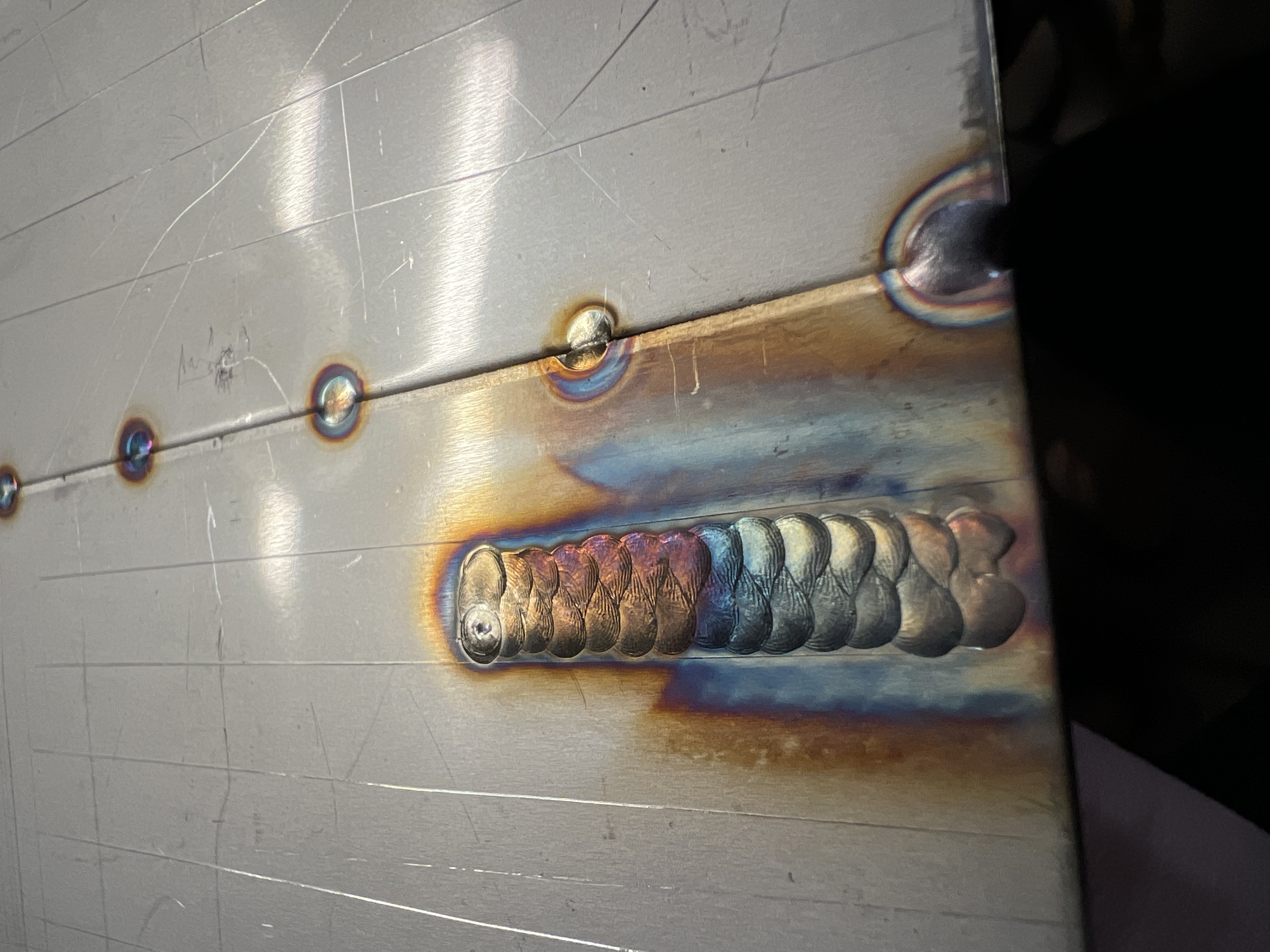

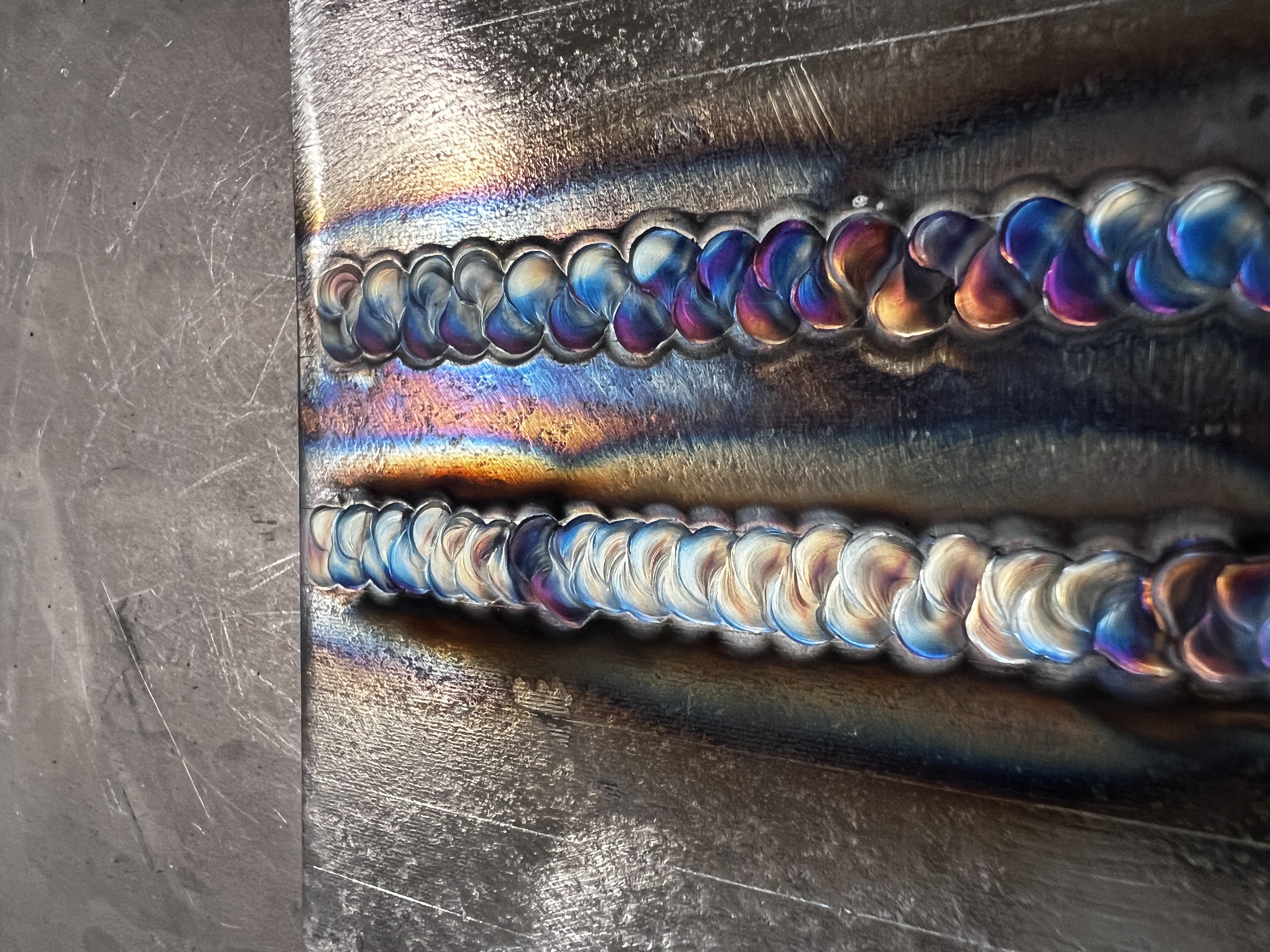

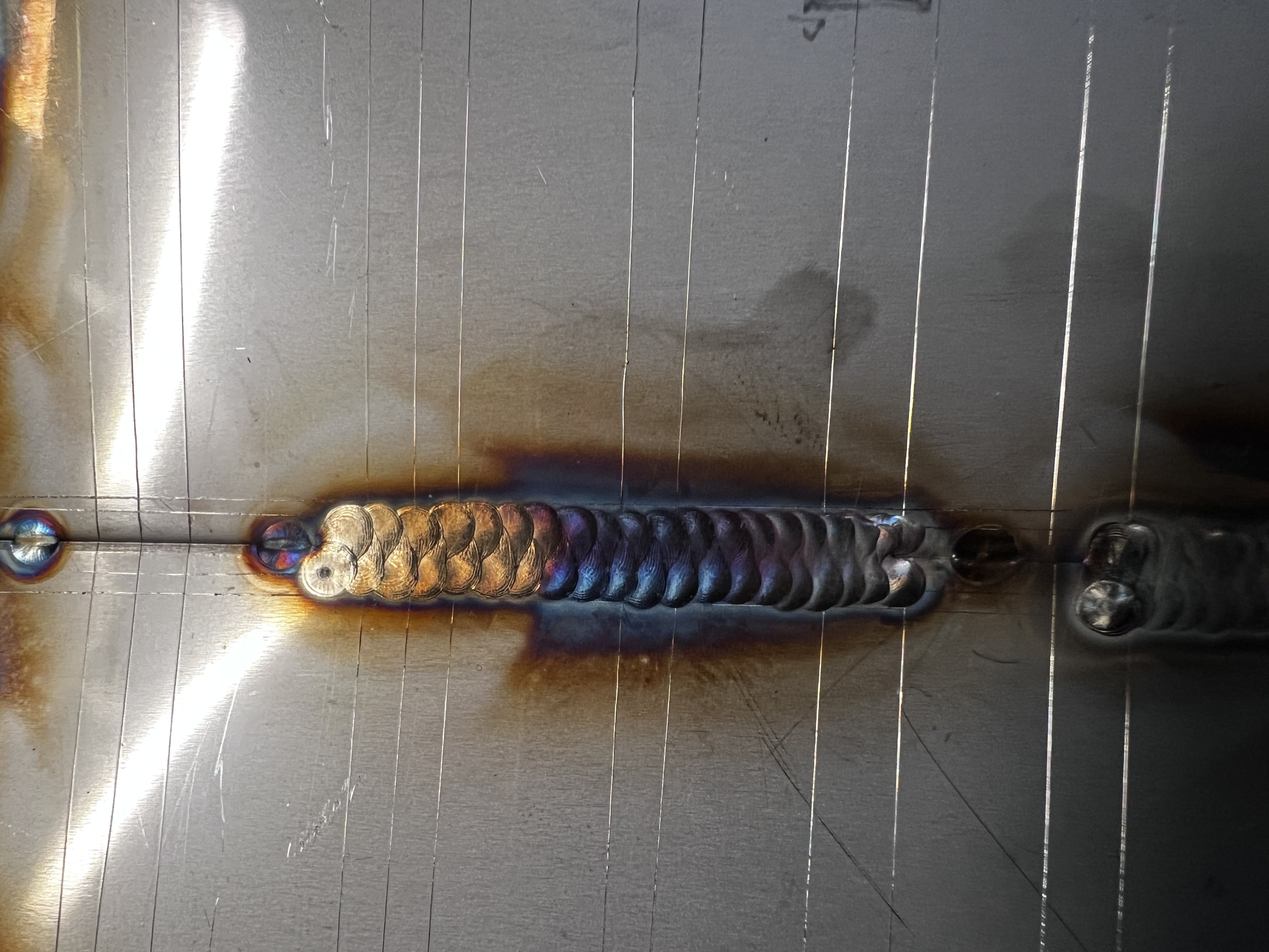

I was bored and without better knowledge decided to weave 16ga stainless. This was done with a #10 cup, 1/16 lanthanated, .035 308L @ 33 amps and 20 CFH.
Definitely a little slow there on the first half but once I got comfortable I sped it up a bit.

33 amps might be a little low for 16ga. When the amps are too low, you have to wait in the stainless to melt, that causes a lot of heat input. As odd as it sounds, a touch more heat gets your puddle faster so you can weld without introducing as much heat overall. Of course, the higher the amps, the faster the travel speed….

You're right. I've just upped it to 38 amps and I'm definitely not moving fast enough on this. It came out with all sort of colors so I know I'm cooking it. Definitely something for me to work on. Be back in a few dayscj737 wrote: ↑Tue Mar 26, 2024 7:57 am 33 amps might be a little low for 16ga. When the amps are too low, you have to wait in the stainless to melt, that causes a lot of heat input. As odd as it sounds, a touch more heat gets your puddle faster so you can weld without introducing as much heat overall. Of course, the higher the amps, the faster the travel speed….

Edit: My curiosity got the better of me. Tried it again at 33 amps and ran through it like Forest Gump. 33 amps left, 38 amps right.

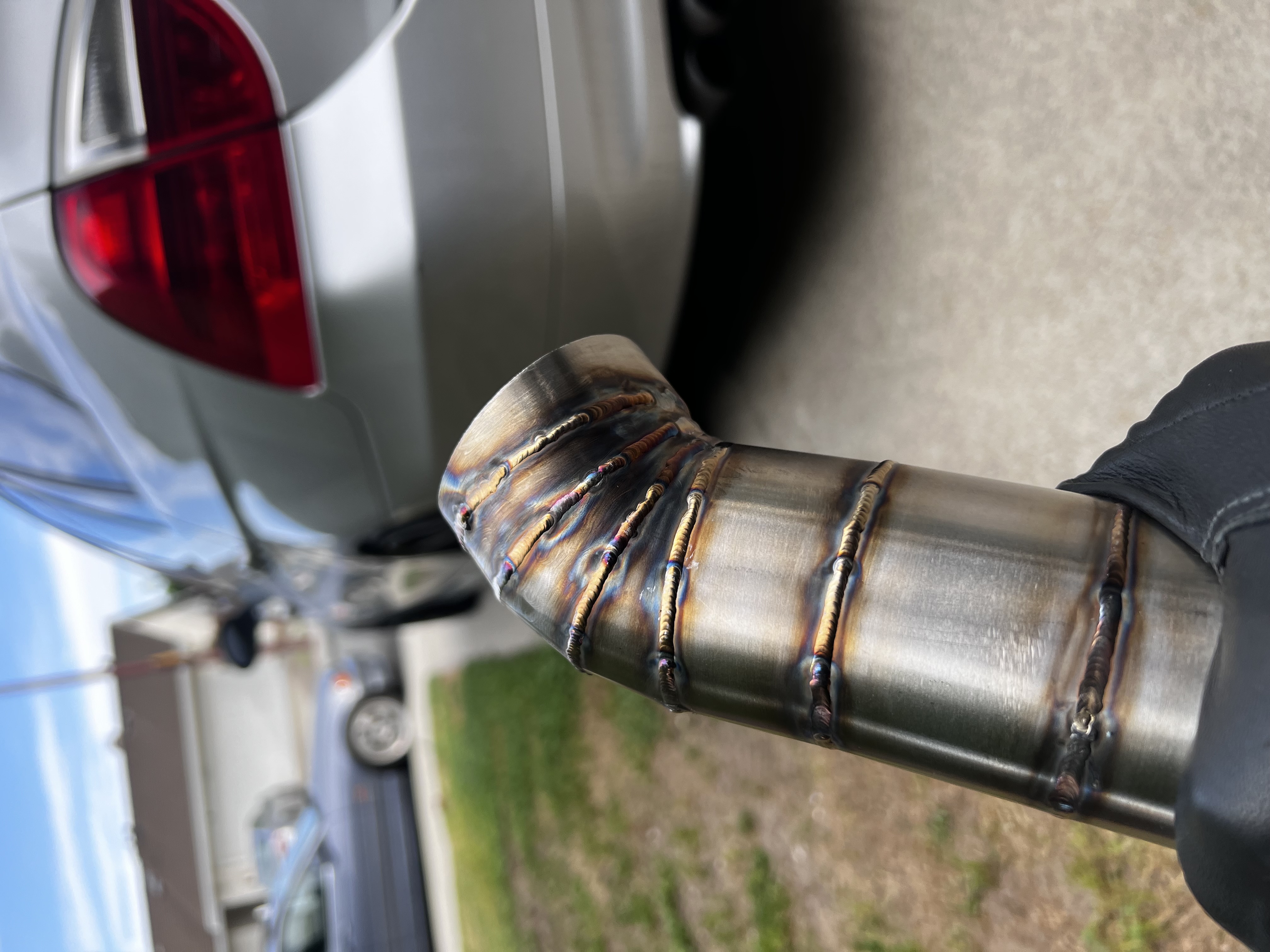

I’m back with more entertainment for you guys.

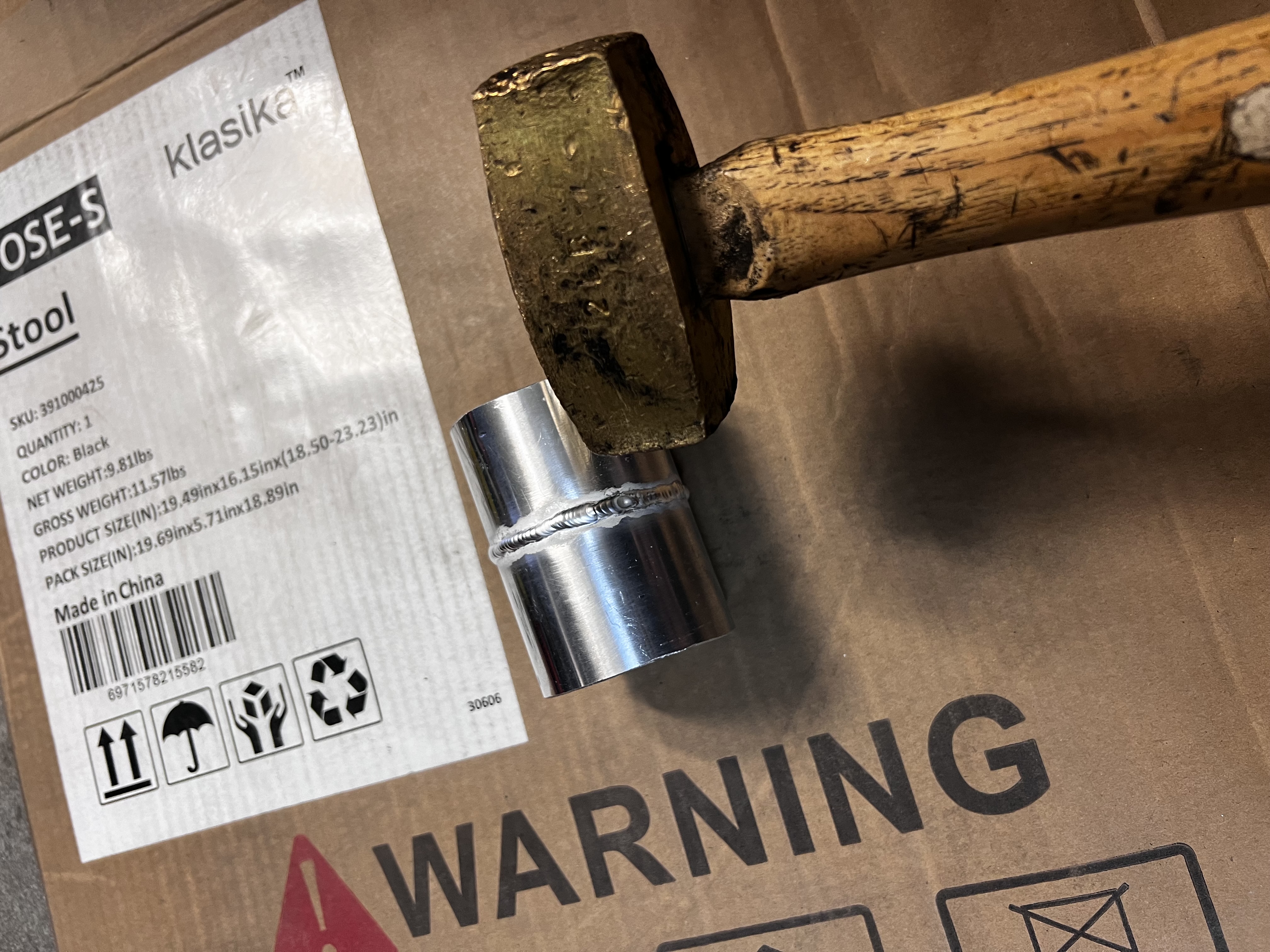

I chopped up the rest of the stainless tube to practice going around a tube with a curve to hone my stops and re-starts. Definitely a humbling experience.

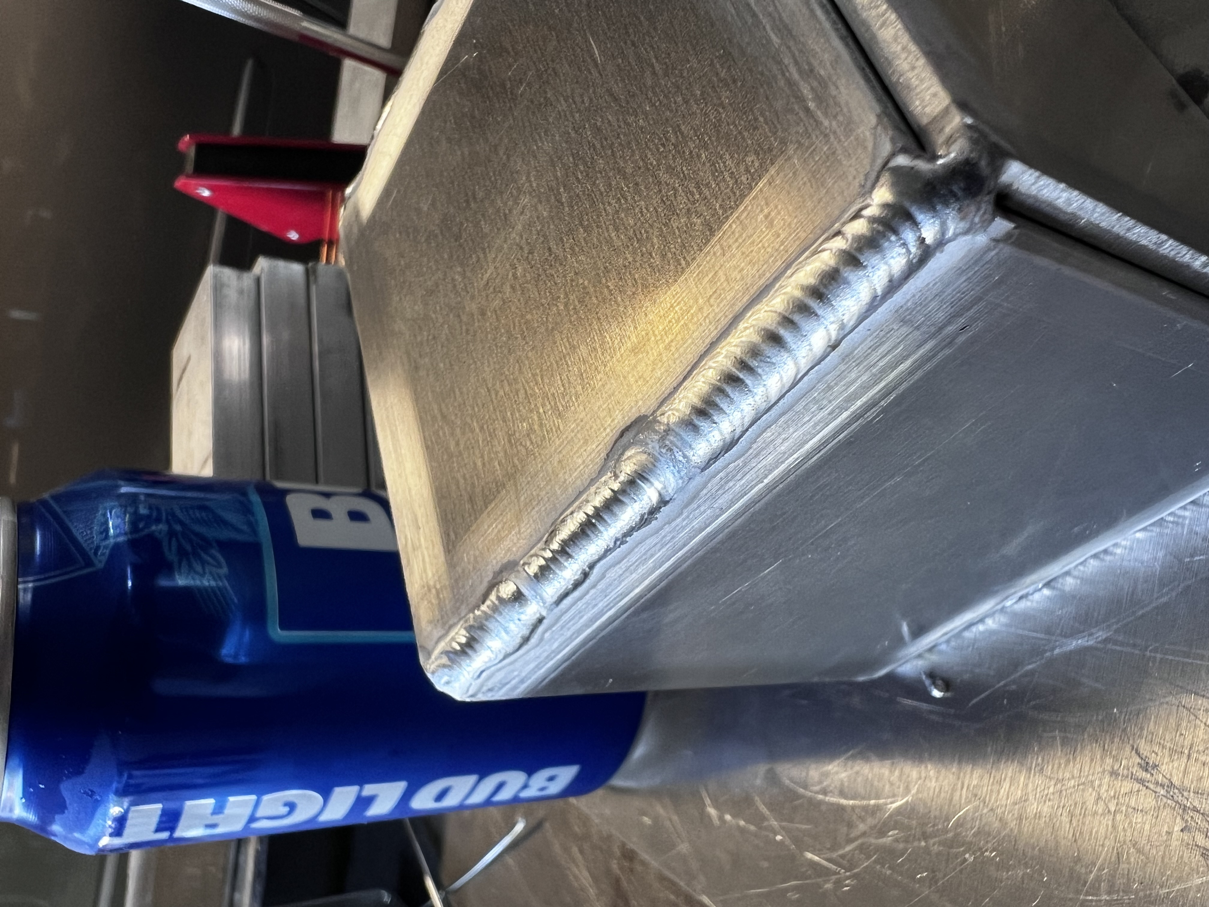

I started on a 1/8 aluminum cube for an armrest.

Aluminum looks really good.
Looking at the stainless welds, your bead profile indicates too much filler and too slow of travel. You’ve got lots of heat (hence the colors) but the bead is not getting wetted in. So…
Bump your amps and move a bit faster OR reduce the filler wire size and slightly bump the amps. Travel speed might be fine then. Stainless butt welds can be done without filler if the fit-up is good. If so, just run without to get your technique down. Add a dab if there’s a big gap.
I also like to use pulse when stainless autogenous welding. 50%/25%/1.2pps is my preferred settings. Amps are up to you. Just let them be enough to fuse the joint.

I was trying to convey welding around a tube with a weird bend with the thin pie cuts. Bad wordings. It tripped me up and all concentration went out the window. I think that’s where I slowed down and all the rhythm of dabbing went bad.cj737 wrote: ↑Thu Apr 18, 2024 9:40 pm Aluminum looks really good.

Edit: I appreciate the suggestions. I will try pulse next time. I was in the mindset of getting as good as I can with the filler before doing autogenous on a tube. At least that’s what I’ve read.

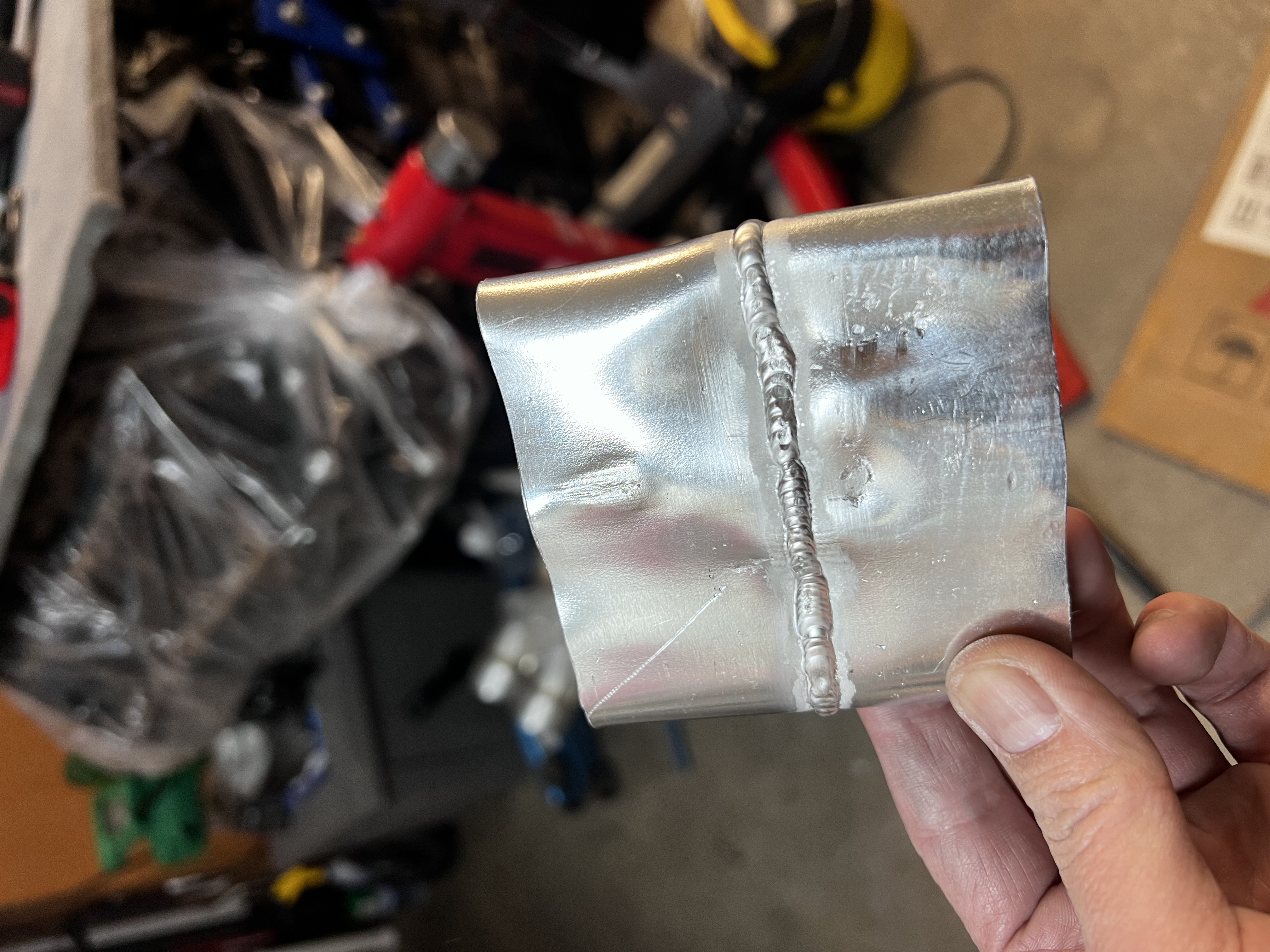

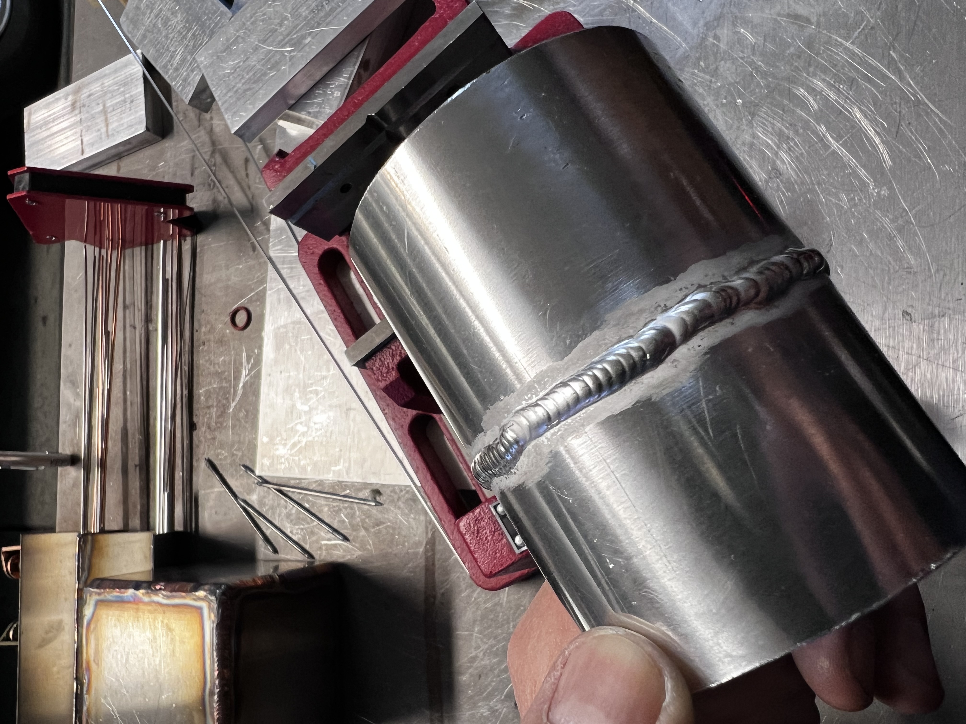

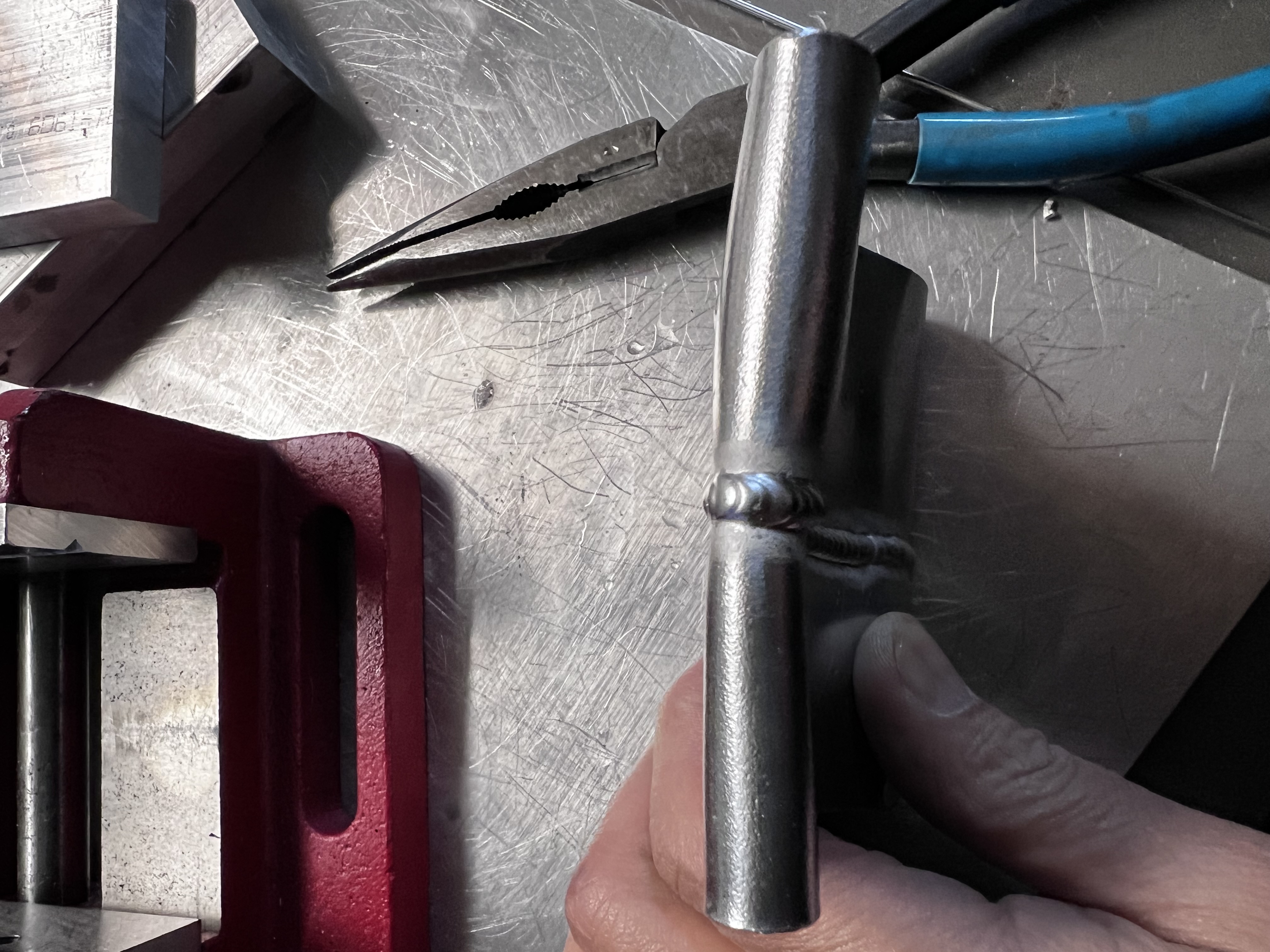

Hello gentlemen. I am back with more carnage.
I finally took a shot at going around a 2.5” 16 ga aluminum tube. No curves this time
I think I’m adding too much filler and too cold.
Material
. 3/32 lanthanated
. 1/16 5053 filler
. 70 amps on the pedal
. 15 CFH post flow
. #5 Furick cup with a gas lense
Thank you in advance for any suggestions

It’s important (when possible) to get a look at the backside. The amount of penetration will tell you volumes about heat, filler and travel speed.
Those welds do look over-filled. Using a bit less of the filler per dab might be all you need to do.
Hi Cj737. Thank you for your feedback.
I went back and weld another and I definitely need
to work on the dabbing part. I think I was anxious about putting a hole through it so I traveled as if I was working with stainless. Shoving the filler in there didn't help either.
I'll practice some more and will come back with pics

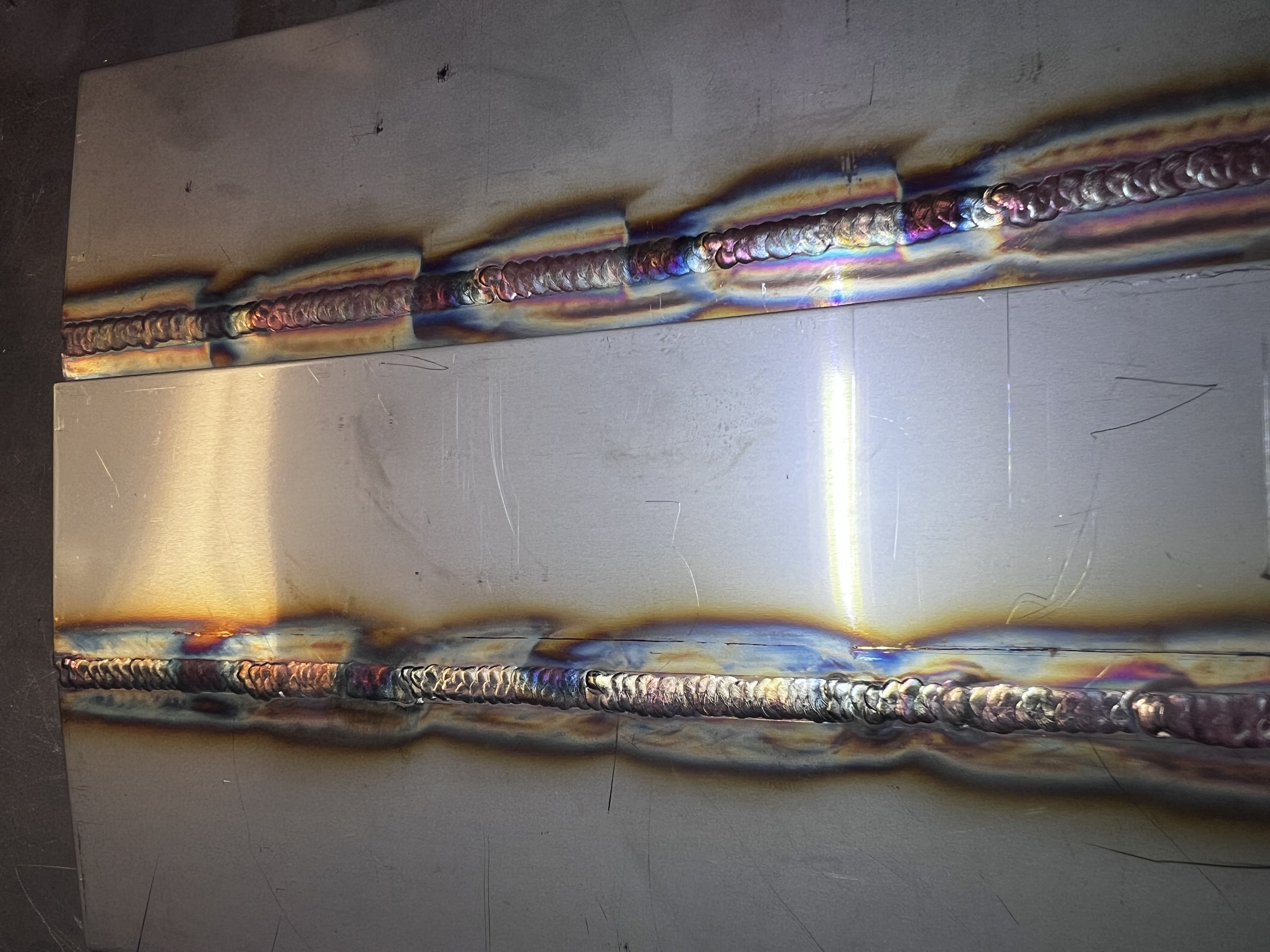

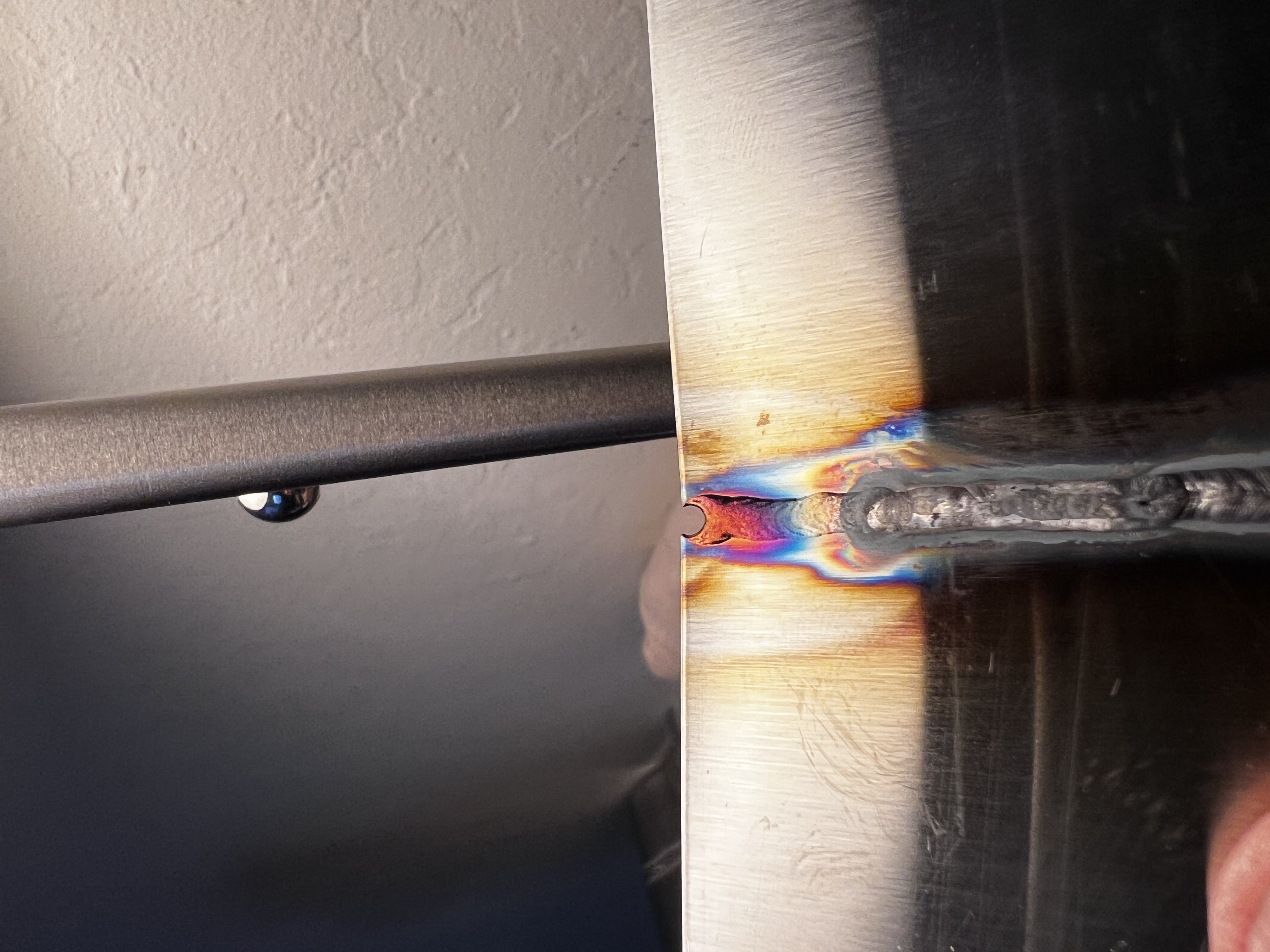

Got my hands on some 20 gauge stainless.
My first attempt.
30 amps, no pulse
.030 308L
1/16 2% Ceriated
BBW cup @ 30 CFH
I got uncomfortable with the position and got stuck at the purple spot. This is also where I started.
How should I tack the ends of this weld to prevent blowing through like that?

When I weld sheet that is that thin, I place a tack about 1/2” from the end. Then as I weld to the end, the tack allows me to pick up some “extra” material and I know to begin backing down on my amps. An extra dab of filler at the end with a progressive pedal tapering seems to work for me.
Realize the weld at the end/edge on thin material will always have a small “ball” as a result. It’s not inappropriate. But managing your heat as you approach the end is the next evolution of reading the puddle.
