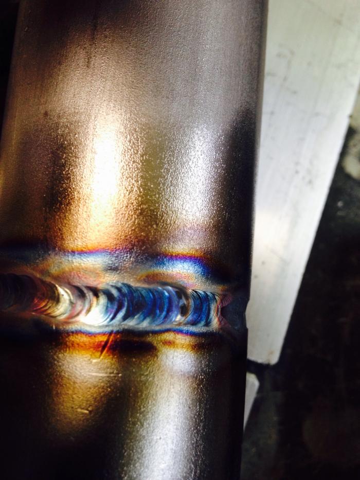

So towards the end of the weld I started getting the results I wanted. Good penetration, good color and stacked dimes look. I did notice that if I tried running 3/32 filler rod I had to get to hot and it turned gray. With about 100-110 amps and .035 filler I got decent results. Just gotta keep practicing
- image.jpg (73.35 KiB) Viewed 1980 times
With .035" filler your feeding rod super fast, it hate to have that many starts and stops. How many amps are you using, 3/32" should melt easy enough.

Same amps for the 3/32 filler, I'm gonna try again with the .035 filler feeding it faster. I knife edged the joint, left about a .035 gap, wire wheeled it, cleaned with acetone, back purged the pipe and verified 18cfh out of the huge Pyrex cup.

Oh I'm getting close, first bit of weld so the pipe was cool. Beautiful color and full penetration. The weld is flush with the pipe. Amps set at 160 bit obviously not using that much. .035 filler wire with a tight .035 gap. I think setting up an aluminum heat sink will really help keep the heat down. 20 cfh on the torch with the huge Pyrex cup, back purged and cleaned joint.

This was a single pass, no root. I think I need a slightly bigger gap and to push more filler wire in the joint. It was on the ragged edge of getting good penetration but I didn't wanna push it to hard.

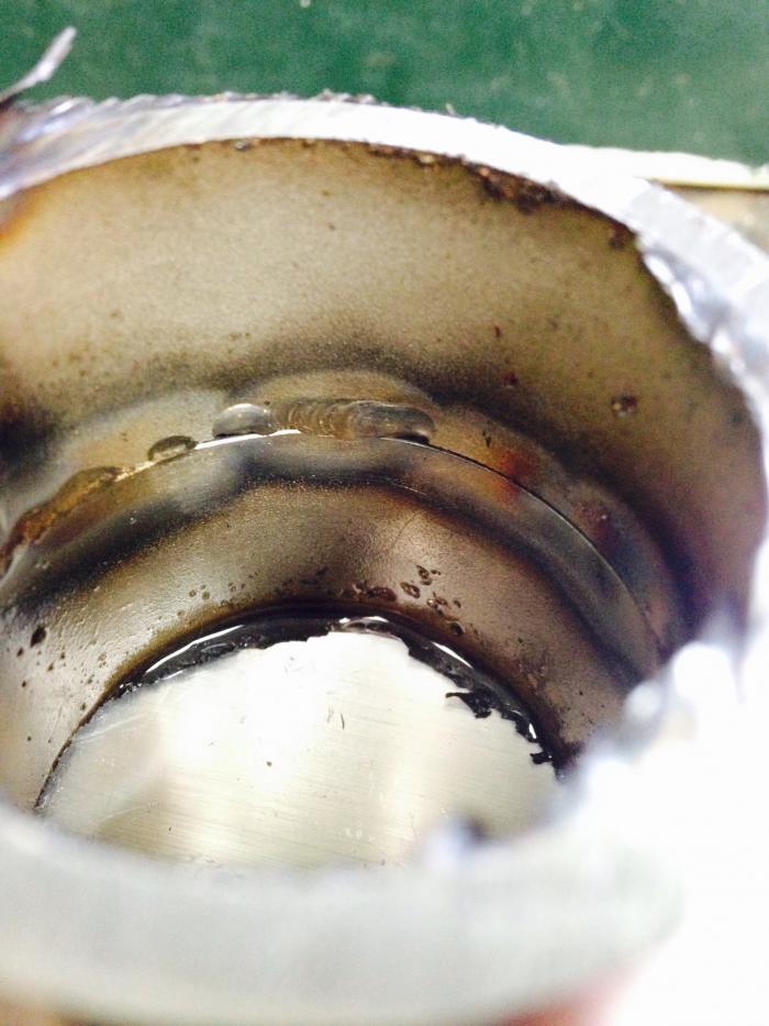

Root pass and cover pass. I didn't make the gap big enough and I didn't push enough filler wire in to build it up. The root came out pretty good, I think if I would have built up the root a bit more I would have got a better cover but I'll keep practicing.

Why one pass? What is this used for?
Without identifying any of the well known manifold builders, I have handled and inspected several of the manifolds made by the "best" who show their welds on instagram and the like. The ones that represent that they weld "one pass" schedule 40 with full penetration simply don't get full penetration, which is clear when you inspect their products. Some of them essentially have NO penetration visible on the inside of the manifold.
If you really want full penetration, you will need to two passes to get it right. The first pass can even be autogenous with a knife edge land. The second will give you the fill and "stack of dimes" appearance. You can't get both in one pass without putting far too much heat in the weld. Anyone who says they can should post video of the weld and the interior.

I absolutely mean to do 2 passes. When I said i thought I could get better cover I meant the cover pass. The root was very small and that meant I had to push a lot of wire into the cover pass and it just barely got flush with the bevel. You also hit it on the head that people who claim to get full penetration and that really nice cover just doesn't add up to me, I see the manifold collectors that are polished to a mirror sheen which tells me that there had to be 100% penetration or a LOT of grinding out of material to get to the weld for a smooth polish. This weld came out very nice but with more and more practice I know I'm going to be getting better results.
I think we agree on the concept, but you can never tell about penetration from looking at the outside. You have to inspect the inside to determine whether your weld fully penetrated the material. When it has, there will be a visible weld on the inside that looks similar to the weld on the outside. 100% means that (1) it has been welded all the way through the material, and (2) that the interior visible weld goes all around the pipe continuously, no skips or areas that were unevenly heated...CornerStone wrote:I absolutely mean to do 2 passes. ... You also hit it on the head that people who claim to get full penetration and that really nice cover just doesn't add up to me, I see the manifold collectors that are polished to a mirror sheen which tells me that there had to be 100% penetration or a LOT of grinding out of material to get to the weld for a smooth polish. This weld came out very nice but with more and more practice I know I'm going to be getting better results.
Getting a smooth cover pass in a two pass procedure is just a matter of practice, which you'll continue to figure out and improve, but getting full penetration requires a two pass method, which is where the manifolds you have seen fall short, because in production settings, two passes takes twice as long and they just don't want to expend that amount of time to do it right.
I assume that you are fully back purging as well and waiting to make sure that the back purge has fully displaced the O2 inside the pipe, or the rest of this discussion is moot.
