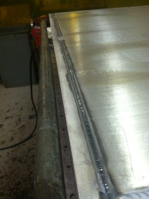

DC root pass on .750 to .750 beveled butt weld on good old 6061 Aluminum.
After wire brushed and acetone wipe for cover pass
Full length root pass.

Just to clarify a few things ... AC Tig with Argon is still the preferred way & typically what's recommended in the industry. As Welders, we just don't like to be told something "can't be done" ... So it's good conversation to tell stories about welding aluminum with DC & helium. Just keep in mind that most people use AC because it's more consistent & user friendly. In addition, helium is expensive & introduces other issues to the process ...
Keep in mind that Helium runs at a much higher arc voltage than argon & not all machines will perform with it. Some newer units monitor arc voltage & will shut down if the voltage is too high. You also need to run 2x the flow rate of argon & remember that helium floats away, while argon settles & is heavier than air. In addition, be prepared for poor arc starts ... As helium doesn't carry the arc as well as Argon either. It's also very tough to add filler with a DC arc on aluminum ... So the bead doesn't always look like a stack of dimes.
AC buzz boxes have trouble with aluminum Tig because the arc goes out every 1/2 cycle. Chances are, the arc may only ignite every other cycle - called rectification. That's why they didn't use old AC sine wave machines for aluminum until they figured out High Frequency ... Which keeps the arc lit. Now, square wave technology has improved it ... But even the most advanced inverters on the market struggle with arc outages & continue to use HF or a high voltage in the process.
It can be done ... But I wouldn't recommend buying a DC unit to weld aluminum or adapting an AC buzz box ... Unless you absolutely have no choice or are very familiar with the process (ie: expert, trained, etc).

Roy,RedIron881 wrote:DC root pass on .750 to .750 beveled butt weld on good old 6061 Aluminum.Optimized-IMG_0294.jpgAfter wire brushed and acetone wipe for cover passOptimized-IMG_0851.jpgFull length root pass.IMG_7047.jpg
Thanks for your posts on Welding aluminum on DC. I think they are about the best info out there on the web...and the photos speak volumes about what can be done.
I did a simple repair a week or so ago on an aluminum shaft that was accidentally gouged by the tool changer on a cnc lathe It didnt look too pretty because the gash was about 3/4" deep and about an inch long so not enough space to really get going to stack dimes....the repair went much better than it would have using AC and it machined off clean.
