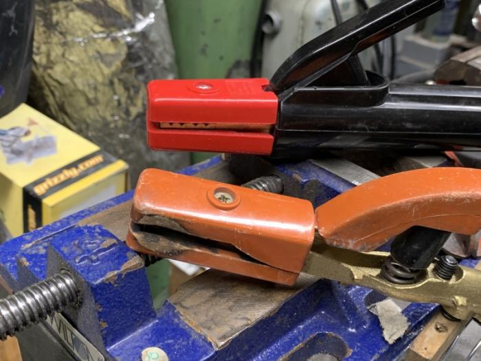

This is kind of a corny review/comparison, but the reason I'm doing it is because I've seen more than one posts asking which consumables are better between the Primeweld and AHP. These 2 machines seem to be 2 of the more popular low end AC/DC Tig/Stick welders that people consider buying these days. They are about as low as you can get for this type of machine, IMO.
The more I dig into the Primeweld, the more impressed I have with some of the features. In this case I will show a comparison between the stingers. This is not an AHP stinger, however the AHP comes with the same consumables as the Everlast green weenies, AFAIK. Also, my green weenie was purchased 2 years ago and AFAICT the ground/stinger are the same to this day, so I'm just guessing the AHP has the same one.
I should also preface this letting you know that I don't use any of these stringers or ground clamps, but this post doesn't show the ground clamps, only the stringers. You will see below I use a Lenco 250 amp USA made stinger and a Martin Wells 300 amp USA made stubby screw type. I have both on the cables provided by Primeweld and Everlast. :)
First, let's talk about the quality of the stinger jaws themselves. The Everlast is a bit more wonky than I've ever liked, even when new. They tend to wobble sideways which allows the rod to fall out in some cases. Certainly easier than non-wonky jaws. Both are Chinese stringers however, just that the Primeweld provides a better stinger.

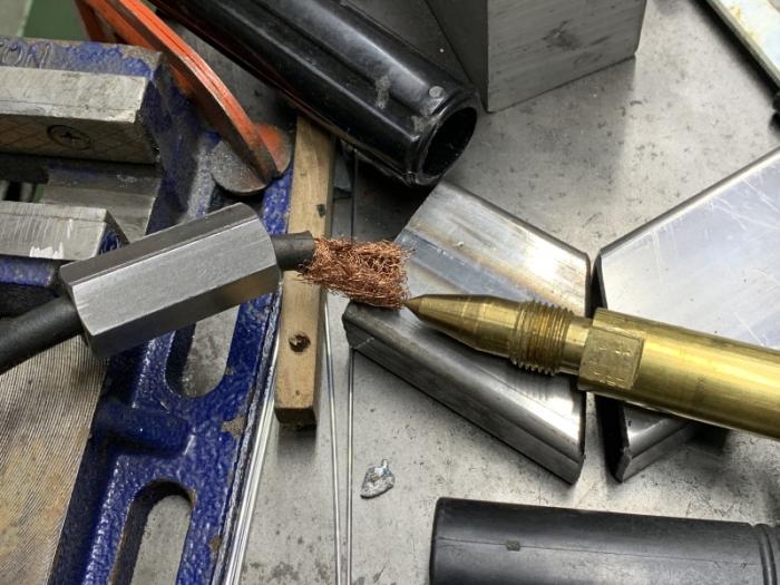

Let's look at the cable connectors. I was surprised to find the Primeweld has a crimped lug that even has fairly heavy shrink wrap on it. I would consider this to be a plus. However, the Martin Wells stubby stinger I use wouldn't work with this cable unless you cut it off, it has a point with a hex nut that screws over it, I think it is probably best to solder the cable to the point, that I don't know. I create a cone shape and smash it in and screw it together, it seems to hold the cable tight. Might not be the best way and the Everlast cable is not frayed as it is here in the pic, that happened from using it with the Martin Wells. With the Primeweld cable it uses a lug that attaches to a screw/wash setup to sandwich the lug in between. The Everlast uses a piece of copper for a lug round set screw to smash against. My Lenco is very simialr, however I am using the Everlast cable on my Lenco stinger as the Primeweld is not suitable without removing the lug and creating a cone as I do. The Everlast does use 2 set screws, but they are not hex driven, they are phillips screwdriver driven. 2 is better, IMO, but screwdriver driven sucks. I will say I am surprised that the Primeweld has almost no wonky sideways movement, it looks to solve that problem. The cable on the Primeweld is slightly more pliable also, so I would give the edge to the Primeweld.
Primeweld and Everlast stringer jaws
Primeweld stinger connector
Everlast stinger cable
Primeweld and Everlast cable ends
Martin Wells connector

My Inverarc 200TLP came with the same one as the Primeweld. I'm not too fond of it, but it works I guess. The 200A tweco, now that one I really like. It is very ergonomic. I think I'm gonna buy two more of those.

Oscar wrote:My Inverarc 200TLP came with the same one as the Primeweld. I'm not too fond of it, but it works I guess. The 200A tweco, now that one I really like. It is very ergonomic. I think I'm gonna buy two more of those.
I think it looks pretty good for Chinese, most of the ones I've seen on the inexpensive machines are like the Everlast.
