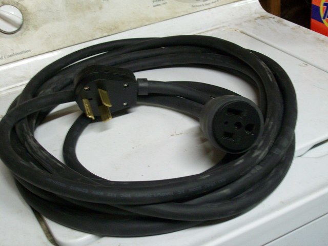

I got my AHP Alpha Tig today. Just seeing if it started. Haha. I tried to plug the thing into my Bobcat 250, using the plug that comes on the machine. It did not seem to fit. Didn't seem wide enough. Anyone try it? I mean, it would suck if I could not use the AHP at the highest amps. Maybe there is an adapter I could get? Fill me with your knowledge.

Some years back I bought a MIG machine that didn't even >have < a plug, the assumption being you would match the plug to your power source.
Your choices are, match the Bobcat to the AHP, or match the AHP to the Bobcat. Since modifying the Bobcat would be much more difficult, i suggest modifying the AHP.
The Bobcat manual should tell you the NEC name for the receptacle, or you can visually match it to pictures online. From there it's just a matter of finding the plug that mates with your receptacle, and installing it.
All this assumes you did your homework to verify the Bobcat provides enough scrote to run the AHP.

Just realized: another alternative is to make a little "jumper" or extension cord. On one end of the cable, attach a receptacle that matches the AHP plug; on the other, attach a plug to match the Bobcat receptacle.

If your Bobcat 250 is the same as my 225, the 240 volt recep is a NEMA 14-50R. The plug on the AHP (I have one) is a NEMA 6-50P. You need an adapter with a 14-50P plug on one end and a 6-50R recep on the other. Miller sells one under the name "Full field adapter" or something like that. They're kinda proud of 'em, about $75. You can also build one if you're of a mind to. The parts are available at Lowe's, Home Depot, etc. If you build one, use at least #6 AWG wire.

My suggestion is to buy a 50 foot extension cord that the Alphatig plugs into and change the plug to one that fits the Bobcat. From what l gather the Alphatig will only ever be used powered by the Bobcat.

I bought the Miller adapter. By the time you go buy connectors and cable and spend your time, it was worth it to me to get the factory unit. It's got molded plugs and all, real nice unit. Worth it in the time saved to me.Glowzinski wrote:I've never done any kind of electrical thing. So, I would really have not a clue. haha I could figure it out. I can buy a $70 thing from Roberts Oxygen.

It will cost you about $40 to make one. Plugs are about $15 each and you need one for each end. and $6 for a couple feet of cable plus tax. It might be worth buying the fully molded adapter plug for an extra $30.ldbtx wrote:I bought the Miller adapter. By the time you go buy connectors and cable and spend your time, it was worth it to me to get the factory unit. It's got molded plugs and all, real nice unit. Worth it in the time saved to me.Glowzinski wrote:I've never done any kind of electrical thing. So, I would really have not a clue. haha I could figure it out. I can buy a $70 thing from Roberts Oxygen.
I had no luck tig welding today. haha I could not get the puddle started. Actually, it was odd. Really, nothing happened. BUT, first time I ever tried it. All in good time.
I made a custom extension cord for my AlphaTIG. It's 30' long and has a (male) dryer plug (10-50P) on one end and a (female) recepticle (6-50R) on the other end. I didn't save any money making the extension cord, but it's the length I wanted (30' versus 25' or 50').
Dave
FWIW, it works great and I'm very happy with it.

I got the plug from Miller. Works great. Though, I've not been able to weld for a bit. Sick, then I screwed my back up playing with a baby. haha
