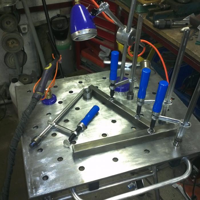

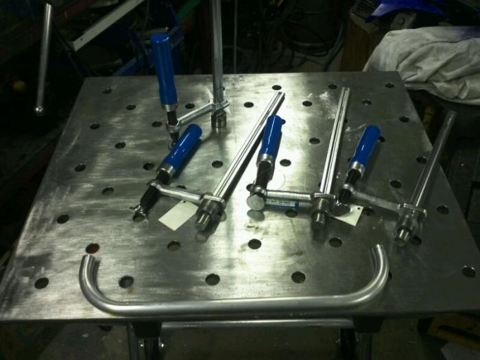

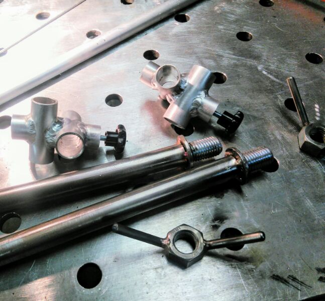

Been fabricating a small fixture table lately.

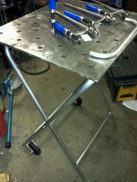

Plate is 600x500x8 mm.
Have wanted a decent table for long but dont have the space for it so I made this to be somewhat portable.
The rollers will not engage until its folded and tilted a bit.
Made some stronghand type clamps to use with it.
Just the handle to weld on and its completed.
Nice job Anders. That looks like 1/2" plate on the top...how many drill bits did you wear out drilling those holes
Ooops just read that the top is 8mm..pays to read the wholepost sometimes
8mm is 5/16, give or take a few thousandths....
Okay, 8mm is .3149" versus .3125" for 5/16... After I said it, I had to do the math.
Thanks Jeff
Actually the bit is still like new after 50 holes. Used an Alfra Rotabest core bit with plenty cutting fluid.

Roughly 2" between rows and 4" between holes. First hole is offset 2" from previous row

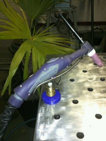

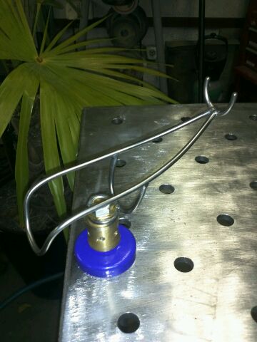

Made a torch holder to fit both a 9- and 26-torch.

I really like the torch cradle! Was that your design? Very talented!
Thx Jeff, yes my design. Some "engineering-on-the-fly" and hand bending the wire.
I really hate the ones one can by where you need to tilt and twist to release it. Almost like one of those metal puzzles

Ready to use now

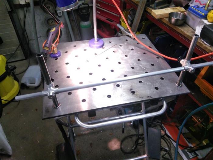

Made a handrest tonight. Long enough to reach diagonally if needed.

Nice Anders! You're WAY more creative than I am...I usually steal my ideas and then take credit for it

Well I probably shouldnt take credit for the arm rest. Seen a coupple before, Jonathan made one I remember from a while ago. Think Jody has one in a video too.

The legs? I made them from 22 mm aluminium tubes.
