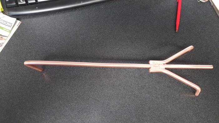

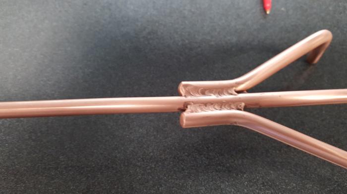

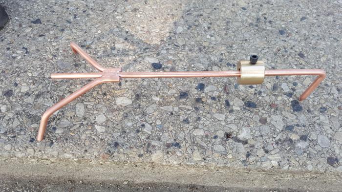

I made a pair of third hands, tig welded with copper wire as a filler. It took a lot of heat before I could get a puddle. Welded really nice after that. It was almost entirely glowing red when I was finished. 3/8 round .I made a bronze weight on one of them.

Very nice! I like the adjustability.

Thank you. The copper is sooo soft after the heating from welding I swear you could almost tie it in a Knott!

I am thinking of copying this but silver soldering instead to hopefully avoid annealing the copper.

It a real work of art. I have a chunk of Buss Bar that maybe would make nice one on the Lincoln style. Still nicely done and it look so cool. :D
