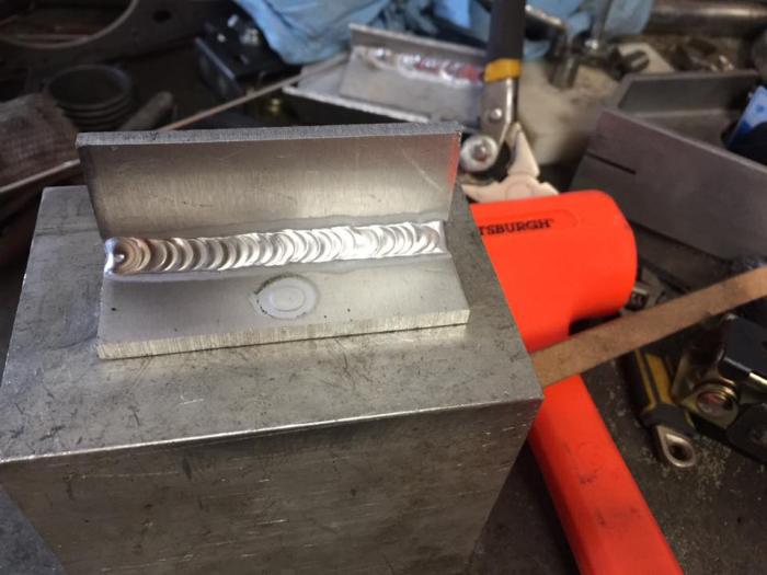

It was my first time turning it up to full jam. I had to stop and start my coupon because my filler hand was cooking and I had to change position. Made a 1/4" alu coupon weld, on both sides, torch never even got warm. I started at full jam and then progressively backed off.

A video of it running and some pics:
