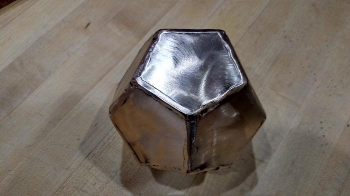

I'm doing a few little projects where I need to cut some stainless. Most is 10 ga. and the pieces are in the 1-2" range. Does anybody have any good advice for cutting repetitive pieces? I have a plasma but not a CNC. I built this cutting the pieces with a plasma using a template as a guide but still cut freehand. Any off the wall tricks welcomed.

I'm welding up different shapes with some of the stainless scrap pieces I have around. It gives practice and it's fun. I want to do a truncated triacontadigon at 6" in diameter. That makes for 180 exact 1" sides. In English it's a 32 sided soccer ball with pentagons and hexagons.
The dodecagon, 12 hexagons, was tough getting all the angles and pieces exact. It was more than tough , it was damn near impossible. I could send it out to be stamped of laser cut but that takes away from the home project thing.

If you have a high purity marker, I cut a lot of stainless with a cutting disc on an angle grinder or metabo. You can see the mark on stainless good, and as long as you score it first, the cuts come out pretty decent. A lot of pipe is cut that way in the field. Of course a good portable band saw works as well on stainless as long as the blade speed is slow and steady.
You can also take some angle iron and clamp it to the cut and use that as a guide for the plasma torch.
Your cuts look pretty good though as far as I can tell.

I've been doing a few test pieces of SB to Stainless. I AM going to make a truncated icosahedron. My goal is to do the Hexagons in either SB or stainless and flip for the Pentagons. I have some 1/8 SB coming next week. I cut some 3/16 SB with a wood miter saw and carbide blade. It worked fairly well. At least all the pieces were identical. Here is the rough product of that. I still need to do some grinding and polishing. Maybe a weld touch up here and there. It weighs in now at 3 lb. 11 oz.
- SB.jpg (29.13 KiB) Viewed 2109 times
Worked with ss most of my life and we always used a right angle 5 inch cutoff hand held or bigger Milwaukee and a piece of steel for a guide. Make a light score a couple times along your mark and the blade follows along just fine.

Boy I'd sure like to give a positive and detailed update on my little project but there isn't one. I'm still trying to get the stainless hex pieces cut Identically. I can cut them close but close ain't good enough when doing a project with this many common edges. Needing 20 dead nuts identical pieces makes for 120 chances for something to not line up.

WELL YAHOO!! After a long awaited step, I finally got my stainless cut on a CNC Plasma today! Next will be to machine cut the SB to match the CNC'ed stainless. I've been fooling with some templates and holding fixtures to use as a component setup. I'm still working on ideas for that. I do have quite a few ideas already that didn't work.

Mistakes were a lot cheaper then. If nothing else, I am persistent. I WILL make it. I now have all of my pieces cut. I have a couple setup ideas I'll try this weekend. It's supposed to rain today and snow on Sunday so I won't be outside playing.Otto Nobedder wrote:Thomas Edison's light bulb was the result of about 4000 things that didn't work...John Chamorro wrote:I do have quite a few ideas already that didn't work.
