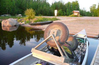

I need to build a two wheel dolly cart like in the photo for portaging my boat this year. It would need to support 1,000 lbs max. The cart uses wheelbarrow tires rated at 500lbs each, with a rectangular frame approximately 3ft x 2 ft. I need to make it strong yet light enough to carry it on board the boat. These are used to put under a boat, strapping over the top with ratchet straps and it supports the boat, motor, fuel and some camping gear over uneven terrain including rocks and mud. My boat weighs 120 lbs, 65 lb motor, 50 lbs fuel, 200-300 lbs of gear, 100 lbs misc gear. I'd like to build this out of square tubing.
What size tubing would be appropriate for this? Would 1 inch sq tubing work for this?? I don't know what size metals can support what type of weight...any charts for this? Thanks

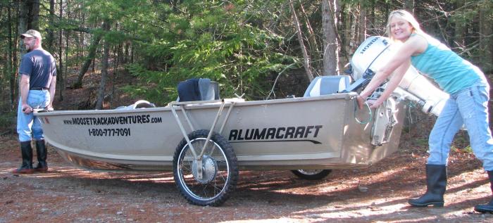

I don't have any other pics, these are all that I could find online. I've been trying to locate someone who has one of these so I could see what they were using but no such luck. I would think 1.5" square tubing would work.

I made something like this for my canoe once.
would be way easier to to attach and a lot less wobbly. looks like they only used 3/4" sq tube in this pic. It you get real creative, you could probably have 2 tubes that are wider than your gunnels that the wheel assembly slides over on each side so you can break the rig down into easier to stow parts.
- MOOSETRACK-230910-084543.JPG (55.93 KiB) Viewed 3336 times

Ha, you'd be surprised how easy the portage can be with the right equipment and the fishing is world class...it's worth the effort.
The other style of portage wheel you posted are the folding/flip style.
The wheels actually flip up onto the side rails while in transit across the lake. When you get to the other side, all you have to do is flip them down and lock them in using screw/pins. Here are some pics of this style so you get the idea of how it works. I can't wait to get starting building these. I'll definitely need help selecting the right strength/size tubing for this project as well.

The flip style wheels have a common tube that spans across the width of the boat and bolts to the side of the boat using a bent "L" bracket.
The "A" frame or "Triangle" wheel section slides into that cross rail which allows it to fold up and down. Some type of "D" shaped bracket is welded then bolted to the side of the boat and also uses one of the seats as the bottom support. This is the point to which the folding section sits on then is secured using a large "T-bolt" to screw it down. This allows you to hit the portage running so to speak. You hop out of the boat and away you go.
On the two-wheel cart style, you have to unload all your gear first. You then flip the boat up from the front, slide the cart underneath, attach ratchet straps over the top, re-load all your gear, then haul it all across the portage. It's more hassle and takes longer doing it this way but at least you only need one cart and it can be shared amongst several boats.
Here is a shot of the "D" type mount where the wheels screw into.
Here is a shot of the handle to pull the boat. Some people use a long bar, center mounted chain and carabiner. This style clips to the front of the boat instead of bolting on a true handle.

These folding style portage wheels were made after hours by a welder from a mining company on the Iron Range in northern MN. He no longer makes them so I need to make my own. If you guys get me onto the right size metal I'll be in good shape. I'd hate to have the metal fail on me on the portage.
If I were to build it, I would use no less than 14ga. and probably 11ga, and 1" tube.ole496 wrote:These folding style portage wheels were made after hours by a welder from a mining company on the Iron Range in northern MN. He no longer makes them so I need to make my own. If you guys get me onto the right size metal I'll be in good shape. I'd hate to have the metal fail on me on the portage.
