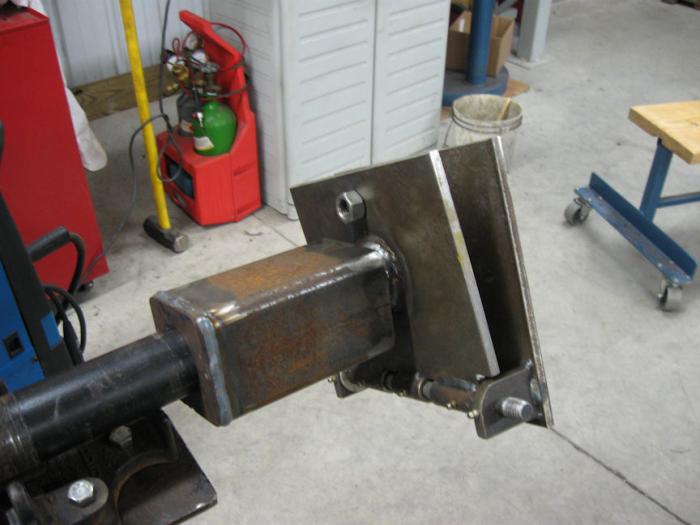

A few years back I wanted to buy an aluminum tilting flag pole until I priced them, just the cast aluminium bases were over $300. I called my friend who owns a weld shop and asked if he had any salvaged 2" pipe, he said he did and let me have two full lengths for $25 a piece. The 3/8 plate was another $25, the 12"X 40" galvanized culvert footing $25?.... the rope trolley and ball at the top was $50 to the house. The weld was ground smooth so it wouldn't tear up the flag. I used automobile heater hose I had to fill the gaps between the pipe nipples. The bottom plate has a 4" X 40" long piece of I beam welded to it that goes down in the concrete.

Nice! Grease zerks too!

Hope you don't have a tornado soon. That flag pole would be laid out with that wind. Other than that along with every other flag pole damn nice build that screams America. Two of my favorite things welding and patriotism.
