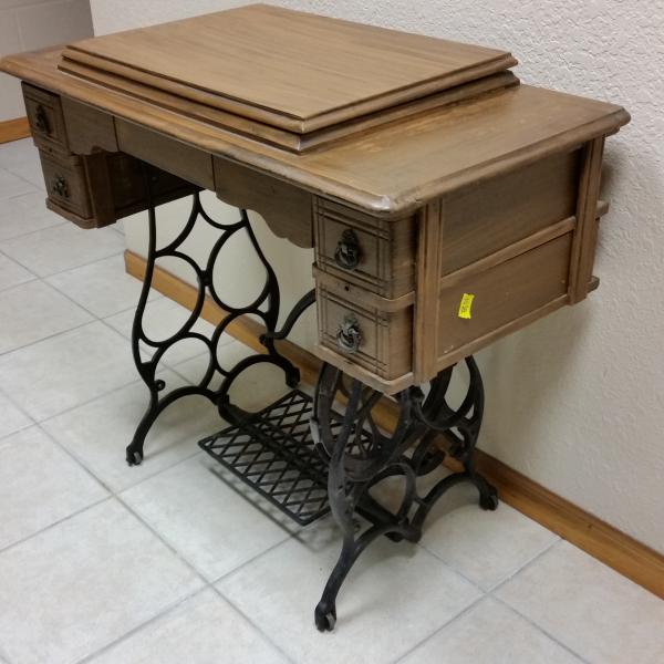

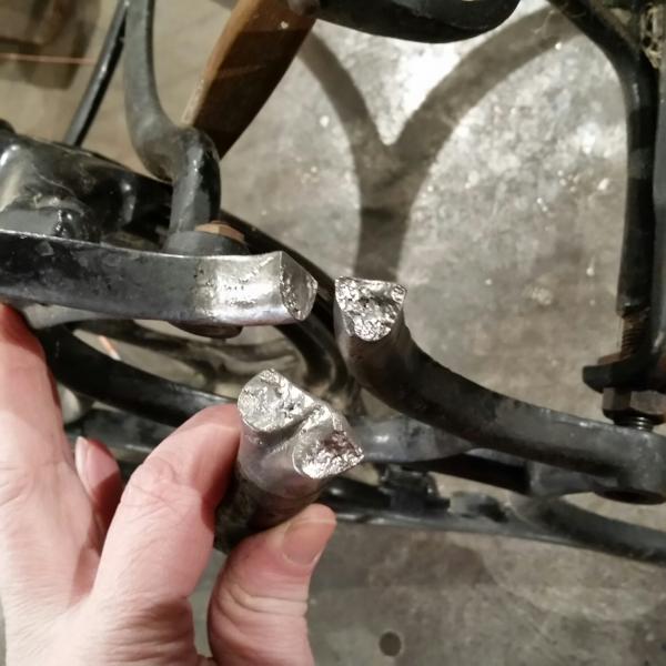

Nice older couple needed an antique sewing machine base repaired.
(Shipping company broke it and super-glued without telling them)

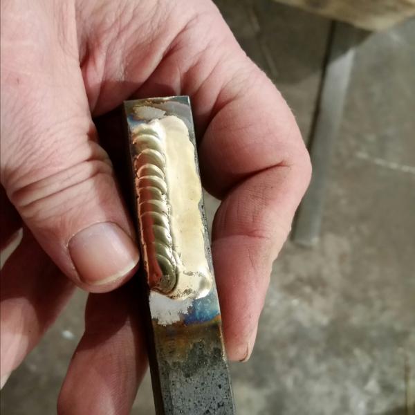

After standard google searching and watching Jody's brazing video with AC tig, and texts to friend Steve - I was ready.
Experimented with balance (on scrap) at 10, 9 and 8 on the syncro 350 set to 200 amps. Balance set to 8 was good. The upper 2 settings behaved strangely.
Running a linear regression puts that balance at 63.5% electrode negative.
Only took a few pics, it brazed very nicely after I learned how to see it wet out without actually puddling the cast.
This particular filler rod is ER-CuAl-A2
Quick test on scrap to see how brazing works.

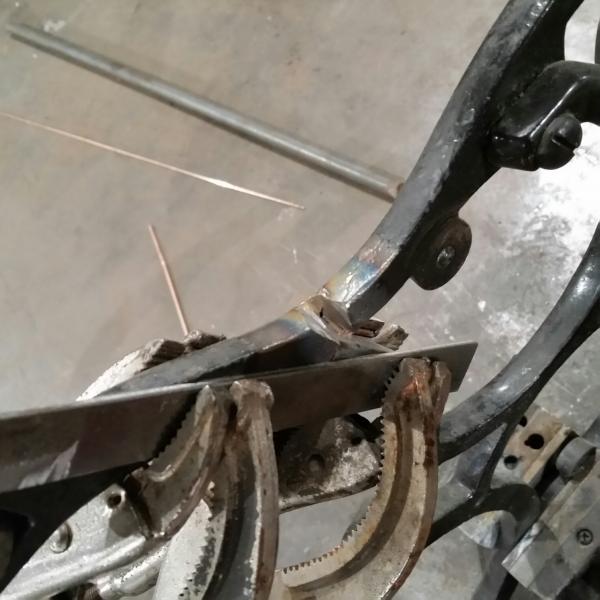

Brazed a little on the front, clamped and ground the back deep.
Starting the blending process.
Start blending the front.
