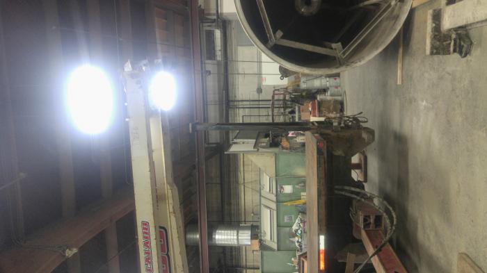

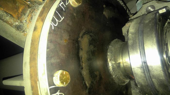

Thanks for the advice...but after talking with the plant manager and our engineer....we got a crane in to remove the steel mold, and will remove the drive shaft and mounting plate and send them out to get done by a outside company..crane operator weighed tank in at just over 10,000lbs..I trust my welding..but not putting the lieability out there..shaft is 6 inch dia. And plate is 1 inch thick by 16 inch dia.

There is nothing wrong with that weld. Its a base metal or stress distribution issue that will require some engineering input to make sure it doesn't happen again. Good choice to remove, but make sure the company has the appropriate brains to fix it.
Does that shaft go all the way through the plate it's welded to? If not then that's a sheer stress point and it will continue to fail. They need to make you a new shaft that long enough to go through the bolted plate. Then you could have the center machined out of the existing plate so that the new one could be inserted and welded from both sides. Obviously the weld on the back side would need to be grooved out so that the plate could be machined flat with out compromising the weld.
