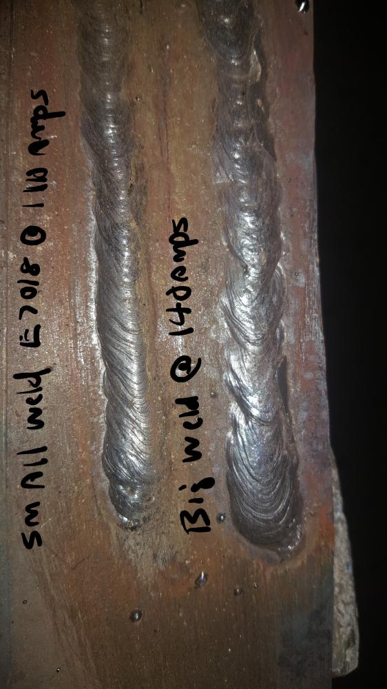

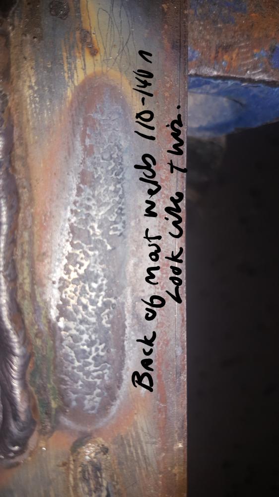

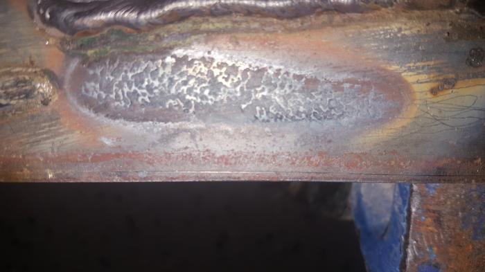

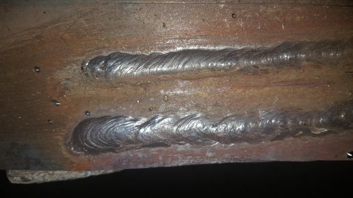

Thanks again for the advise here are so.e of my practice welds on flat piece of 3mm thick steel which is what Im usi g for all my frame repairs.Please let me know ab the quality of these welds and what can I do to improve them . Also I know they are not very straight but am tryi g to make straight beads. Of all these welds I should note that on the one small weld with 110amps its the only weld where I actually had slag peel like you see on videos of professional welders. All the other welds slag came off easily but in broken chunks.The larger welds I used zig zag technique and the smaller ones were just straight beads. Also the glowi g one was ab what most of the welds looked like immediately after is that normal or were they too hot.Sorry ab the orientation of pictures.Thanks Jim

Like I said I know these welds look pretty rough they're not consistent in size I'm not consistent in speed but I just want to know if you guys think structurally they'll be sound enough if I continue to weld like this on the car frame even though like I said earlier the welds I'm doing yes there to help stiffen up the frame by boxing it and I'm repairing some holes in the frame but by no means is anything I'm welding of any structural significance. Thanks ,Jim

Looking at some your welds with 7018, they look fine mostly. I see a notation that says "140 amps". What rod are you running 140 amps? 7018 1/8" rod (probably larger than I'd run on thin material) tops out at about 125 amps. For your project, I'd surely drop to 3/32, maybe 85-90 amps depending upon orientation and material thickness.

In my opinion, the entire car frame is structurally significant.Jim911 wrote:Like I said I know these welds look pretty rough they're not consistent in size I'm not consistent in speed but I just want to know if you guys think structurally they'll be sound enough if I continue to weld like this on the car frame even though like I said earlier the welds I'm doing yes there to help stiffen up the frame by boxing it and I'm repairing some holes in the frame but by no means is anything I'm welding of any structural significance. Thanks ,Jim
With your poor (inexperienced) welding ability you are very likely to do real damage to the frame that over time manifests itself as cracking.

For future reference in stick welding, never weld material thinner than the the rod. Doing so makes it much harder for you.
When the rod is thinner than the material, you have more control and are less likely to burn through in an uncontrolled manner.

I would respectfully disagree, I often run 7018 over 125 amps on thicker material - and they are rated for it.cj737 wrote:0.035 wire will be plenty big. The amount of wire a MIG machine puts out allows great control, and build-up as needed.

CJ737 Thanks the. 3/32 at ab 90 amps and not burning through the car frame so your advise worked.I m having trouble getting use to the fact the welds are much smaller but on the 1-2 mm thickness of the rear frame rail I think it will be ok. Should I run 2 or 3 beads on top of each other for strenght or should I do zig-zag or halfcircle pattern to increase width of weld material Im laying down or should I just run the one bead for each joint .Perhaps with welding less is more IDK..MinesotaDave Point well taken thats why Ive had my neighbor who welded for a living check on my progress . He told me 2 of the weld's I did iniitially were no good so I had to grind them off and start over . There was so much material sitting on top of weld took forever to grind it off. All the welds I did on flat stock were E7018 1/8 inch in the pictures I posted . One hurdle at a time after I finish boxing frame I want to try and fill in the swiss cheese like holes in the frame their isnt a lot but these rust holes range in size from ab 2mm to maybe 2 cm in diameter from rust and corosion. Is it possible to fill these in with stick welding ,I read you can put cooper behind hole and go low amps to fill in ,what rod though.I hate bondo would rather fill holes with metal if possible. Thanks for any advise. Jim
