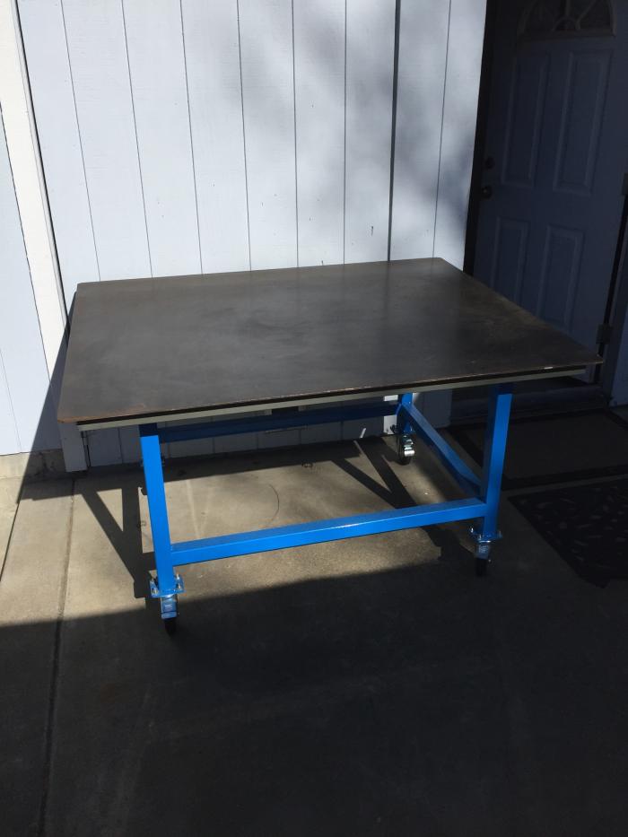

Good Morning,
I recently fabricated a roll around outdoor work table using a Tab and Slot brand leg and caster kit and buying a 4 X 5 foot sheet of 1/4" steel as a top. I welded 4 pieces of all thread onto the underside of the table so as to be able to bolt the top to the Tab and Slot leg kit. Of course since the top was quite thin I had to weld a support frame around the underside perimeter to remove the droop in both north/south and east/west directions. I want to store this table outside in the elements and wanted to ask if anybody has a good recommendation as to mitigating rust without compromising the grounding abilities for welding? Wad-40, etc?

How about posting a picture of your table?

Thanks for the reply to my post, have table off legs right now doing some modifications otherwise I would attach picture. Yes, there is a clear coat produced by Sculpt Nouveau called "Clear Guard" which is a protective lacquer for metal. I have an email into them to see if this will work without removing the tables grounding abilities away? I actually have some for a metal sign that I plasma cut and will be in the outdoors. I live in Northern California in the Sebastopol area of Sonoma County (wine country, but no snow). I also purchased a Tab and Slot "fab block" which I keep in my garage, of course no rust issues there.
I wanted to build an outside metal work table to work on many things not just to weld on as I am 60 and have had too many years of working on things sitting on the ground. Try to use my brain at this point and sometimes actually pay attention to body mechanics, right? I guess I could always tarp the table or build a sheet metal cover but a coating would be much more convenient. I will post a response when Sculpt Nouveau responds. Got their name through Zach at ZH Fabrication, a great fellow who gives me a lot of inspirations in all his metal/wood projects.

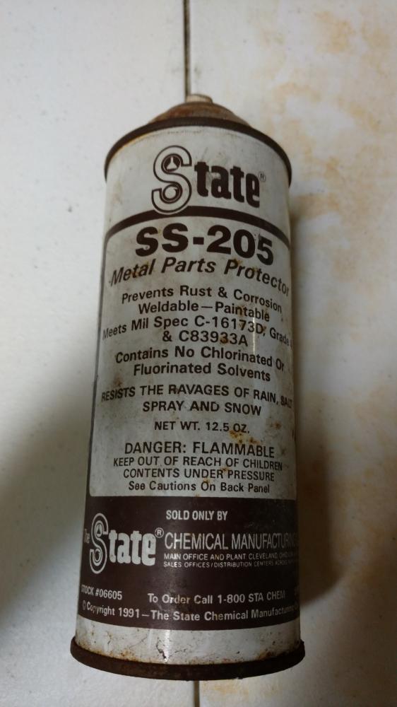

This stuff is simply badass. I'm down to my last two cans of the hoard and I'm not sure if I can get more of it. It was originally acquired through a now defunct oil tool company. I first tested it on a shiny, used brake rotor and left it outside in the pouring rain. Months later, I wiped it off with brake cleaner and it was back to shiny.

I looked up the mil-spec #'s and found this. Not sure how close these two products are.
http://www.cosmolinedirect.com/cosmolin ... reventive/

I don’t think you’d want to use the Cosmoline product you linked on a table you weld upon. It’s very thick, almost a goopy grease, hardens when it gets very hot, and would likely contaminate anything you weld from contact. It surely would protect the table surface, but may not be a good choice for regular use.MFleet wrote: Edit:

I hear ya . It's a tall order an honest attempt to meet the criteria for the original post:cj737 wrote:I don’t think you’d want to use the Cosmoline product you linked on a table you weld upon. It’s very thick, almost a goopy grease, hardens when it gets very hot, and would likely contaminate anything you weld from contact. It surely would protect the table surface, but may not be a good choice for regular use.MFleet wrote: Edit:

You're thinking of the stuff gets slathered on a new rifle at the factory. The stuff that I posted a picture of will dry to the touch (slight waxy feel)and claims that you can weld through it. The stuff in the link claims to dry to the touch as well. If you can weld through it, you can ground through it.
This is another product link that may be closer to what I have:
http://www.cosmolinedirect.com/cosmolin ... -veto-344/

That “waxy” finish is the problem. That’s the component that hardens under heat. For instance, if you fire a gun with cosmoline in the barrel (brand new, uncleaned) a few times, that residue will be hard as a 2-part epoxy after the heat cycles. Probably a great “storage/protection” choice, but not for a welding table.MFleet wrote:

Maybe so. The cans are old and will not spray well anymore. No way for me to properly test it out.cj737 wrote:That “waxy” finish is the problem. That’s the component that hardens under heat. For instance, if you fire a gun with cosmoline in the barrel (brand new, uncleaned) a few times, that residue will be hard as a 2-part epoxy after the heat cycles. Probably a great “storage/protection” choice, but not for a welding table.MFleet wrote:

I want to thank all for their inputs on protecting my outdoor welding/work table, much appreciated. I never heard back from Sculpt Nouveau as to my question as to using "Clear Coat" on my table but as one forum member pointed out, the product is designed to protect static metal objects from the environment i.e. non worked surfaces. I am going to clean the top of any rust and then apply CorrosionX Aviation lubricant as this should protect the surface relatively well and does not inhibit any grounding abilities. With an occasional reapplication I believe the table will survive. I guess it goes that any item that is outdoors requires occasional maintenance.
