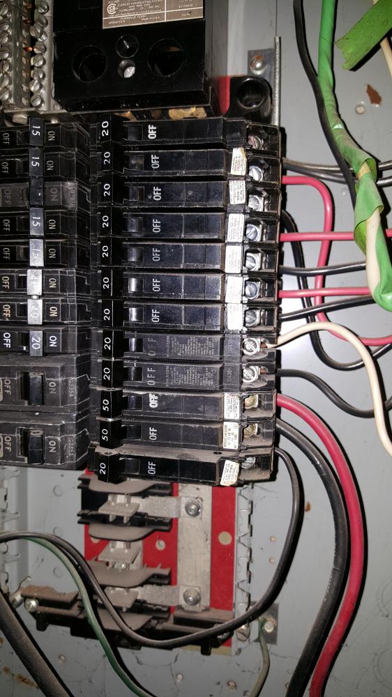

My son has down syndrome and few years back hurt himself and now cant walk. We looked into getting a medical grade track system but costs $40k and it costs allot to get other things for around the house to make things easier for him. So I figured I would try and make some of the things that are not too dangerous if they fail...example if I weld a small ramp and it breaks its not going to harm him.
So I was given some shop tools for either cheap or free only problem is they run on 220. The garage only setup to run basic 110. I was going to run a line from basement to garage but noticed I had a 'sub-box' think its called that outside near garage. I'm hoping this might work cause it seems it would save me allot of money.
The sub-box was used few years ago for a hot tub. We dont have it anymore but box is still there. When in basement, it looks like it runs to main box.
My question, can I use this sub-box to power everything in garage that needs 220? Would I change everything in sub box or leave it alone? Would I need to change anything on the 'main box' in the basement? As for the sub-box, do I 'need' to run the wire from the sub box underground to garage or can I just pipe it and drill hole into garage?
As for how many things will need the 220...I have 60gal Compressor, everlast 210EXT welder, Lotos Plasma cutter and thats really it. its not a fab shop...only me doing the work so will not be using all machines running at same time. I can see myself going from one to another but never 2 at same time. Not sure if this info helps but trying to give as much info you might need to help.

I'll give you some "basic" information, but you really need to have a Certified Electrician come out and counsel you. And probably do the work.
220v is available by running service from both sides of the service. If you look at an electric panel below the face shield, you will see 2 service lines running down. Your standard 120v service is run through a single "leg", and more often than not, you only use a single wide breaker (fuse). Look for instance at your Main service panel for the house. See the breaker for your stove/oven or Dryer? It uses a 2-wide breaker, and, it has service legs from both sides. Thats 240v/220v.
So your question about "will my sub panel" feed my garage is Yes, and No. Its not whether 220v is available, its whether there is sufficient available Amperage available. All the shop tools you described probably use 30-60 Amp breakers. If your sub panel is rated for 50-100 amps only, then legging to the garage will consume more amps than the sub panel and Main panel may have available. Make any sense?
Plus, to run power underground from panel-to-panel, you need either UL rated lines or conduit buried. Find a buddy who is a certified electrician to come help or do in trade so that you're COMPLETELY safe. Your boy needs his Dad more than you need a visit to the ER

I have a 100A panel in the house with a 60A sub panel in the shop, house 40+ years and shop 30+years, fuses even, all installed by a certified electrician. They run everything without a glitch. Mind you we are energy conscious with T-8's, Led lighting and 6 kids long gone with the 1/2 hr showers etc. As a retired hobbyest all that would run at once is a 2hp compressor,lighting, a vent fan and the tool I'am using at the time. Lincoln 180 max 20A, 250 mig inverter max 24A which I'll never max out with .035 wire. They both have a 50A plug which I suspect is industry standard up to a certain size? How and what you are going to operate governs what your needs are. As others suggested a meeting with a certified electricion is a necessary first step.
It's a bit hard to say for sure from the photos, but if that third pic you posted is the sub-panel it looks like you have two 220V circuits and a single 120V circuit in there. The remarks in the other replies about having enough available current apply of course, and what you can run will depend on what your machines draw. If none of them are more than the maximum available and you only run one at a time, it still works fine. One place I worked had 3 welders on one 50A line. We never used more than one at a time, so no problem.
You really do need a local electrician to take a look. They can assess things and give you much better advice than we can from a distance. You don't say where you are located, but maybe there is a local forum member that would be willing to take a look and at least offer some advice. I've had guys on other forums do as much for me.

First I want to thnk everyone for taking the time to share their advice. I'm also sorry for taking so long to reply, And hope you dont take my late reply as a lack of respect. As I explained before my son has down syndrome and often gets sick. Most times we can handle it but when we notice it getting worse we bring him to the hospital to make sure. Then a day after getting home, we found out we have termites (Joy...joy). So I went from excited to start garage to figuring out how to solve termite issue. We are going to try and go the DIY route first cause money is little tight.
Anyhow I have since changed plan alittle and hope someone can take a look and recommend if it sounds good and what items I would need to get.
NEW PLAN:
I dont want to use the sub panel outside (OLD PLAN). Unless someone here says different, I think it might be best to disconnect the old breakers going to outside sub-panel. And disconnect the wires from main box going to old sub-panel. Tape the wires up and not use them.
Then add NEW breaker to main box and just run a NEW line off the main box to NEW sub-panel in garage. If this sounds like a better idea, I would need help with the following...please:
Size of breakers for main box, (How many pole) to feed everything in Sub-panel
Size wire from box to sub-panel
Size of sub-panel...(would 100amp 12 circuit 6 space, work)
then...
Size of breakers for sub-panel, (How many pole)
Size wire from sub-panel to each outlet
Size Outlet
I'm thinking it will be easier (unless you guys think differently) to run the wire from the sub-panel to outlets, on the outside of the sheetrock. Might not look great but with the garage already full with things might be truly difficult to start drilling thru all the beams...again unless you guys think its better to hide the wire.

- The 2 bottom 50amp breakers goto (OLD) Sub-Panel
- 20180206_130539.jpg (109.05 KiB) Viewed 5616 times
- 20180206_130412.jpg (122.27 KiB) Viewed 5616 times

I don't think you can get romex for 100A run, or if you can it will be really expensive and might require you to buy a large roll. So you can either go with 80A and use romex, or run counduit for 100A. You probably need #3 wire so conduit would be 1", so you'll need an electrician who has tools to bend it for you. I didn't see how far the run is, so it's not for sure what size wire you need.
If you surface mount the subpanel it will be a lot easier to mount a 50A welding receptacle next to it. You can just put a short stub of 3/4" conduit and get a few short lengths of #8 or #6 wire instead of having to buy a whole roll of romex.
Your other option, which would probably be cheaper, would be to use the existing 50A run out to the hot tub subpanel to power a 50A receptacle for the welder. Assuming they used the right sized wire. That would allow you to buy a 50A receptacle to replace the existing subpanel out there. That would then allow you to install a smaller subpanel for your compressor and future receptacles using a 50 or 60A breaker in the service panel, which would make the romex cheaper and more easily available.
