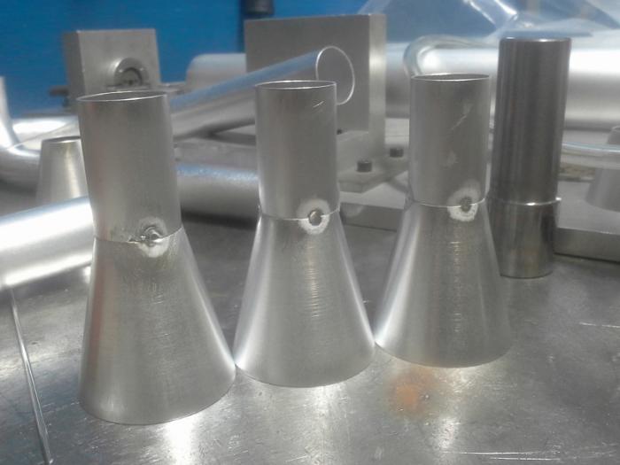

Some of the test beads on the 0.025” sheet metal:
After the parts had cooled down, I cleaned them, turned them around and positioned them for welding:
How would you go about welding these two parts together? Do I need to change something in my equipment / process?

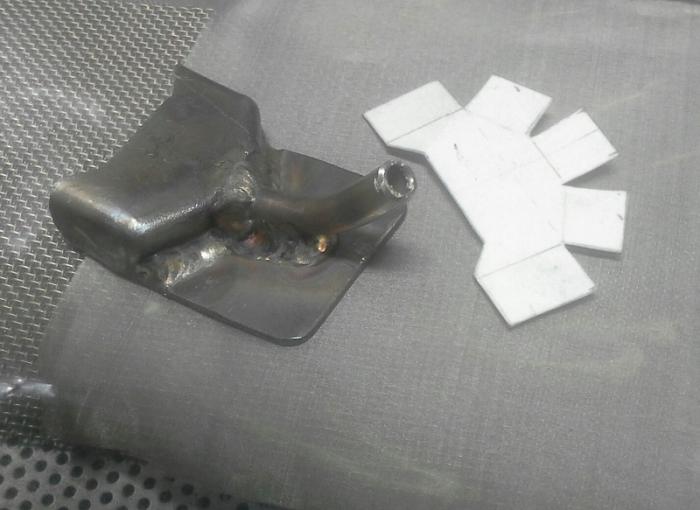

The other topic is, that want to add two more fittings to the fuel tank, which is also only made of 0.025” 6061-T6 aluminum.

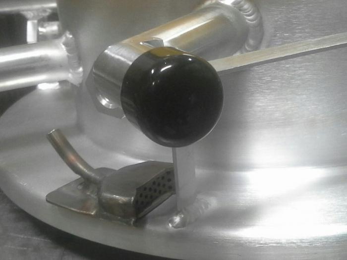

This is what the factory installed fitting looks like:
This is the type of fitting I want to install:
A friend suggested that I should heat the fitting up with a torch and then start to weld at the tip of the red arrow, letting the filler run down to the sheet metal. What are your thought on this?

Finally, note the fine weld in the edge of the tank. It goes along the edge of the tank’s side wall and the bottom. How would you go about making such a weld?

The only picture I'm seeing is of the fitting. An image of the specific joint you're welding would be helpful.

Here is some .025" I've welded. All of it purged
I wouldn't use lacquer thinner, I'd use acetone. Search 'acetone vs lacquer thinner'.
If that welder doesn't go down to somewhere around 5 amps on AC you'll have a really hard time welding something that thin.
I would also purge it.

Oliver,
The only picture I can see is the last one.
