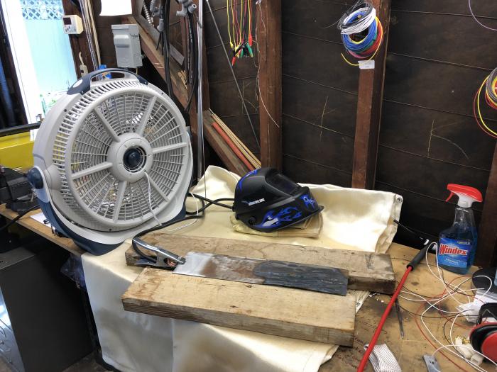

I don't have a welding table yet so this was my work area.
That's a HF welding blanket protecting the wooden table in case I blew hot metal through the plate. I thought it would be good to get some air flow under the work piece rather than flat on the blanket. Haha I charred the wood a few times with the beads closest to the edge. Smelled like welding and fire pit. Admittedly it was a pretty janky set up, but there is a fire extinguisher present off camera.

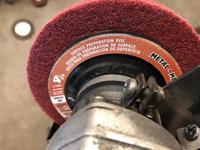

Metal prep was with a Makita 4 1/2" angel grinder, a flap wheel and this guy

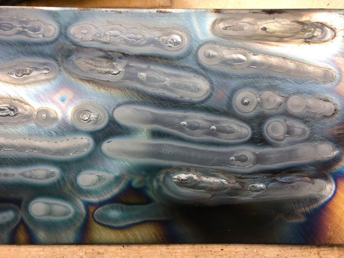

My first attempt at TIG welding started like this:
then #2
then #3 - First half of the weld
then #4 - 2nd half where I stared to put full pedal into it.
then #5
So I was getting some penetration and I hadn't dunked my tungsten in the puddle yet, so I decided to try some filler rod...
Oops. I realized I was using 4043 and forgotten to even buy steel filler rod. SO I went back to fusion welds.
This was my last one

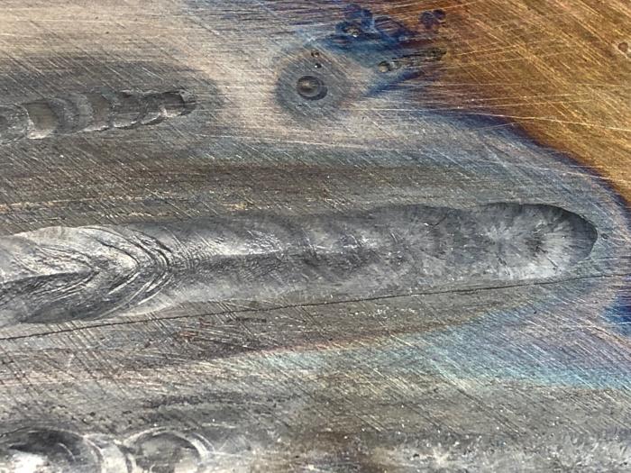

Here's the back side of the plate. For positioning sake, my first "weld" is in the lower right corner (which you can't see from the back)

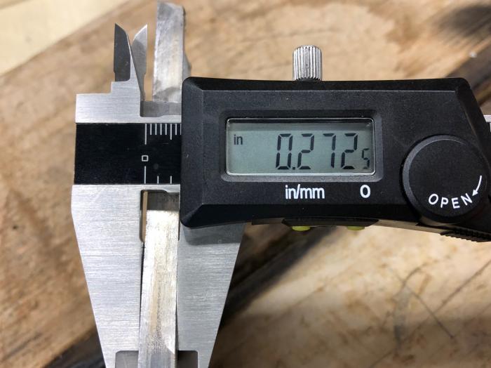

the plate was this thick

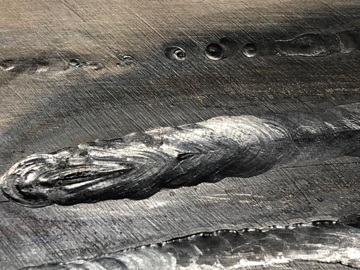

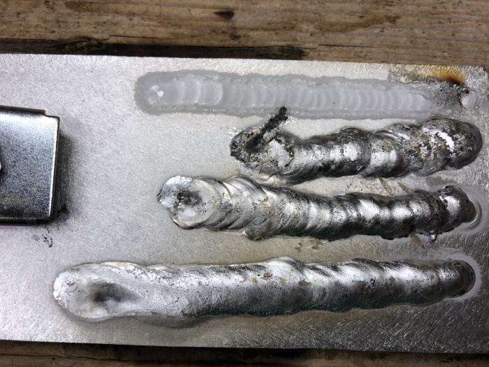

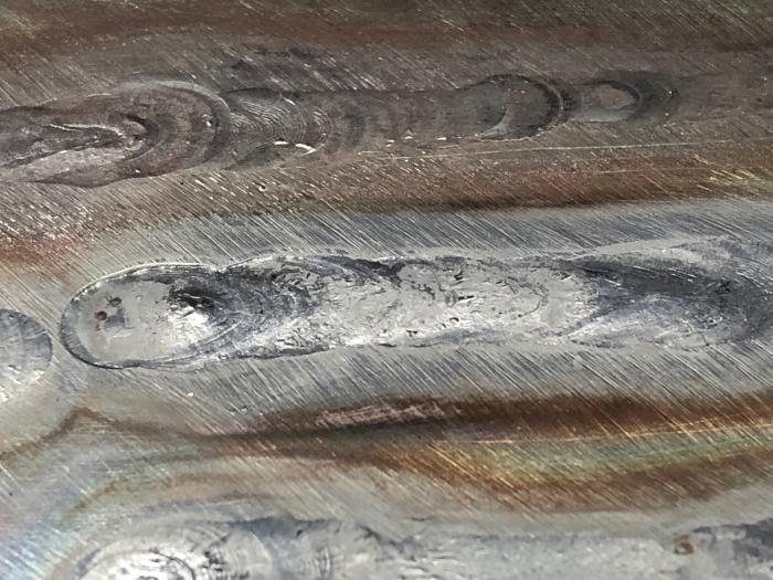

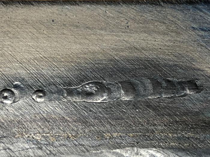

My first aluminum welds 1-3, from top to bottom. The first one was without filler rod, and I totally forget to clean the surface this side
I was using 1/8' 4043 since that's all the LWS had in stock. It was really hard for me to get the rhythm of it.

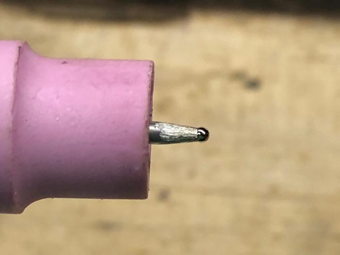

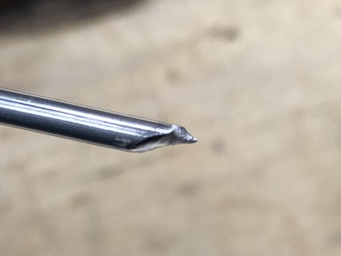

I managed to ball up the end of my tungsten at one point.

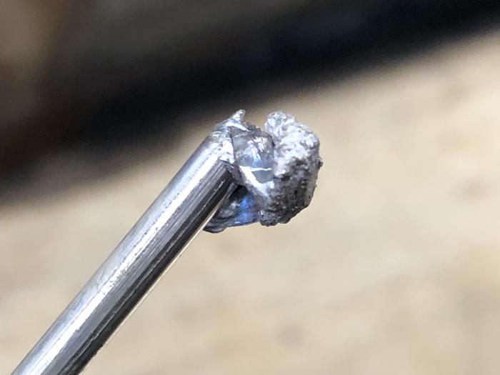

And my filler rod was collecting clumps on occasion
I left the plate cool, flipped it over, ran some beads on the back side and then gave it a good brushing,

Here's the tungsten's condition after my final bead
and filler rod

Move the fan farther away. The negative air flow will pull your shielding gas away.
Your tungsten tip for DC does not want to be blunted; that’s a tip for AC. That grinding wheel is too coarse also. You should not have those grind marks visible. Get a diamond wheel or at least a silicon carbide wheel and ditch the alum/oxide until you need to sharpen a mower blade.
The aluminum welds won’t weld with using material and 135 amps. You need about 250-300 amps to weld aluminum that thick. Your initial ally welds show insufficient heat to break the oxide layer and that’s why your filler is clumped up too. Get some 1/8” sheet and some 3/32” filler for practicing,

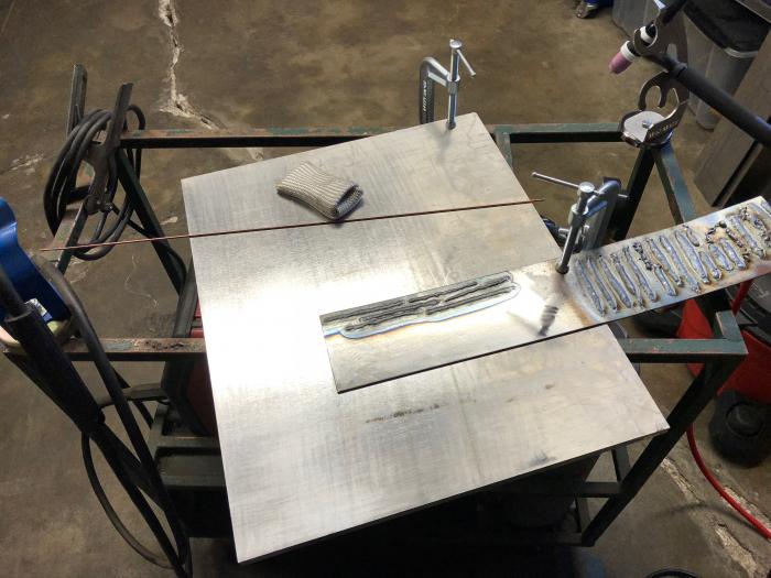

If you can, get a 1/4-3/8” sheet of ally to lay down to weld against. It will be slightly pricey, but it will make a terrific surface for your shop. You can often find a MetalSupermarket branch near you, and they will cut you exactly the size you need in any material.

Ok, I'll double check the fan distance and draw. It was set on low and I felt that it wasn't pulling any harder than a fume extractor I've seen in a few videos, but the input is noted and I'll be mindful of that.cj737 wrote:Move the fan farther away. The negative air flow will pull your shielding gas away.

Got it, I'll source a different grinding wheel.

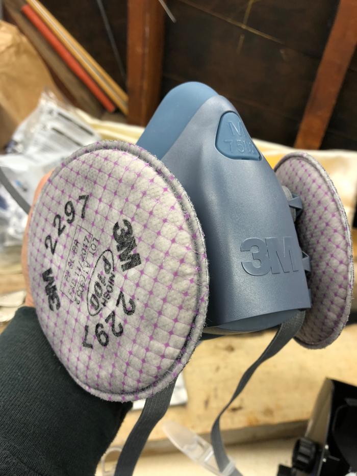

This hobby has shown me that I'm in need of some reading glasses. So I found this .75 magnifier and installed it in my helmet.
And while having pretty decent ventilation in my garage I wanted to cover my bases with toxic fume exposure.

After reading a few forum post suggestions, I made a quick trip to HF and bought a cheap saw blade sharpener that has a diamond wheel (replacement wheels are only $10). I removed the guards and was able to get a nice point on my tungsten. I may have to play with the grind angle a bit to get the grind marks to run in parallel with the tungsten itself, though i'm not sure how critical that is?
I went down to M&K metals in LA and bought a bunch of remnants in alum, carbon steel and stainless. I got a big chuck for a welding surface.
This was my final work surface setup. It's crude but worked for the moment.

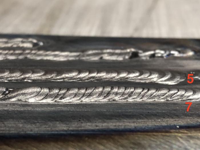

Here are my attempts. I quenched the metal every two to three welds. Since this was a few weeks ago, I can't remember what settings I was using, I'll write them down next time.
#5 seemed to be the best of the bunch. #7 started out well and then got funky after I stopped and started again. Maybe too much heat? At times I felt like I was getting in to a groove and then the wires in my brain would cross and I'd lose the rhythm.
I noted a repeating V-shape in the top of a few welds. Not sure what I was doing wrong to cause that.

That's interesting, I'll take another look at the back of the plate to see if there's a visible correlationPoland308 wrote:I think the v shape is due too shrinkage from the weld having deeper penetration at that point.

You do not want grind marks on your tungsten. And if you have them, they want to be inline with the tungsten, not at an angle. It may not make a lot of difference as you learn the basics, but it will haunt you when it matters.
A helpful thing to do as you learn to add filler, scribe 2 parallel lines on your practice metal about 1/8" wide. Establish your puddle until it reaches the lines, fill and melt that it until it reaches the lines, advance, and repeat. Use the lines to help train you for how filler to add, how long to wait until the "toes" of the weld wet in, and then move along.
Most of your beads show as slightly cool, some are too much filler. Some are combos of both. 3/32 filler will flatten out nicely within an 1/8" for stringer beads so focus on that dimension. Overall, things look really good for a self taught beginner! Those heat scars on the aluminum are from mill scale on the back getting hot enough to char the ally. A bit of scotchbrite and acetone and it will wipe right off.
I've always wondered about controlling grind marks. I've been putting the tungsten in a drill and then running it while putting it against the diamond wheel. Would I be correct in thinking that I want minimal RPMs of the drill in relation to the grinding wheel RPM? I've been giving it full trigger and possibly rotating faster than the diamond wheel itself. I think that's why I'm getting spiral grind marks? I'll try rotating by hand and see if that changes the direction of the grind. I could also glue a sheet of 2000 grit to the side of the wheel and do a clean up pass on the tipcj737 wrote:You do not want grind marks on your tungsten. And if you have them, they want to be inline with the tungsten, not at an angle. It may not make a lot of difference as you learn the basics, but it will haunt you when it matters.
The 1/8" puddle exercise sounds good, I'll give that a shot!
I definitely felt the welding was a smoother process but i'm not sure if was because I was finally using proper prep (brush and acetone), a better finish on the tungsten (diamond wheel vs axe sharper), or the use pf a gas lens. Lot's of changed variables, but I felt like my starts were cleaner with less arc scatter,
I suppose it depends on the gauge of metal you're welding... but how much penetration should I be seeing on the backside?
This is a pic from my first attempts a few posts back. In the photo, should I be trying to avoid the oval and aim for the rectangle?
- IMG_0501.jpg (61.13 KiB) Viewed 5009 times
Chocking the tungsten in a drill works well, spin it slowly, and directly inline with the tungsten and you’ll get a super smooth and clean tip. I also use a red scotchbrite afterwards and polish the length and tip when I work with stainless and ally.
As for penetration, it all depends. Thinner material will show quickly, especially while practicing. Thicker stuff, well, good luck with that
The sample you circled shows very consistent heat input, so I’d strive for that over “more or less” penetration.
Location:Orlando FL
Yes, the "boxed" red one.LtBadd wrote:CJ, did you mean to say the sample in the rectangle? That one looks more consistent to mecj737 wrote: The sample you circled shows very consistent heat input, so I’d strive for that over “more or less” penetration.
Ah ok, I'll try the red scotchbrite as a finish pass.cj737 wrote:Chocking the tungsten in a drill works well, spin it slowly, and directly inline with the tungsten and you’ll get a super smooth and clean tip. I also use a red scotchbrite afterwards and polish the length and tip when I work with stainless and ally.
As for penetration, it all depends. Thinner material will show quickly, especially while practicing. Thicker stuff, well, good luck with thatThe sample you circled shows very consistent heat input, so I’d strive for that over “more or less” penetration.
Yep, heat consistency makes total sense at this point (boxed example).
Thanks for the feedback!
Wondering what sort of issue I have going on here.
During arc start, I'm intermittently getting a ton of arc scatter, like a an electrical storm with lightening strikes. It chews up the starting area with porosity.
Once the arc has stabilized I get a sound buzzing sound that cuts in and out (louder than the normal bacon sizzle sound).
Here's the best I could do for a video of it:
https://youtu.be/Sbrw5rukIUk
Welding on thin alum (.003), throughly prepped with dedicated stainless brush and acetone.
Machine is APH 200x
#17 torch with #5 cup. No gas lens.
3/32 2% Thoriated tungsten
15 cfh
Using pedal, 2T, No pulse
Set on AC at 33A
Approx 90-100 AC Freq
45% AC Balance
5s Post Flow
Grinding tungsten with diamond wheel, and slightly blunting tip
Despite me bobbing the tungsten up a down a bit as I travel (I'm working on it..), I feel like I'm holding a decent distance from tungsten-to-surface. The buzzing noise doesn't seem to 100% correlate with arc length.
I'm not using filler at the moment, and the weld lines are bright and shiny, so I think I'm getting good cleaning action.
Sometimes I'm also getting a bright yellow arc that pulses on it's own (no pulse set on box). I had assumed the tungsten had somehow gotten contaminated (I didn't dip into pool) so I'd regrind the tungsten but it would happen again.
That said, I did dip at the end of the video.
I need a better video recording set up and hand holding everything while I try to weld.
Any ideas on what the problems could be?
Machine is APH 200x
15 cfh
Set on AC at 33A
45% AC Balance
5s Post Flow
Material that thin will be extremely difficult to weld on aC. Your arc needs a good deal of amps to start, maybe your box isn’t a more “quality” unit so you’ll need to use a truck: set a ore flow of gas for about 2 seconds, then start the arc. The argon helps evacuate atmosphere and stabilize the arc at lower amps. You also need to check the ground clamp. If your material is laid on a steel table but that thin, your welding arc maybe “ground hunting”. Any way to clamp closer to the material you’re welding in lay that on some other ally and clamp there?
Too long an arc will cause an intermittent arc too
Haha, yeah I'm still trying to walk and chew gum when I comes to arc length and torch travel.cj737 wrote:Material that thin will be extremely difficult to weld on aC. Your arc needs a good deal of amps to start, maybe your box isn’t a more “quality” unit so you’ll need to use a truck: set a ore flow of gas for about 2 seconds, then start the arc. The argon helps evacuate atmosphere and stabilize the arc at lower amps. You also need to check the ground clamp. If your material is laid on a steel table but that thin, your welding arc maybe “ground hunting”. Any way to clamp closer to the material you’re welding in lay that on some other ally and clamp there?
The welding surface is a big 3/4" plate of aluminum, and I'm using the grounding clamp to hold the work piece to the plate.
Unfortunately I don't have pre-flow control on the box.
I had thought about starting amp being a part of the issue. Do Start Amps and End Amps work on the 2T setting, or is that just 4T?
Would moving to a smaller diameter tungsten help any of this?
