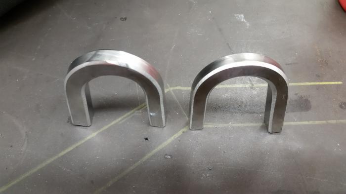

Well, I passed! Thought for sure I'd have a couple defects once the coupon was cut apart, but nope. Good penetration into the base metal, no voids/crack/holes to be seen. Bend test went just fine with no issues whatsoever. Relieved to have that done and over with.
Being a glutton for punishment, I'm going to make up some parts and try to get this done with stick next week.

Thanks. I was worried it would be Swiss cheese as I was cutting it apart. I relaxed quite a bit once I got everything cleaned up and couldn't see any issues.tungstendipper wrote:Good Job!
Once the first piece bent ok, I was pretty confident the other one would be ok.
