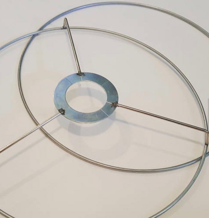

I am currently looking to butt weld or butt braze 10 gauge wire into lamp shade frames. I am not pleased with the outcome of the finished product I am currently brazing. I have purchased some frames from a company that supplies frames but they do not make the size I need.
QUESTIONs. Is brazing the best way to accomplish this task?
Can I get better results with a stick welder? (like something I can buy at Lowes or Grizzly?
If I can figure out how to post a photo here I can show you a pic of the current frame I have. It may of been done with a big spot welder?
It will be a production setting. The more I can make in a day the better. I do not have the funds to buy big equipment. :geek:
ATTACHED IS A PHOTO OF THE WELD I WOULD LIKE TO MAKE
How was this made?
How was this made?

Hi there, that weld is done by a resistance method called flash butt welding. The parts are gripped in a machine and energized, then pushed together. As the current flows and it melts the metal they are forced together more which joins them. The current is automatically shut of after a pre determined time. Similar to spot welding in sheet metal.

Thank you Weldin Mike. Do you think I could do this with a stick welder? (not like the one pictured)

Definitely a little more process and equipment than a homeowner is going to have.
http://www.esab.com/automation/en/produ ... ipment.cfm
#10 steel wire and limited production you may well be better off employing a thin sleeve and soldering. Uninsulated wire splicing sleeves from China should run less than 2¢ on ebay.
Sleeving would be my first choice of a production method unless you're doing quantities above 1000 a day.

Any chance you have a mig with a spot timer available you could make a simple jig of needle nose vice grips or similar and set a mig to spot would be fairly similar and you wouldn't have as much warpage as I suspect that gas welding may cause just a thought

Not likely. A quick tack with a MIG would be fast and reliable. You can also use 0.024 wire. You could solder, braze, or TIG fuse it, but those all require a bit longer in terms of time.

You will find, as you get further into welding, that you can weld most things with a stick welder if required. It will not look like the weld you pictured but it will be fine. The trick is, small rod, low amps, a jig to hold your wire still, with a small gap. A new rod, go in nice and steady with a pool que type action, holding the rod nice and still. Quick jab in, and out. It'll take some practice, but you'll get there. You'll be able to fuse the ends with out putting a big lump on it.

I'd love to take a stab at that job with a bandsaw blade welder power supply and a jig. I have a hunch it would work.

Thank you. Not a bad alternative but I will need to make " T Joints " and I do not see this as an option. Thank you for a good thought.

Do you guys think this was done with a MIG welder? I'm guessing this would be the type of weld...but I'm just guessing.

Depending on how thick that center flat washer is you might want to consider a small tig welder. Going to hard wire mig or tig will require getting a gas bottle (different gas’s depending on process) but a tig machine with a low starting amps will give you more precision and less cleanup. It won’t be as fast but the results will definitely be better.

My wire chart says #9 steel wire is 0.148" roughly in the middle of 1/8 and 5/32.
The rim to spoke welds look like they were spot welded, possibly doable with a stick machine + a contactor.
The hub looks maximum 1/16 from what I can see in the picture.
How it was stuck together? Could be somebody tried MIG without gas and a quick trigger finger. I don't think it's stick done on a chill block.
Another possible is it was done using the spoke as an electrode in a stinger to grab a short duration arc and then immediately clamping it between 2 blocks.
Single carbon arc acting like a heliarc torch is a possibility too.
Washer looks like it might be plated which could account for some of the black. Really need to know the thickness of the washer and any coating or plating on both washer and wire to try experimenting with the job.
