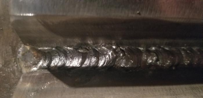

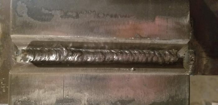

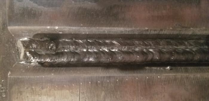

Hello Everyone. I have been practicing in my garage for a 3G test I am taking on May 5th. I have no one to teach me except the internet, so here I am. I have pictures below of the 4 passes I have put into the piece. I ran into a problem which I think was "Arc Blowback" near the top of the plate on one of the passes. It left a nodule on the plate as if the rod melted in place. Besides that fault, I wanted to get some opinions on my work and see if this looks like something that could pass so far.
Pictures are horizontal for some reason. I can't figure out how to fix that in the forum.
Root Pass (photo 1)
Root Pass (photo 1)
Root Pass (Photo 2)
Root Pass (Photo 2)
Root Pass (Photo 3)
Root Pass (Photo 3)

1. No arc strikes outside of the weld zone! Strike just above where you are about to weld, then drop down and start the bead.
2. Place the arc and deposit the metal a little higher into the sides to get a smoother bead. You're leaving a steep trough at the sides which makes slag inclusion very likely.
3. Fill the plate to the top on every pass. Keep running the bead up the backer bar and maybe give it a few swirls on top just to be sure.
4. Not likely arc blow, just looks like a hot blob fell out.
5. Root Pass, photo 3- Looks like a couple of big gobs of spatter on a re-start. Work on your arc striking/re-starts. Those gobs leave space for inclusion/voids.
Good luck, and be patient. Over all its not bad. Nothing a little work can't straighten out.

1. Should I clean all the slag and brush before restarts? I also realized I was having a hard time arc striking because I had a bad ground. I then moved it closer to the piece and it went much better. This is after what I thought was arc blow.
2. The test says "stringers only". How do I flatten out a stronger? I cant yo side to side too much or it's a weave right? I almost think my 2nd pass was too much like a weave.

On Q #1- Some people just tap the slag out of the eye of the weld to protect the rest of it from spatter. I just clean it all off because it has never really been an issue. Personal choice, your mileage may vary either way. As long as its clean before your next pass.
Q2- You can flatten them out by using a little more current or by manipulating the electrode a little (tiny side to side, almost like wagging the tail of the electrode). What constitutes a stringer or weave is always debatable, and I just don't have much of an opinion on it. I run them a little wider than the electrode diameter. Thats just my own personal "never fail" technique.
More important is arc and deposition placement. Usually referred to as "sticking the sides", you want to put the arc and metal about half the diameter up into the beveled side of the plate to avoid making that pocket that can create void or inclusion.
