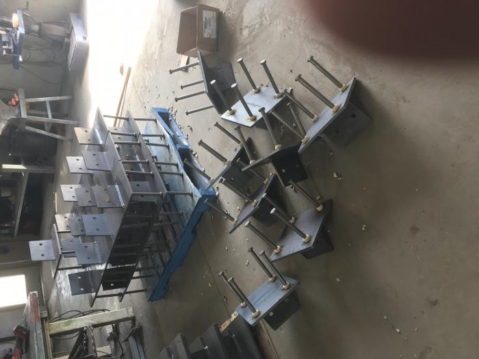

Picked up my plates today. If any of you wanna come up to Canada for vacation and weld for a couple days you’re sure welcome!!
230 T joints and 250 plates welded to 5 inch channel.

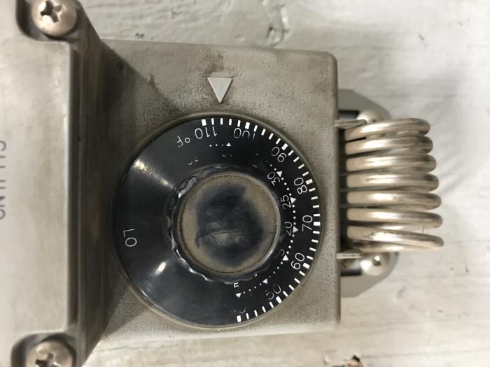

I'll need a Niagara recliner with heat & vibration and the coffee pot must be within easy reach.
What's the temperature in the shop? In Farenheight!

I already set the heater for you :D
Besides. With this balmy forecast this week I was planning more along the lines of beer fridge than coffee pot...

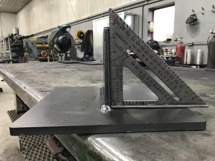

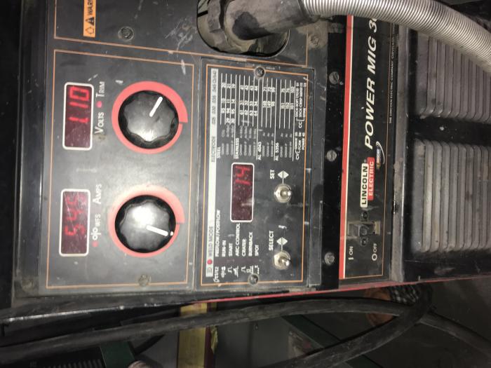

So,welding up these plates I’m playing around with the welder settings. I’ve tried pulse mig a couple times before but it seems to work decent on this. Cranked up, it seems to put down a really hot bead, I mean my gun and is smoking after each pass.
In Pulse mig mode (14) the voltage readout changes to “Trim” and defaults to 1.00. I’m playing around with that and it seems to do the same thing as changing voltage would in regular GMAW. Anyone have experience with this? Is this even what pulse is designed for? Or is it more for thinner stuff, like pulse TIG is.
Thanks for any advice

Looking nice. What gas you running that the gun is getting that hot?
If you had to cook them on a production basis you'd probably want to go to a water cooled gun.
At least you're running that job at the right time of year when adding heat to the building is a benefit.
I suggest you spend a bit of time reading Ed Craig on welding steel with pulsed -v- nonpulsed. Ed has some very good information you can get for free.

75/25 mix gas. .035 solid wire I haven’t decided if I’ll try flux core yet I’ll play around with this for a while. I looks like spray arc almost. I’ve never done spray so I have no idea what it really looks like but it’s definitely not short circuit. The wire disappears before it hits the puddle, and if I turn the “Trim” up to 1.25 just to try, the wire never even makes it out of the gas cap/end of the gun/ gas cup whatever it’s called I can’t even think of the name. It’s like trying to weld with a pressure washer I can point the gun into the root, and drag it straight back the “pressure washer effect” fans out the bead to a half to 3/4 inch wide bead with no gun manipulation whatsoever. I’ve never tried these settings before it’s pretty darn interesting.
Where can I get that information?

That would be Ed. He has a considerable accumulation of knowledge when it comes to MIG, I don't know if his commentary is still up regarding the gas industry and all their supermixes. Ed spent a few years in the gas side of MIG, and there too knows of what he speaks.
You can't get into spray with more than 20% Co2, but you can get into some damn hot globular.
Personally I'd run that job with straight Co2 for both max penetration and max gun cooling.

Yeah he had some cartoons about gas companies and their “wonder gas”.
I could get a small tank of CO2 I guess but this seems to work pretty good. Not sure if it’ll be worth my time and money to run 45 mins to town for a tank of gas just for this one project. Tho I do need some more tips anyways :/
I’ve got the little welder maxed out for the first time ever. 700 IPM with the 0.035. Still haven’t kicked the over temp yet tho
Hmm. Hotwire the foot pedal from the square wave onto it...aluminum pipe instead of brookstick... might be just crazy enough to work!

As you may have noticed, Ed has a very accurate opinion of Engineers. I agree with his assessment most days.
Scrap the aluminum pipe idea unless you'll be running cooling water through it. Hunt up a wood snow shovel handle, comfortable to use ergonamic and all that crap.
You do stack very neatly. If the welding goes to hell you should find employment in the shipping and distribution industry easily.
Go grab 20# of Co2, you'll save a lot of money on the job. If you get lucky you'll be rewarded by getting the fun job of running the press to straighten all those T brackets. Who knows, you may even get a promotion.

I’m insulted that you think they’ll need straightening!and to think I even invited you here to help, bought that recliner you wanted and everything! :evil:
Snow shovel? What’s that??? :D me thinks that would be charcoal after and hour or so.
Stacking them is easy now. We’ll see how they stack with 6 inch studs on the bottom.
And no. I did NOT take this piece to the press before I snapped a pic

You'll be needing a Packaging Engineer to generate an Autocad plan to stack them things when the studs get stuck on.
Maybe an old tater bin with sides might save you. Or just turn them 90° and go with thick cardboard between layers.

I was considering the tater bin, but I have to ship them to get galvanized.
