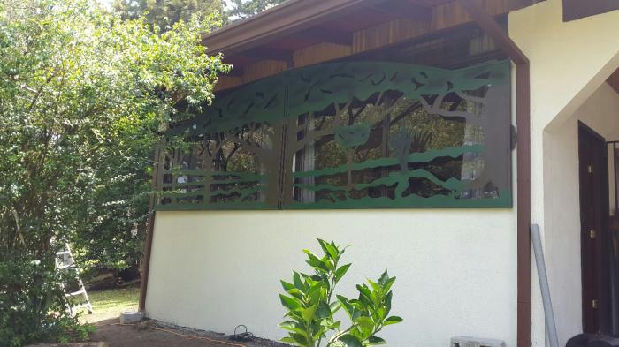

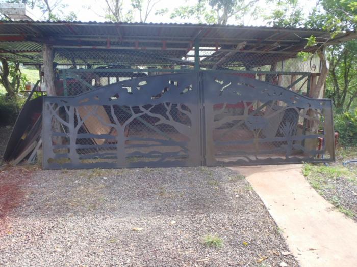

Heres a "mold"
molded
molded
Antorcha
    Fri Dec 06, 2013 8:57 am
    By da lake
1/4 ply....drag tip[ around it
Antorcha
    By da lake
Final product. No fancy table needed (then)
Very nice!
